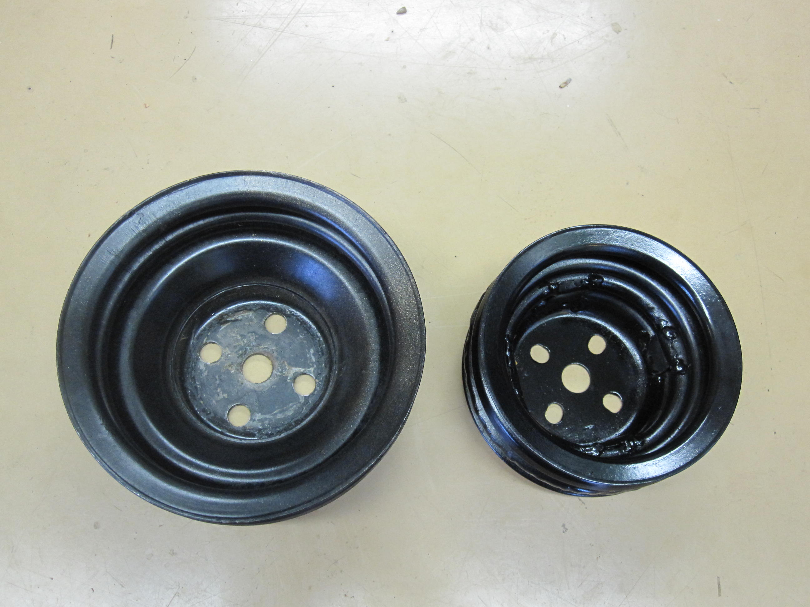

Ken, I am wondering about the diameter of your water pump pulley. The pulley I was running was 6-3/8" and because I was running hot at lower speeds I changed to a 5" diameter pulley and now I am running at thermostat control temp--160 with a/c on, but it hasn't gotten to 95+ outside here yet?
All the difference in the world with 28% increase in water flow. I think the stock flow rate was based on a 5" pulley and wonder if someone has a stock WP pulley much larger than that.
Hopefully I am on the tail end of post subject comments; But hadn't seen a front photo of your engine. Nevertheless, a cooler engine compartment will definitely help with vapor lock.
What I was running on left, and 5" on right>>0 -
