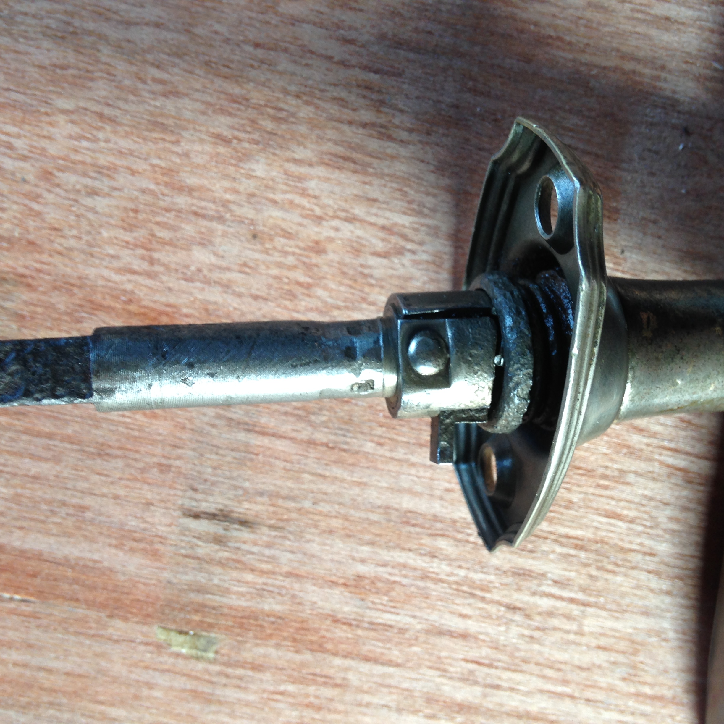

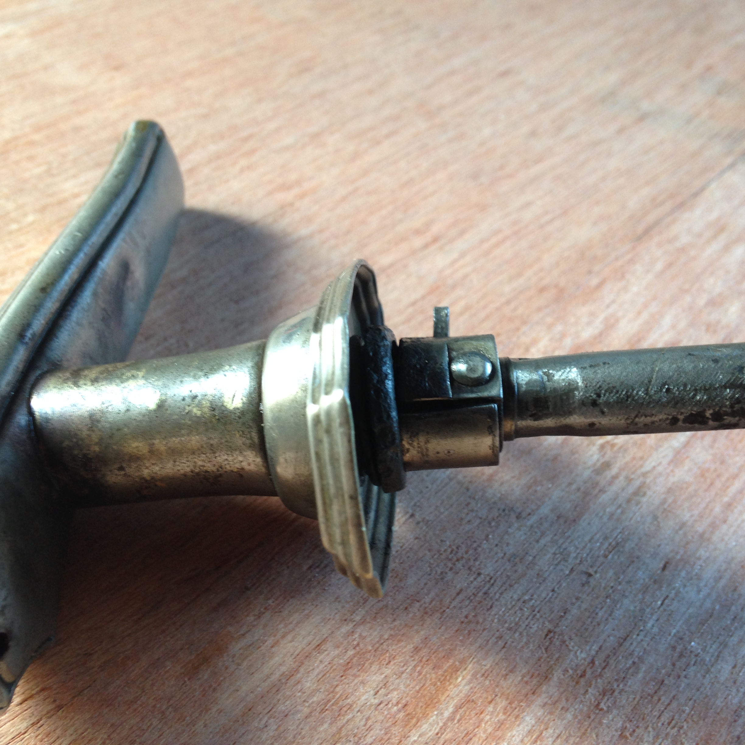

I recently purchased a locking door handle of the correct pattern for my 1928 Essex.
The cylinder seems to be seized in the handle, IE the cylinder lock will not turn despite a good soaking for several weeks in penetration oil.
My locksmith has told me he can cut a key but the cylinder must turn.
Does anyone have any experience of how to strip these handles down, the none locking ones are easy however with the locking handle the spring retainer
will not pass over the locking mechanism?

The inside of the cylinder lock seems to be free, if you insert a small screw driver the spring "blocks" which allow a key to be inserted move freely, it's the barrel itself that does not turn in either direction within the handle.I am sure the outer pressed cover of the handle can be removed by levering it open down the swage line around its perimeter, however I was hoping to avoid that as the locking handle appears to be more difficult to open than the non locking type which I have done.0
The barrel is made from the dreaded 'die cast' which swells!!
I took the handle apart today.As soon as I took off the outer pressed Nickle handle cover it became apparent the Dave Y was correct.The Die Cast was swollen and had split in two which meant having to drill it out.Does anyone know if cylinder locks of the correct type can be obtained, or is it the case of waiting for one to come up on ebay or forget this handle altogether and keep for spares?There seems to be a number stamped on the cylinder HM263?0
