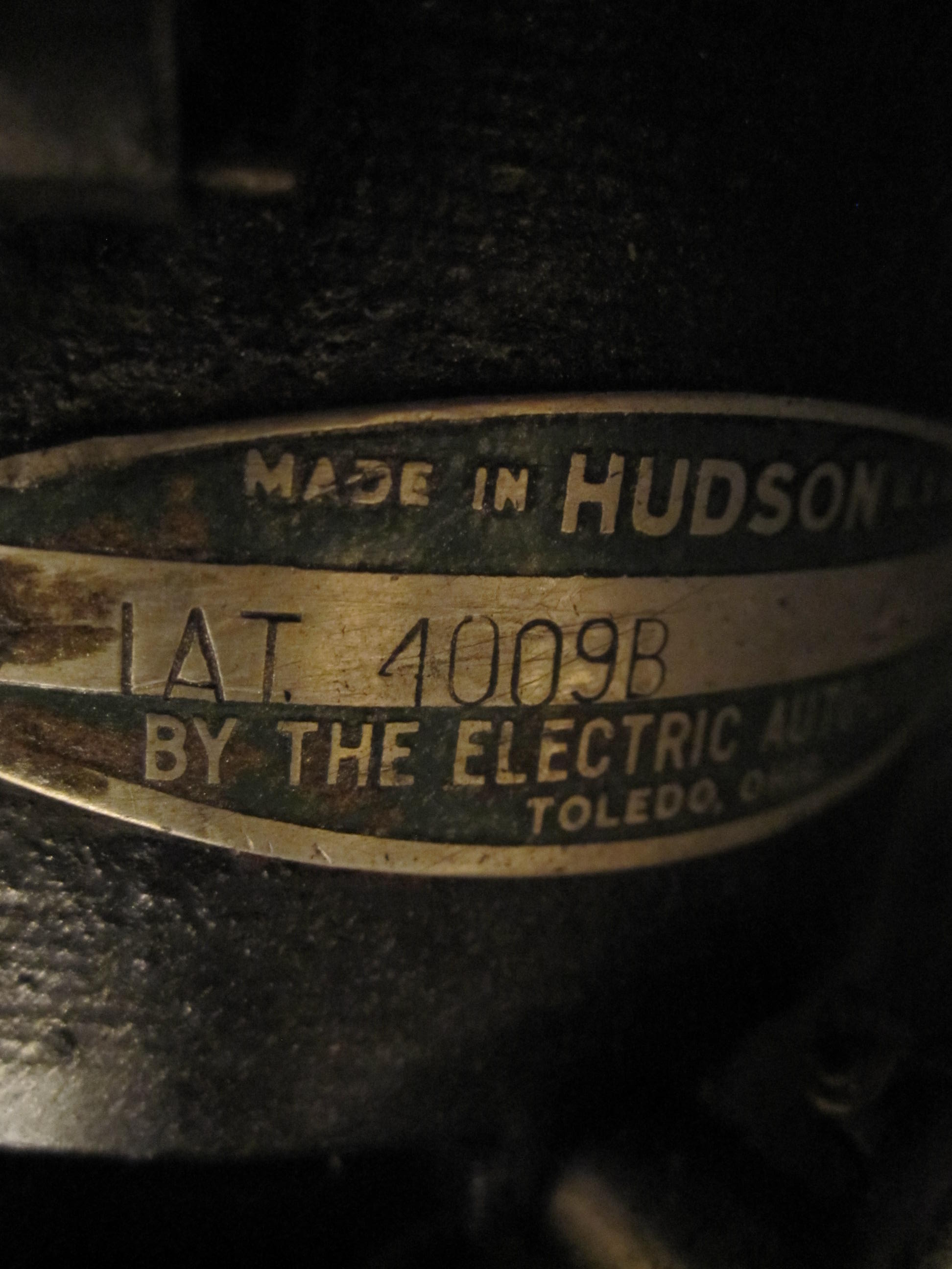

Tks--wondered about all that. BUT, need to locate the IAT 2023RN vac. advance and install with it. Ideas??

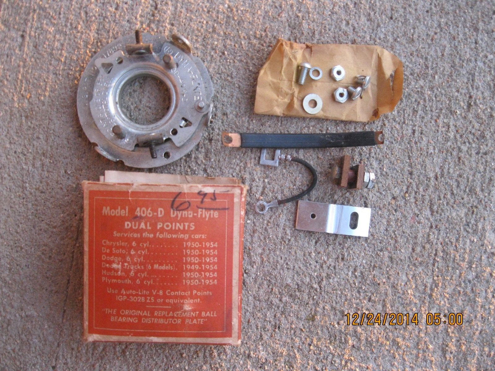

Have the Dyna Flyte new in orig box !
Thank you Ken, You gave me more info than I even knew I needed.0
Ken, my dist. is also a 4009B. I have no problem with my vac. advance; just thought the 2023RN might be worthwhile. Maybe not 'til the stock goes bad??

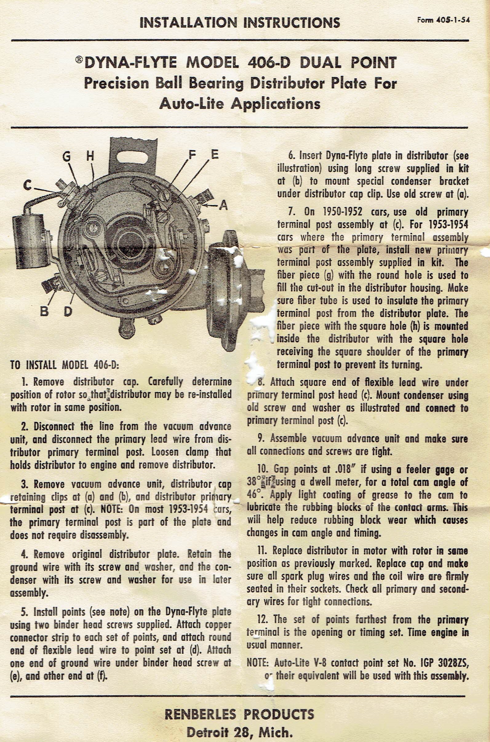

But know about the advantage of dual points from decades ago. I am running a souped up coil, probably 40kv. Have 6A MDS and others on shelf if recommended?? What condenser do you recommend since I would have to relocate anyway. Assume I do all this w/o pulling Dist?? Thanks~~& tks, Chris, for the slight diversion.
