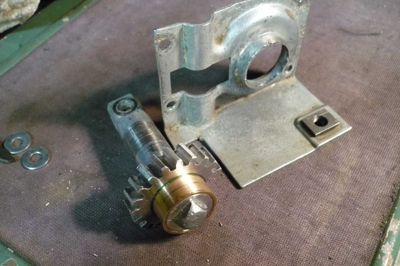

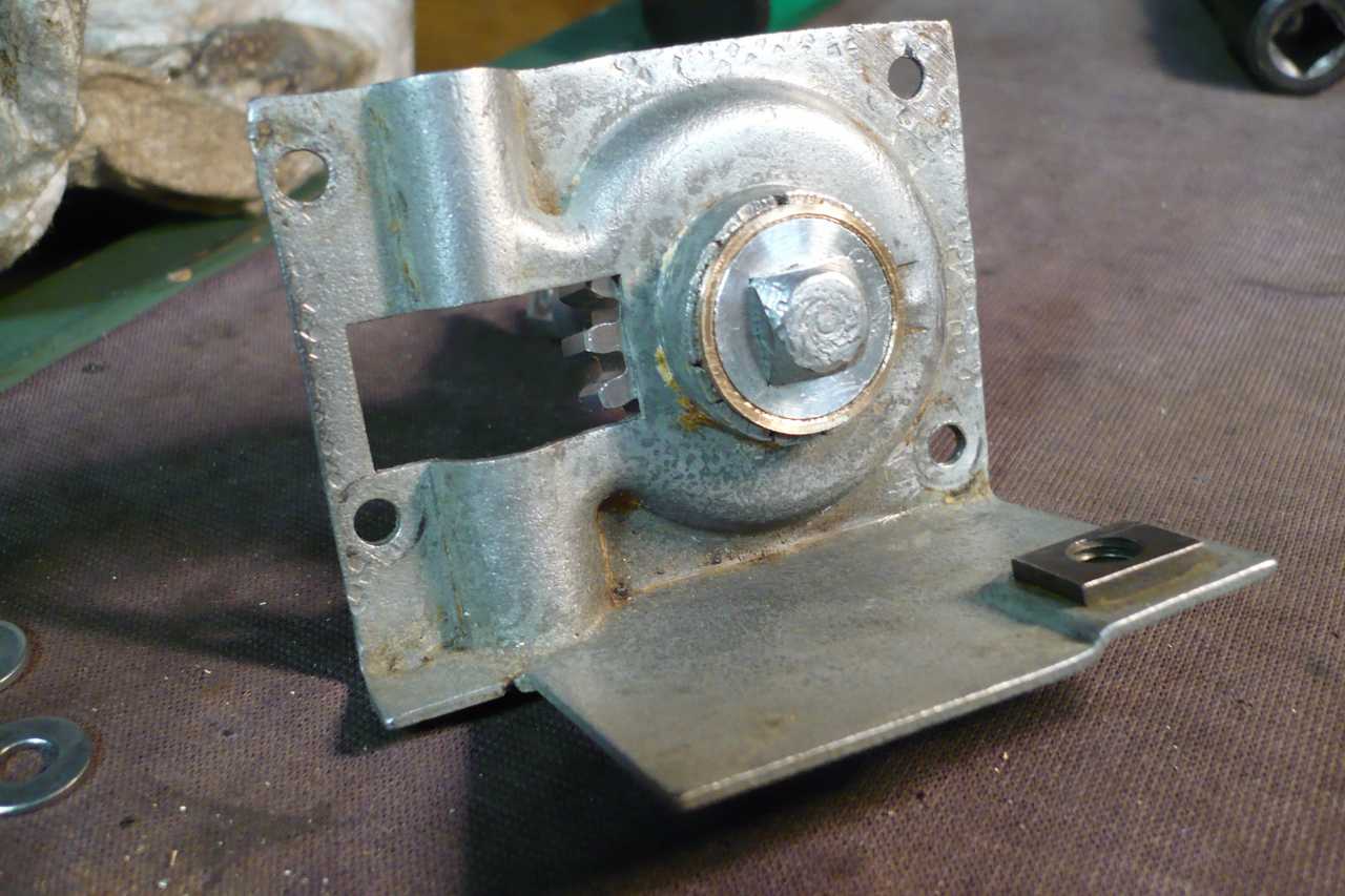

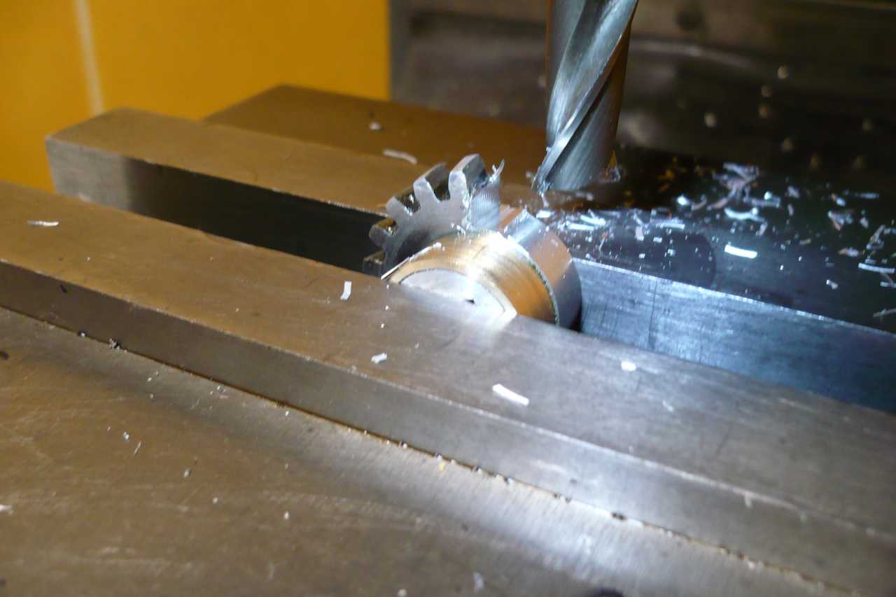

786, 787) New gear with hub turned down and sleeved back up to the larger Hudson size.

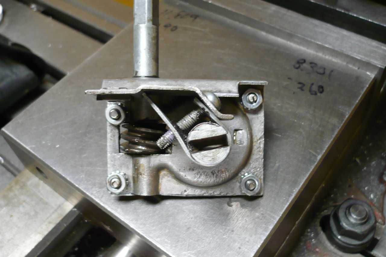

789) Note the slot angle as compared to the body of the gear box.

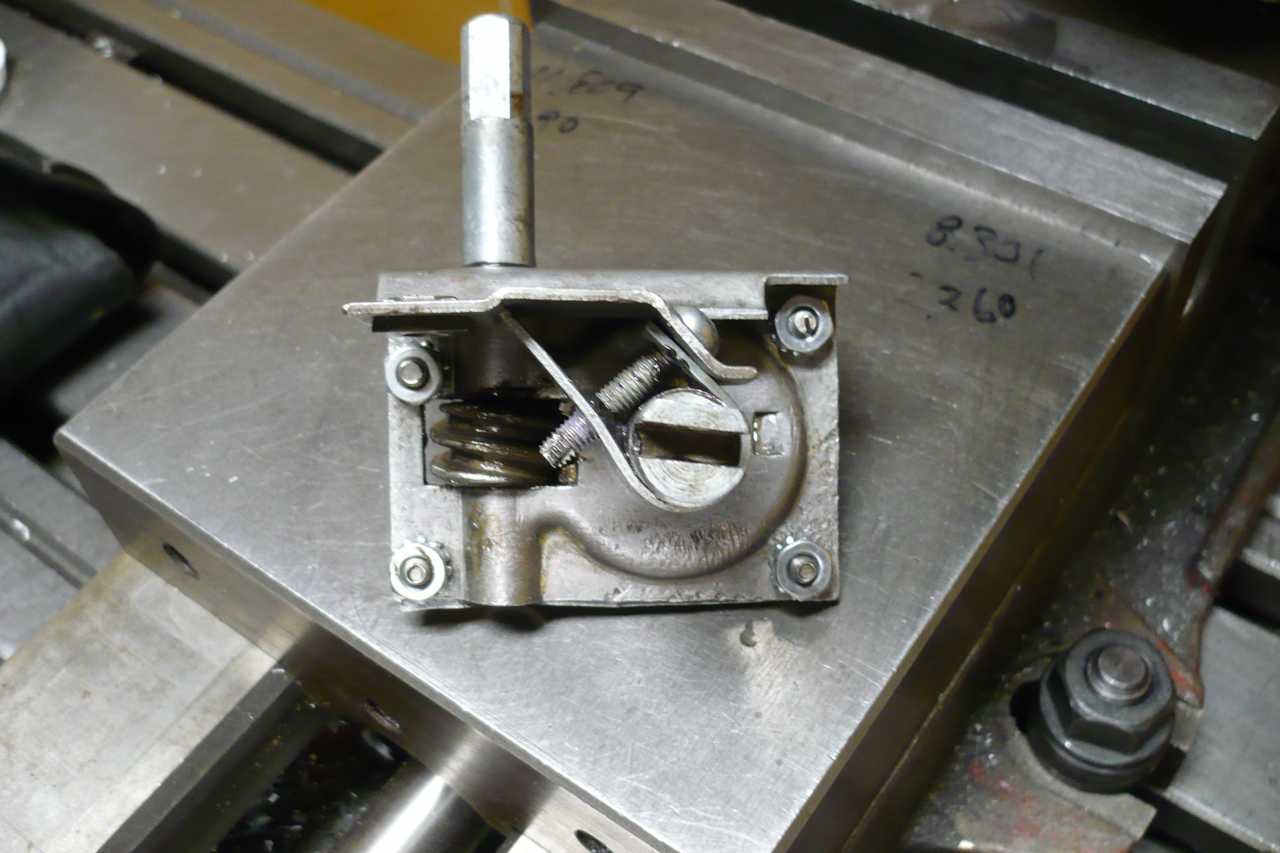

790) Angle after modification shown in 788.
