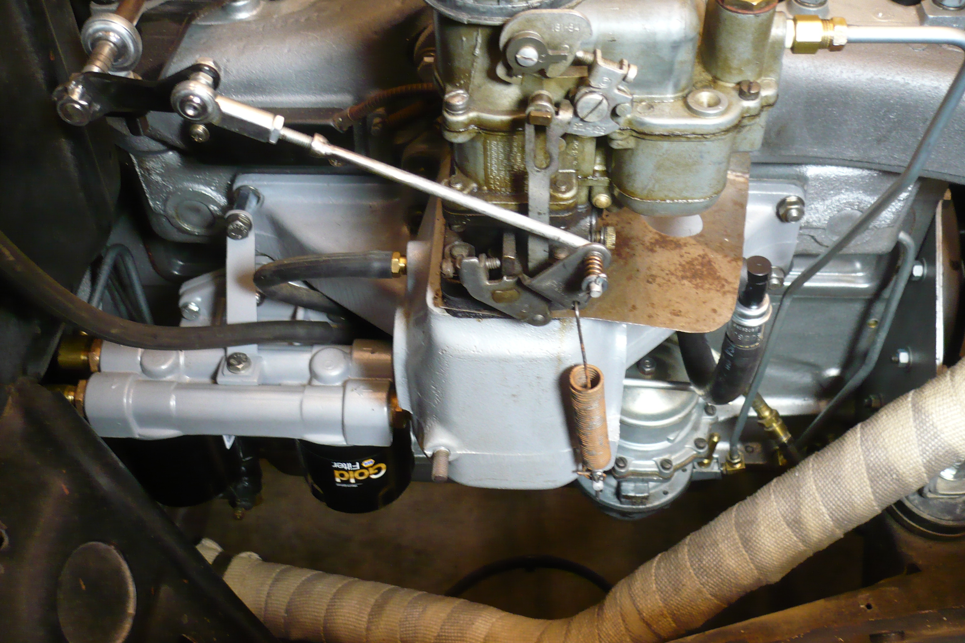

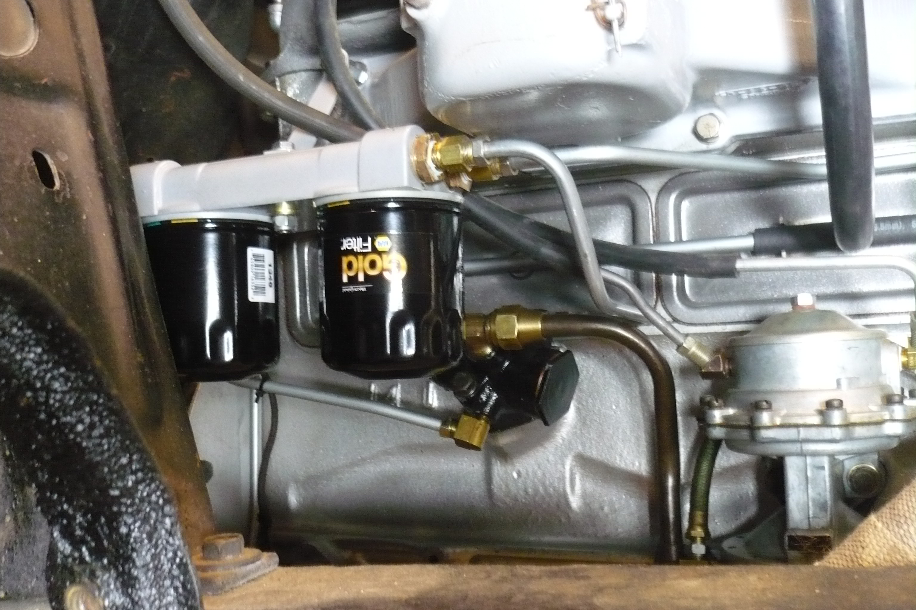

An inline oil filter on splasher Hudson engines won't do much, because the oil pump is a very low pressure unit that is only used to pump oil from the bottom sump of the oil pan to the upper tray of the oil pan where the connecting rod dippers catch it.ken1962 said:Also you could think of installing a oil filter inline - mine doesn't have one but it was an option later on to do Cheers kenBetter to use a good oil and change it often.0 -
Whatever you do, don't install a bypass type filter inline in a splasher Hudson. It's untrue that the Duo-flo pump is a "low pressure" pump. It's a gear-driven, positive displacement piston pump that will put out high pressure if restricted (like with a bypass type filter).
If you wish to add a bypass type, it must be installed per the book, in a bypass circuit parallel to the rear oil line circuit, not in the main line circuit, preferably using the factory supplied fittings.
It is possible to install in-line full-flow elements in the Duo-flo system but is a bit involved. Mine has been performing just fine for several years and a few thousand miles.
