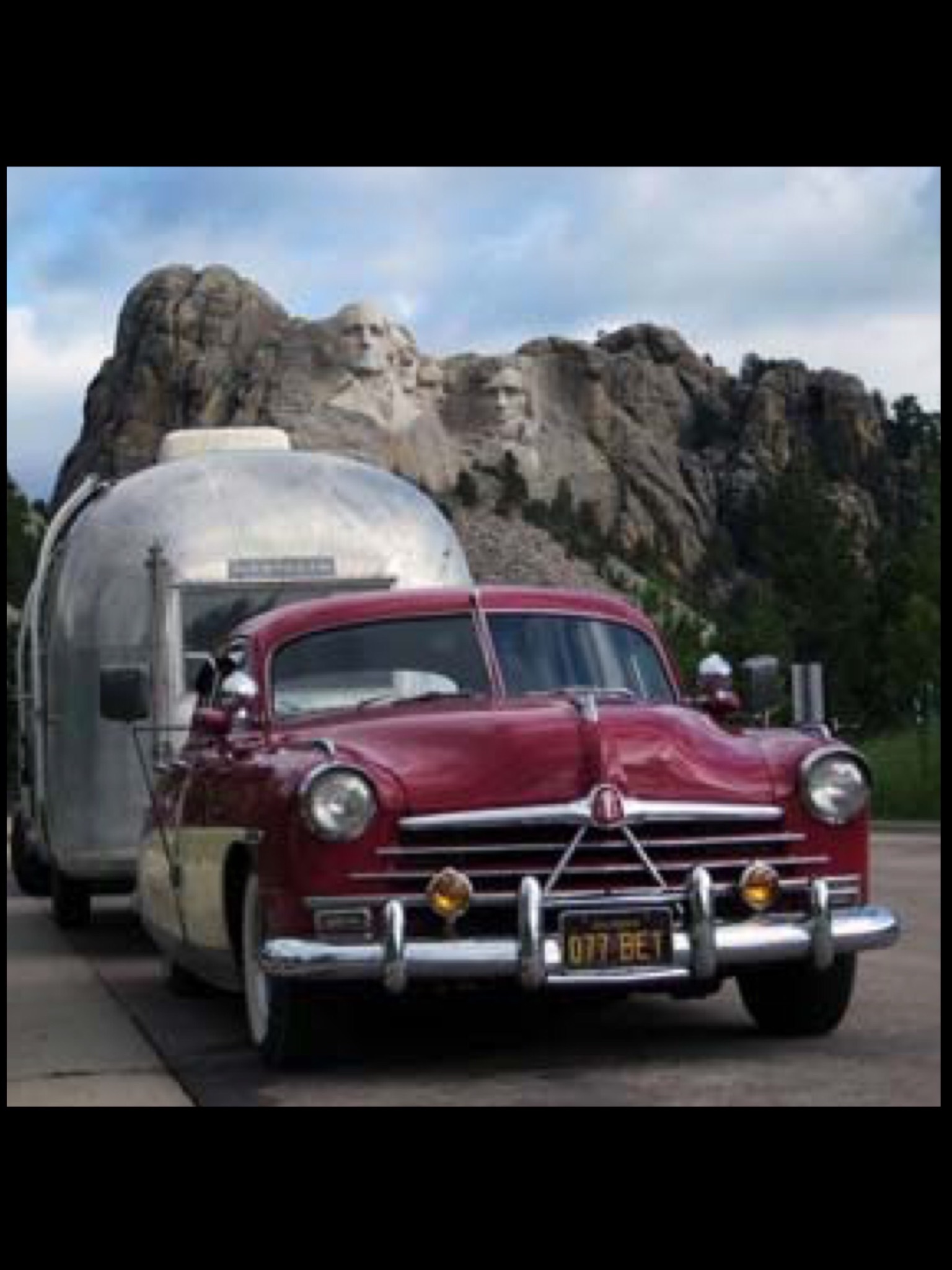

This is my first post. Just wondering if anyone knows anyone who has hooked up a Hudson with an Airstream. We have a 1959 24' Airstream trailer which we would like to one day pull with our 1954 twin H Hornet.
Perhaps someone knows the owner of this stepdown and Airstream? The picture is from the South Texas H.E.T news March 2014 page 6. I have not seen another Airstream and Hudson combination.
