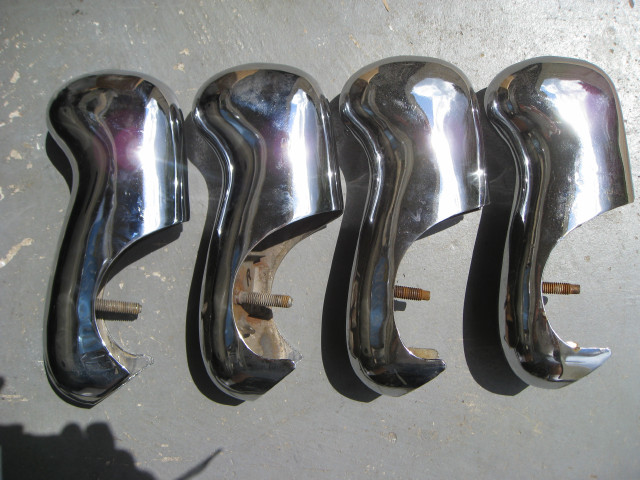

Any Idea what cars these go on?
The 2 on the right are a set, the 2 on the left are completly different.

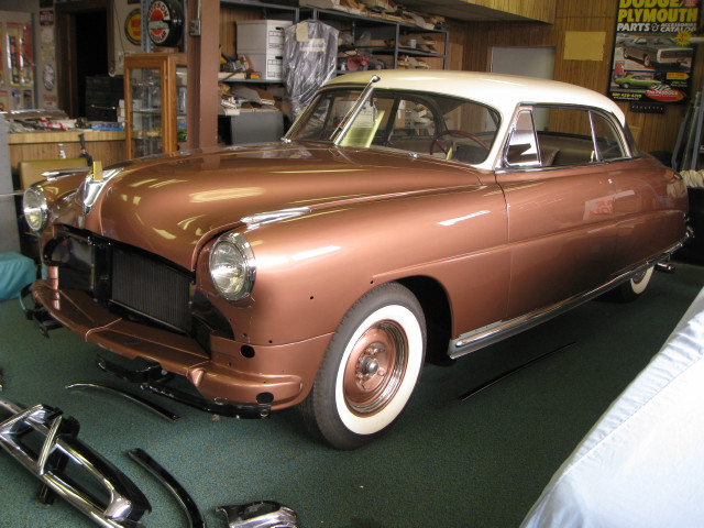

Jon, this car is in it final stages of restoration, it is a rust free car that has been garaged since coming from California in 1976.
I have a few sets of wheel covers. One set are made of steel front and back with the face chrome plated.
The condition of these make me believe these may be aftermarket or reproduction covers.
Another set has a steel back with a polished stainless face and another set are stainless front and back.
What is correct for this car?
Barry, The correct wheel cover for this car is a complete stainless wheel disc that has the red triangle painted in the center of the cap. Beauty rings optional. Up to the 1951 model year Hudson had a galvanized steel base and a plated steel cover. They were heavier and prone to rusting. With a full stainless cap they may get dirty or dinged but they will not rust. BTW there is a slight difference in the front and rear outter bumperettes. The picture you took of the 4 bumperettes are showing 3 front and one rear. The first one from the left is a rear bumperette. It looks very much like the front except the angle of cut of the bottom part of the rear bumperette imndicates it a rear model.0

The engine in this car is painted gold. I was told it is an Oldsmobile color. Is this correct for this car?
That is about as close to original gold as you will get.0

Lance has it right. Bumperettes are front and rear, L & R. They are all different. Rears use the short "tails". Yes, you can bolt them on the bumper in any configuration, but if you swap L to R (or vice versa) they sit crooked. If you swap F to R (or vice versa), the tails don't match the bottom of the bumpers. I see cars all of the time that rarely have all of the "correct" ones in the right places. I went through about a dozen "sets" before I found a full complete quality set.0

Doc, it is Texas tan. Every picture I have taken in the building looks too red. In person it doesn't look anything like the pictures. It was matched to the factory color in the door jams.

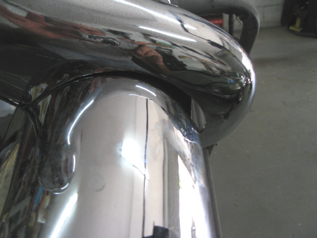

I had found on this site that all of the step down cars used the same bumper stamping, but the holes were placed in different locations.
I find it hard to believe that the front bumperettes came from the factory like this , when the rears fit nice and tight to the bumper..

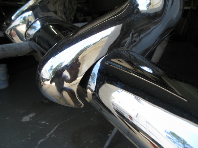

This is what that same bumperette looks like on the other side. The gap would be wider if it was pointing straight ahead.

I should have worded the second picture better. The second picture is the left guard on the right side of the bumper.DocHubler said:Your bumper guards are transposed as suggested. Common mistake on re-installation.
I was simply showing that it doesn't match the contour of the bumper.
