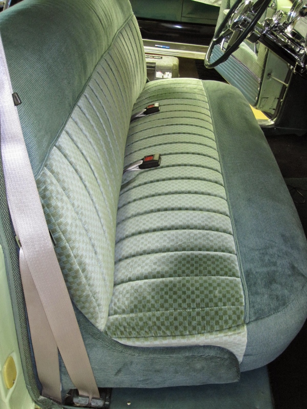

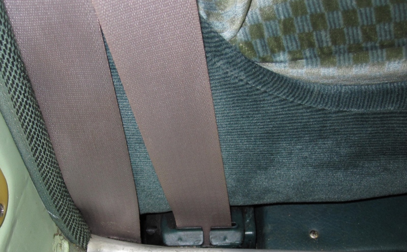

I have 3 pt belts in front and lap belts in rear and would not put 3 pt in rear for several reasons. These are obvious so I won't list them. Put in a third taillight or rear hazard lights; seems better 'odds' to me~~
Post photos if you do install; believe you would have to go into the trunk since the angle appears wrong to go to the post.
edit: Others note that if someone extremely short legged drives a car with 3 pt in front, cushions will be needed since the retractor blocks the seat from moving to very front.
