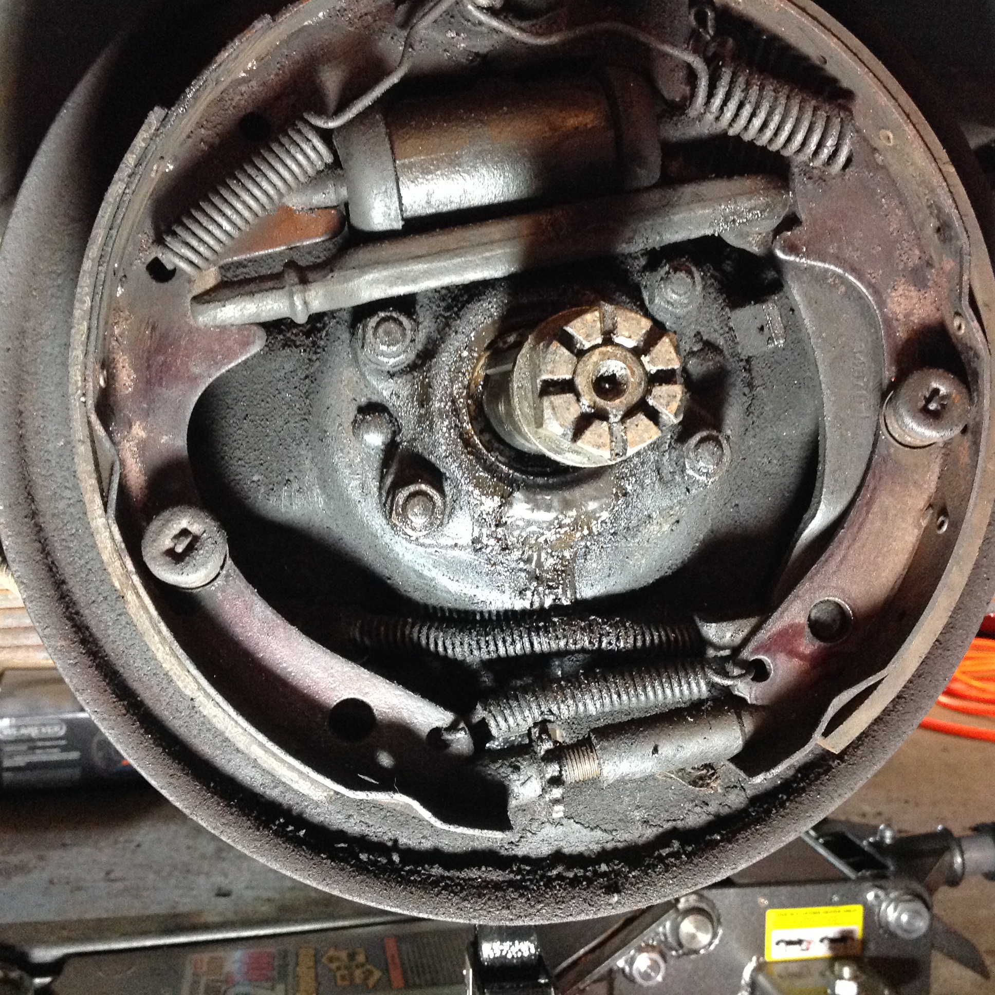

Guys,
I have gotten to the point of removing the rear drums so I can begin the brake rebuild. I discovered that on the rear drivers side that the leather oil seal is either not there or worn out.
This is from my mechanical procedure manual. "Spring pressed hydraulic leather oil seals fitted between the caps and the rear wheel hub prevents leakage of oil onto the brake shoes"
Please look at the photo for reference. I cannot tell if there is a leather oil seal in place or not, but I certainly see that a lot of oil has leaked probably for a long time.
Where does one acquire a new leather seal or is there a modern day replacement for the leather seal?
Do I need to replace the wheel bearing or can I just put the new seal in?

I list these numbers for the seal.
Victor 49218, or NAPA CR 17310
Make sure the vent on top of the axle is not plugged and pressurizing the innards.
Save the bearing if you can because they're the tapered inner cone and they don't make them any more. There are a very few floating around and they are pricey. Fortunately, if lubricated properly, they last almost forever. If you have to replace it, get a replacement axle with a good bearing. I did replace the outer race on my old truck, reasoning that if I were a bearing, I'd rather have a new ring, which are cheaper than dirt, than the rough one I was running in.
Lubricate the bearing by removing the 1/4 in pipe plugs just behind them and insert a Zerk fitting and give them 2 squirts a year with a grease gun. If the bearing isn't grumbling, it's probably OK. If you're the only one greasing them, leave the Zerk in there. If you take it to a garage for a grease job, they will blow your seals, thus the pipe plugs to keep them out of there.
