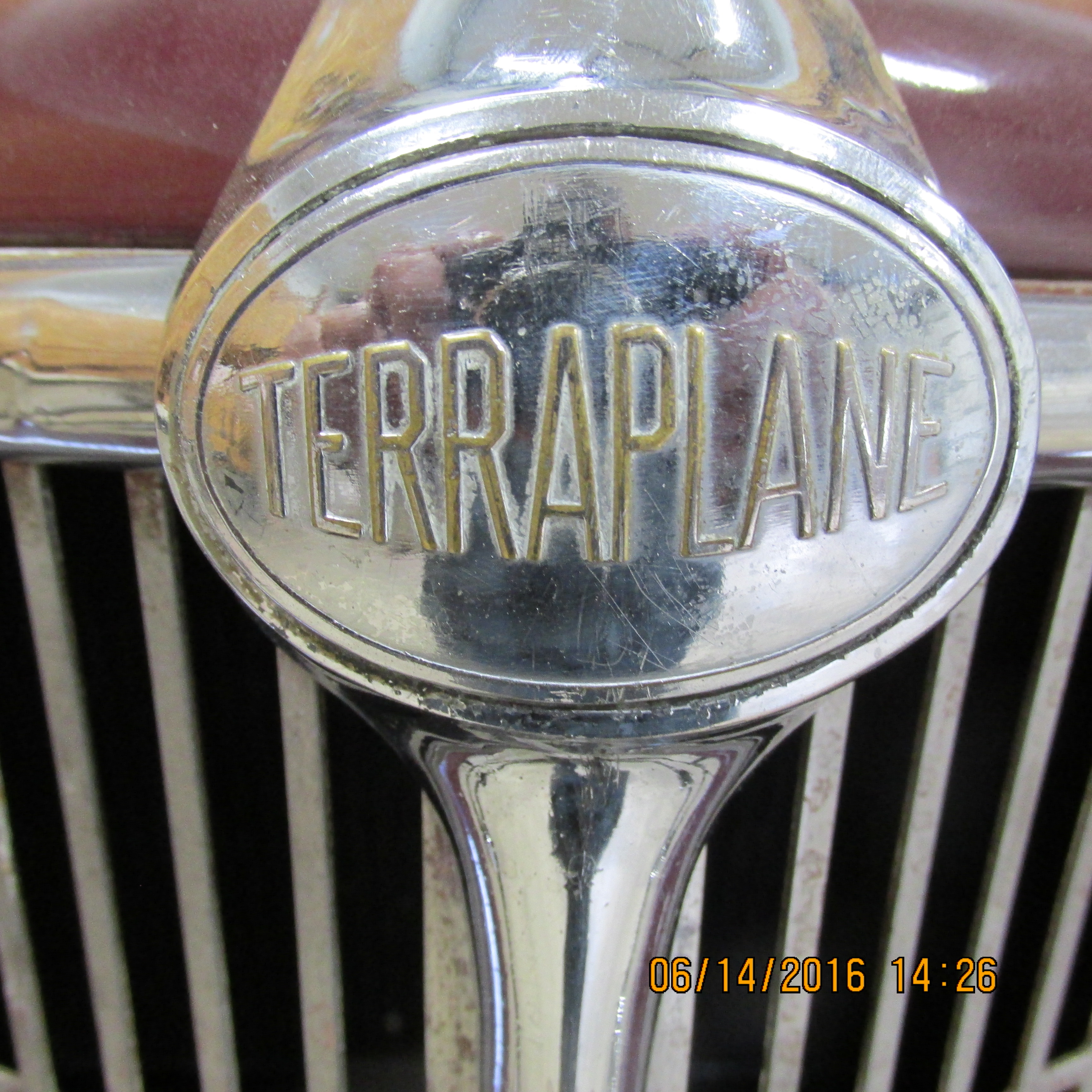

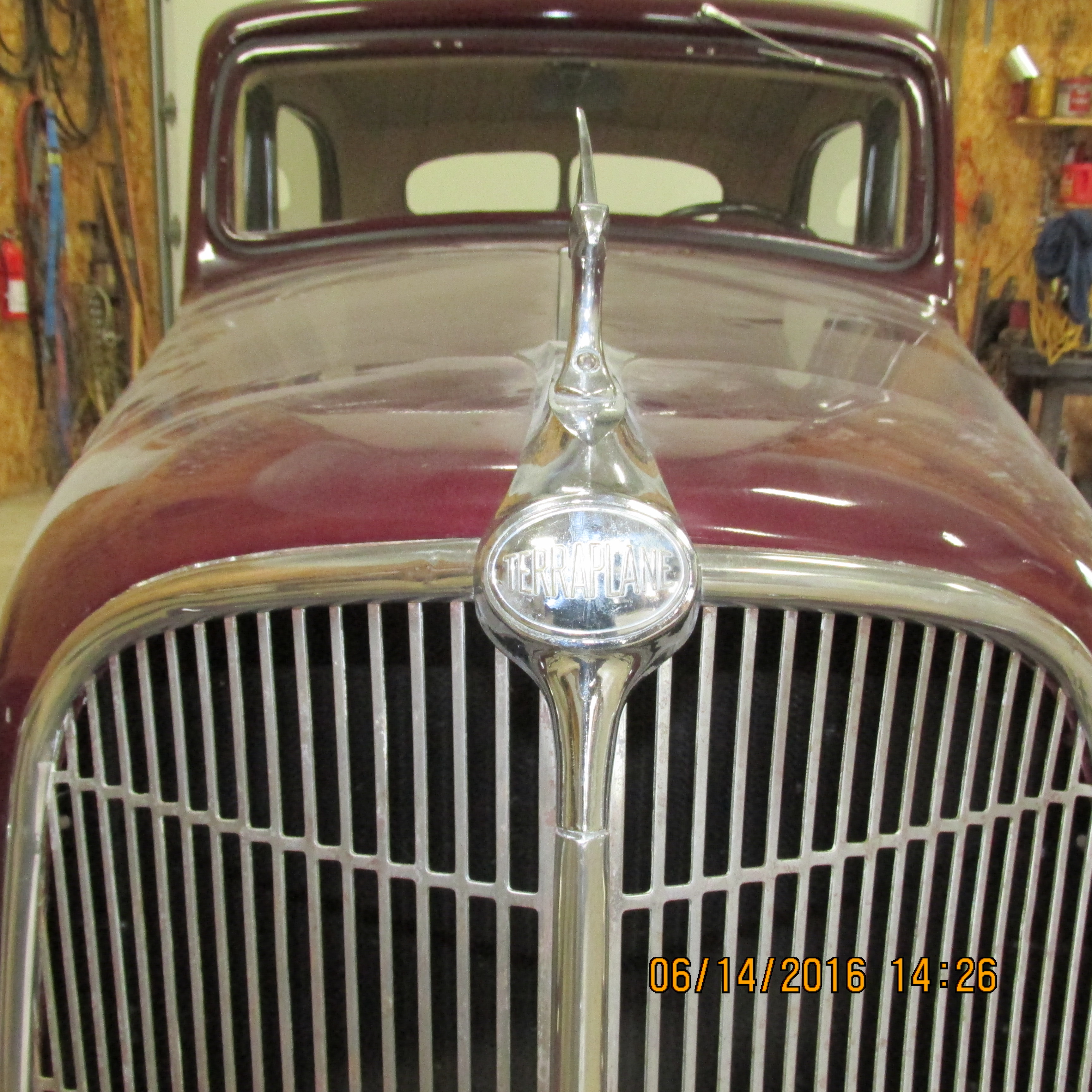

Gentlemen,
I have noticed that some terraplanes have the background on the front emblem painted white while others look like the one on my car. How were they when new? Was there a difference between models? My 35 is a special.
Thanks,
Mike

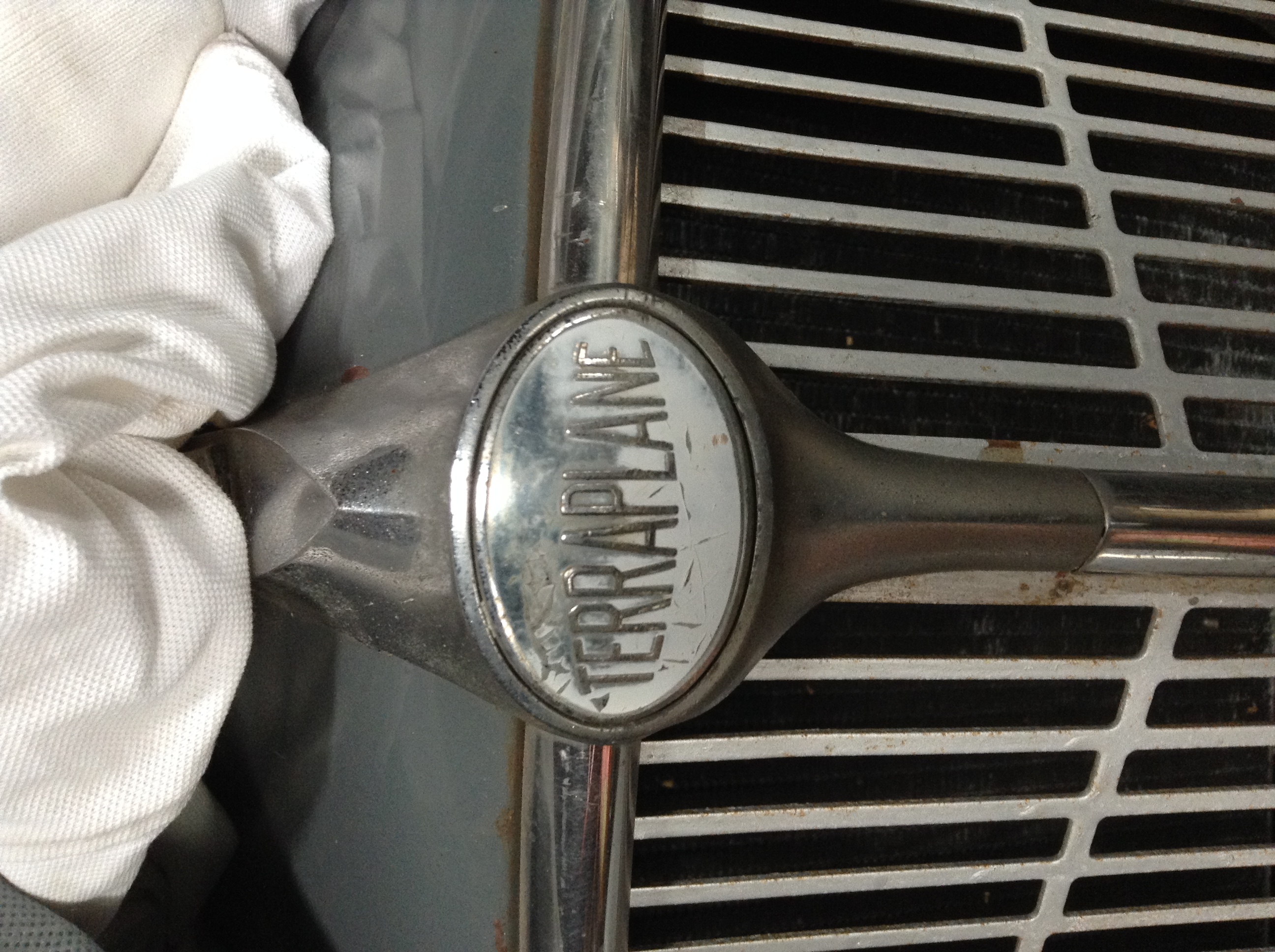

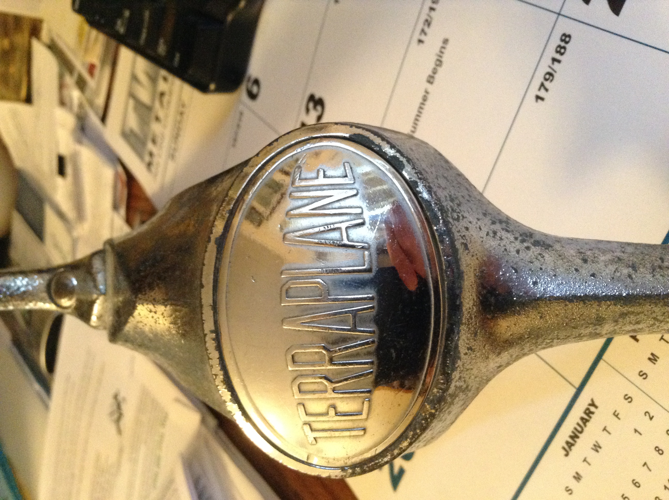

Mike, the one that is on my car has a white background but it's somewhat faded. I bought another one online that has no background like yours. Not sure if the one on my car got painted at some point in the cars life. Tom0

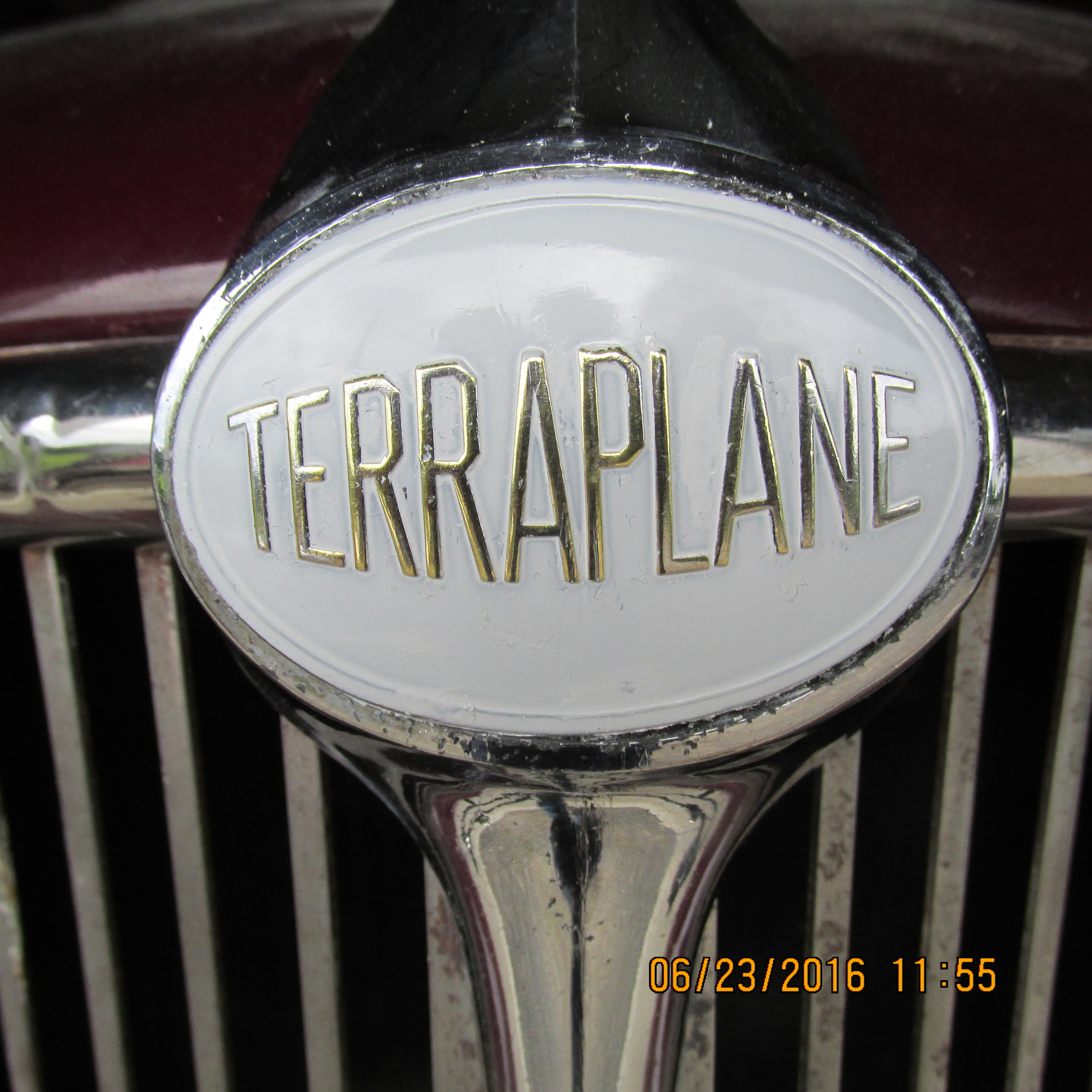

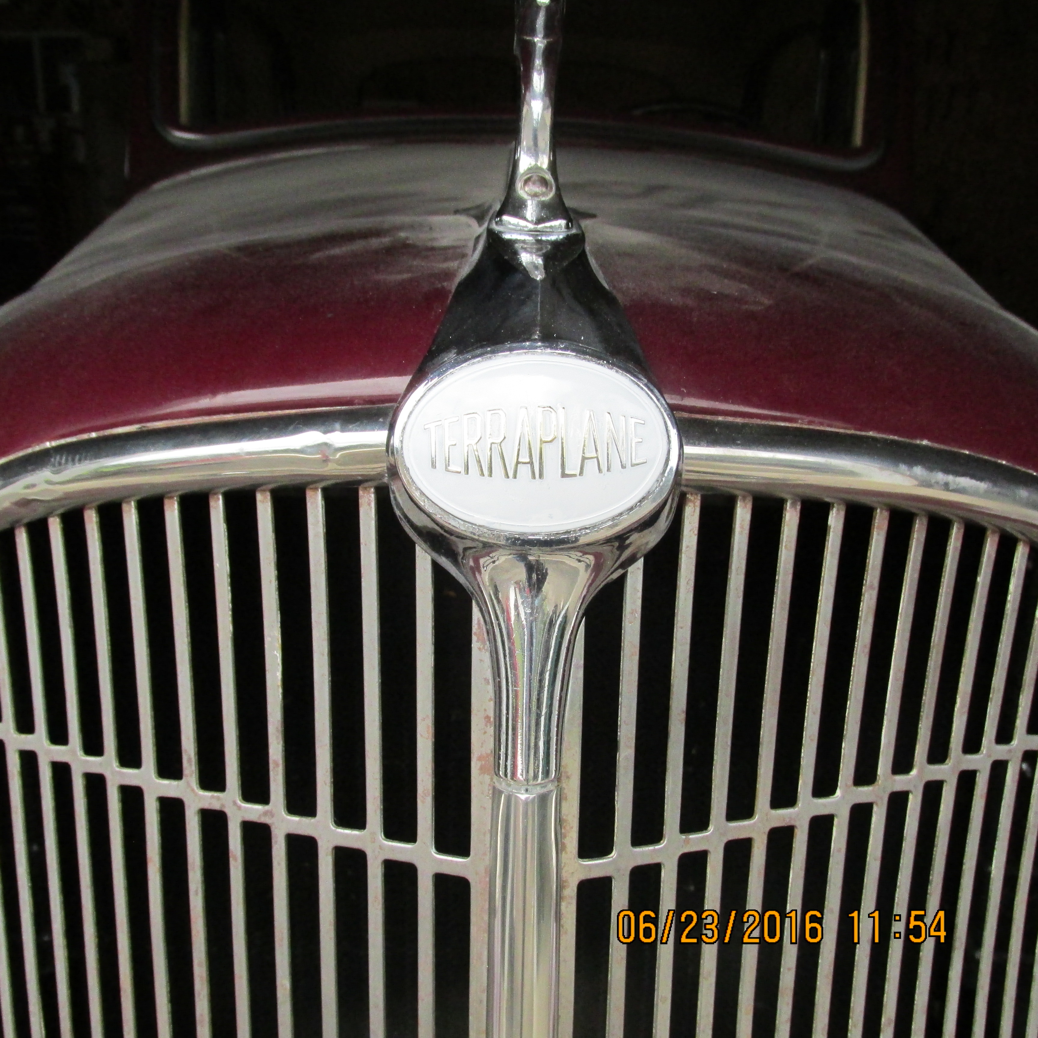

Ken,I had never heard of enamel powder. Took your advice and watched some youtube videos of the process. This time of year is my busy time so I was looking for something I could do without taking it off of the car for the short term.That said, I took nerve-centers advice and tried masking the emblem after making sure I had cleaned it well and sprayed it with enamel and let it dry overnight and then used the handle end of a small brush covered with a soft cloth soaked in thinner to rub the paint off of the raised lettering. Took several tries as I kept mucking it up but I finely have it looking kinda,sorta OK for now. Not sure how long the white will last before it starts to yellow but I will just strip it off and repaint or try some of the other ideas folks have suggested.I am sending two photos I took of the emblem today as well as the before photo I posted earlier.Thanks,Mike0
Good on you Mike. It's all part of the fun to give it a try and your results look good. It sets the front of the car off really well.0
Have to agree, really does look good - sitting on the front of the car against the red hood cheers ken0
