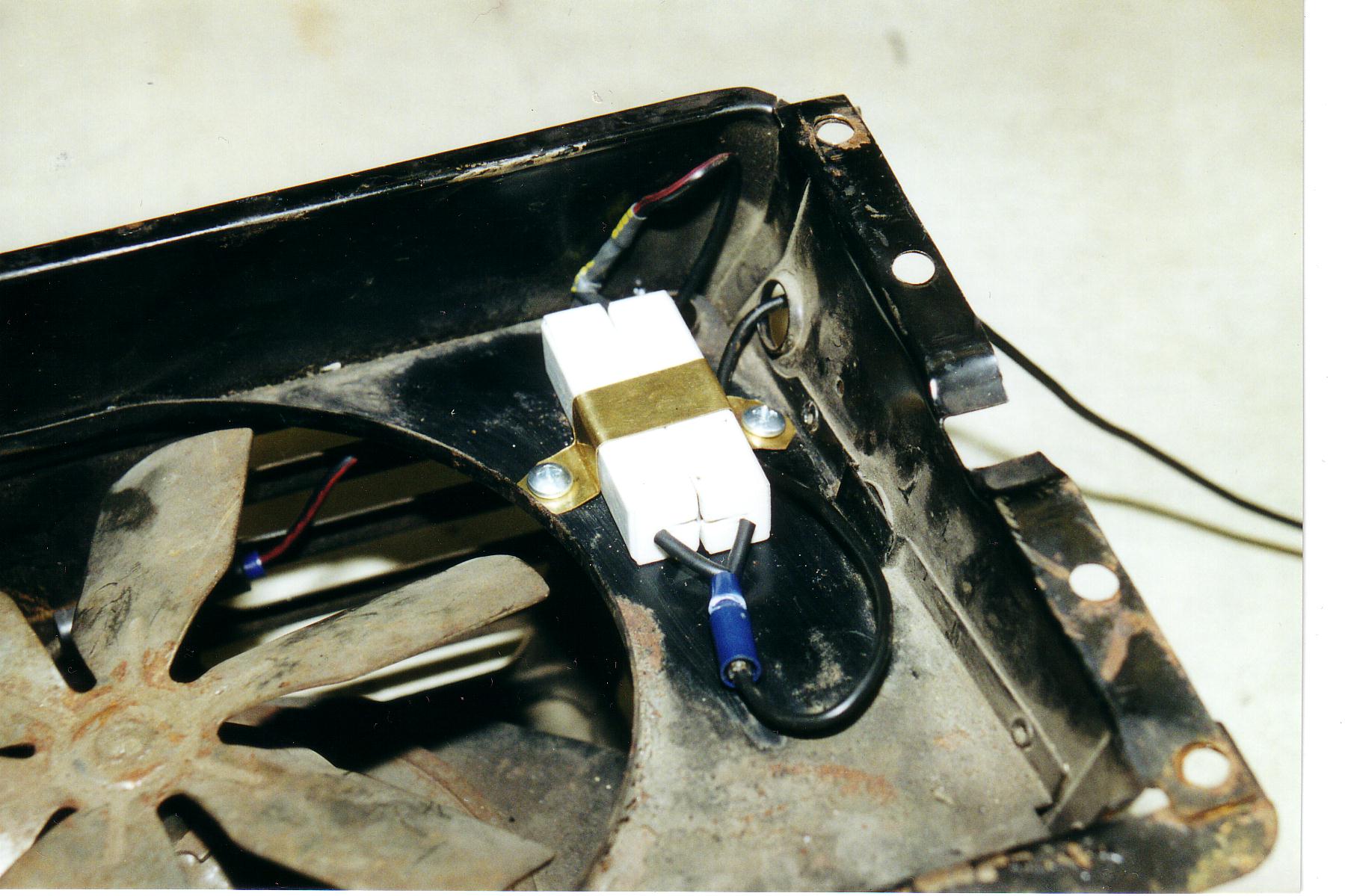

It's normal for it to get hot, as you've stated. And it will get hotter with the blower on HI, since there's more current going through it. I like to use a "ceramic stick" type resistor and fasten it inside the heater housing. That way it's not where anyone can touch it, and some of the heat is transferred to contact with the metal housing.

If you still want to go the resistor route, one source for such resistors is Mouser Electronic. www.mouser.com. Search under “power resistors” or “wire wound” resistors. Mouser number for the 1 ohm 50 watt is 284-HS50-1.0F. I believe that number is a type that's especially convenient . . . it's a molded unit and has two mounting lugs built in.
