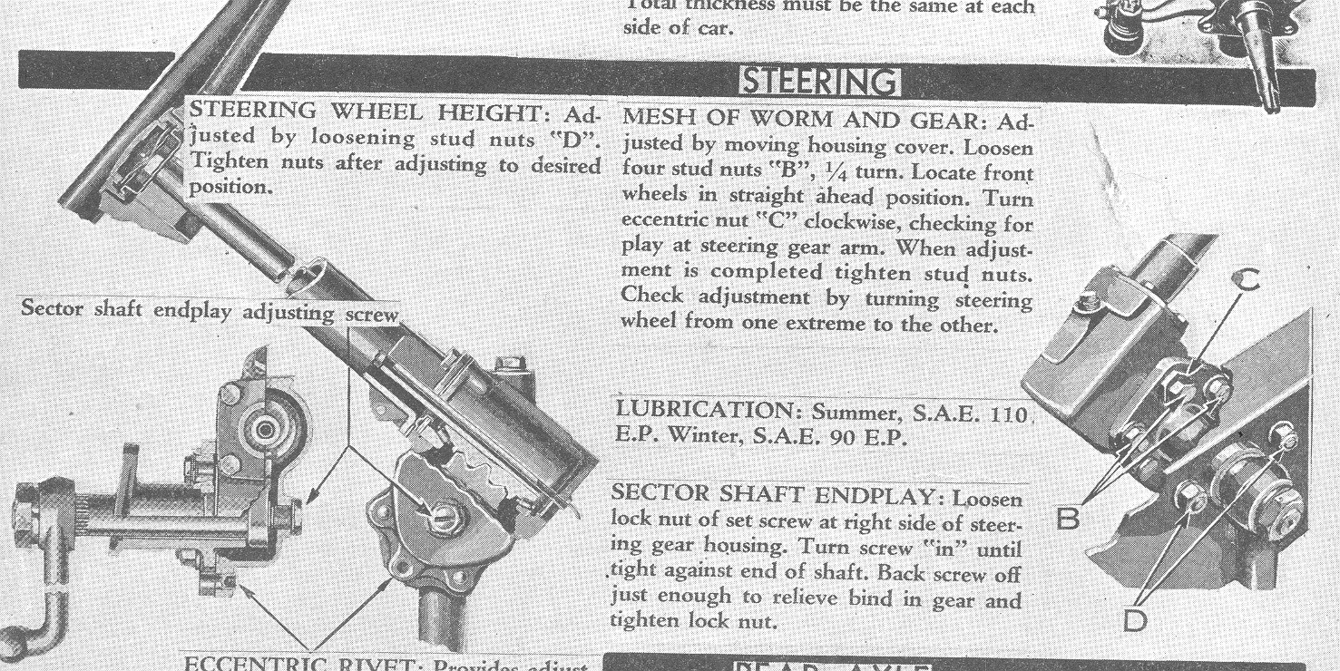

Well, now the plot thickens. Turns out that there are instructions for moving the steering wheel up or down on my 36 Terraplane. In the repair and tune-up manual, are the following instructions. There is room on the pre-stepdowns to move the steering box up by drilling new holes in the frame to clear stepdown eights and big sixes as well.0
