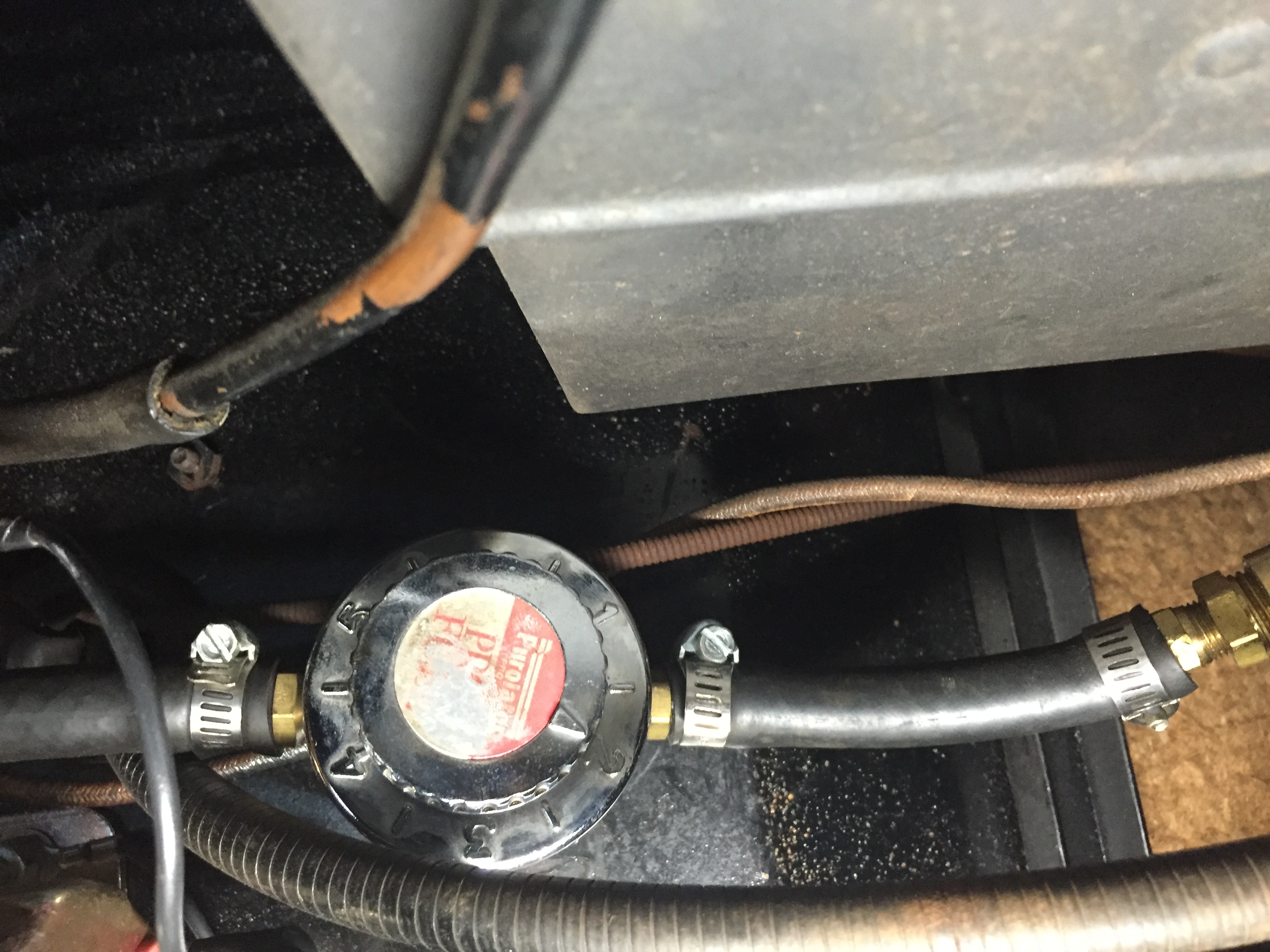

28 Essex Super Six fuel Pump
Originally the Stewart Vacuum Tank gravity fed a Detroit Lubricator "25" carb.
This combination works well & I much prefer the Detroit Lubricator "25" carb.to it's successor Marvel carb.
Possible Greater economy is the only reason I can think of not to use them. Once they are set up correctly you very rarely need to adjust them.

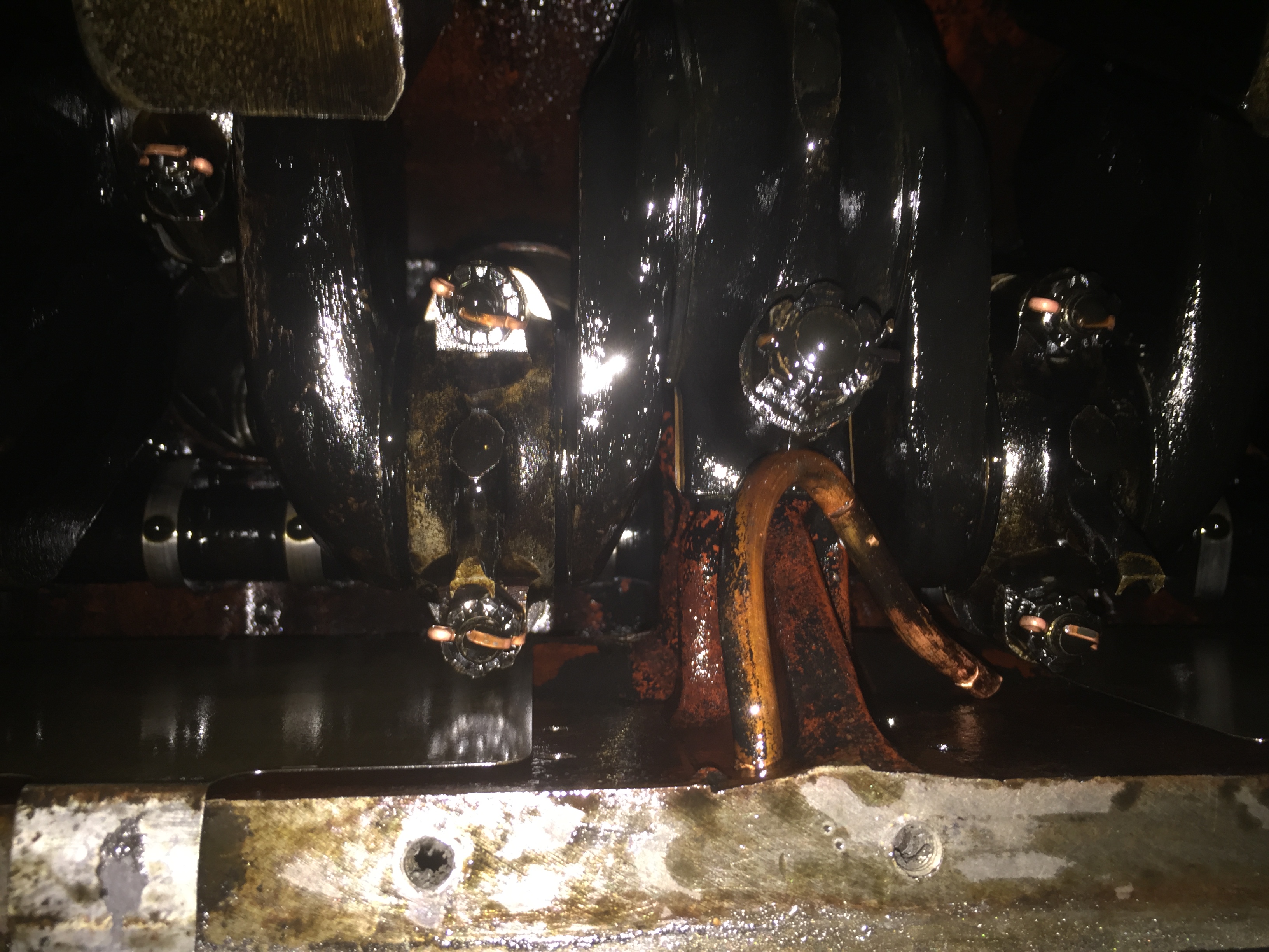

I primed the oil pump, started the engine, and... success... oil pumped out... and the it stopped. That made me believe oil wasn't getting to the pump. So I checked the lower line going to the oil pan. It was clear. So I tried to suck oil up through the suction pipe... nothing but air. There is definitely oil in the tank. I'm pretty sure the problem must be that I bent the suction pipe up when I reinstalled the oil pan. Guess I'll need another gasket... sigh.0
Certainly seems like the pipe into the sump. Depending on what may have been put on the gasket when the sump was installed you may find that the gasket my be reusable.0
