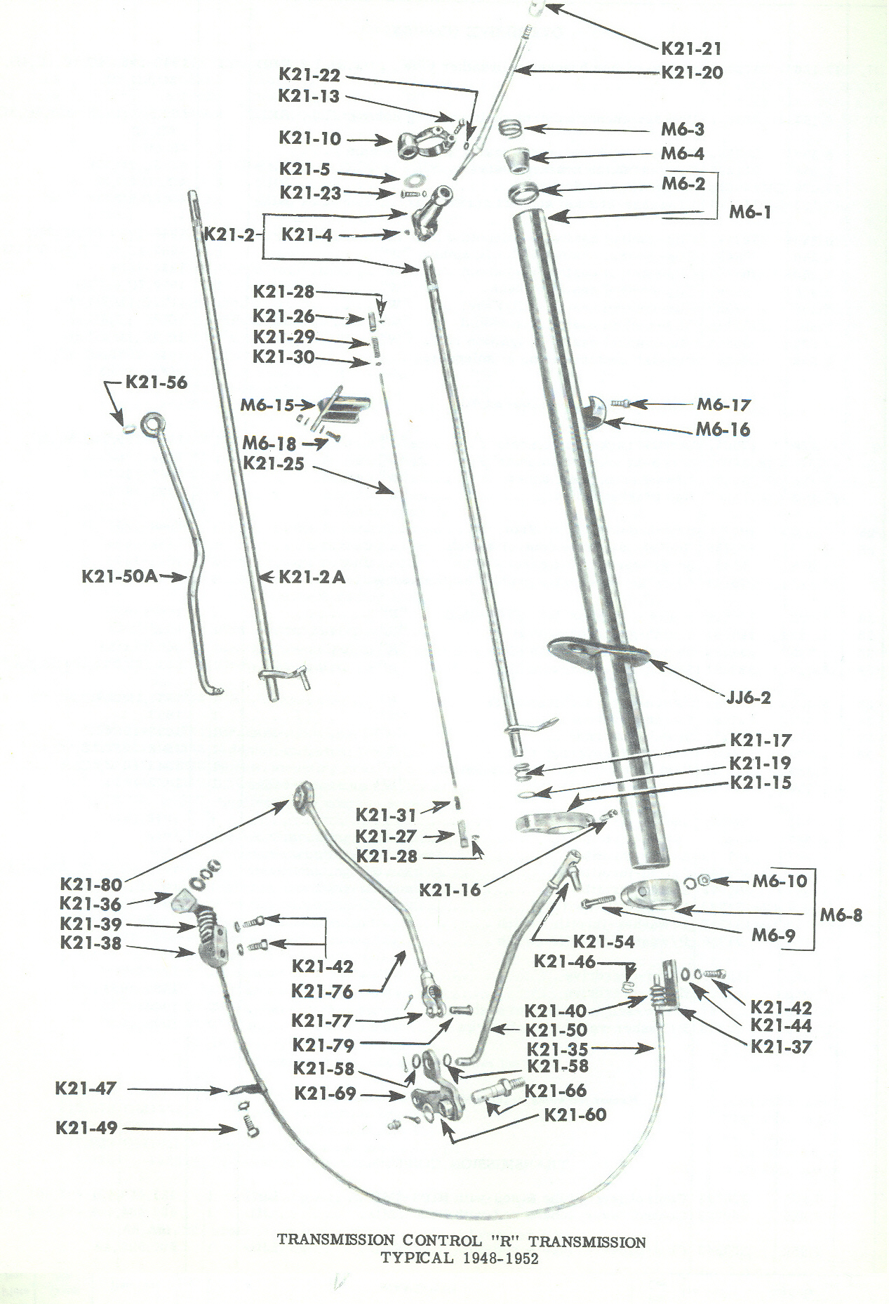

looking for some help on my father's 48 commodore. does anyone have a picture of where the spring is attached on the shift selector on the transmission. I can't seem to find any info on this. Maybe a pic of an assembled tranny would help. Thank you.
Michael, there's no spring at that end of the cable. It's part of the apparatus at the other end, i.e., at the bottom of the steering column. Sorry I don't have a good picture . . . maybe someone can post one.0

This picture is of the parts of the shifting system - it is on my Hudson website http://hudsonrestoration1948-54.com/index.html0

Thanks, Farmer. So, Michael, the spring is item K21-17, at the bottom of the shift column. The thing that looks like a spring at the transmission end of the cable is a bellows-type dust cover for the cable.0
