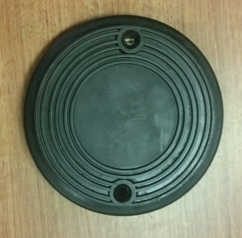

Being a "prehistoric Hudson" owner, I am curious: what was done there, originally? Wasn't there some sort of molded rubber cover that was removed? (Studebaker, for instance, had the following rubber cover that fitted into the carpet over the automatic transmission fill plug; something like this might be affixed with velcro and the edges of the carpet around the hole, wouldn't get frayed as they would if you merely cut a hole in the carpet:)

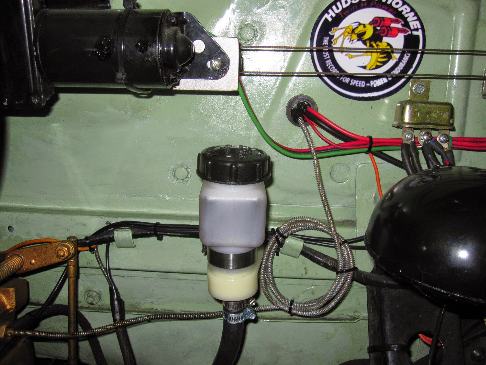

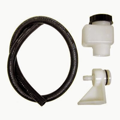

I have same as Ken, so that is 2 !! Remote is Wilwood #WIL260-10500. The other plus is that you don't need a 2 psi res. valve on the front disks.

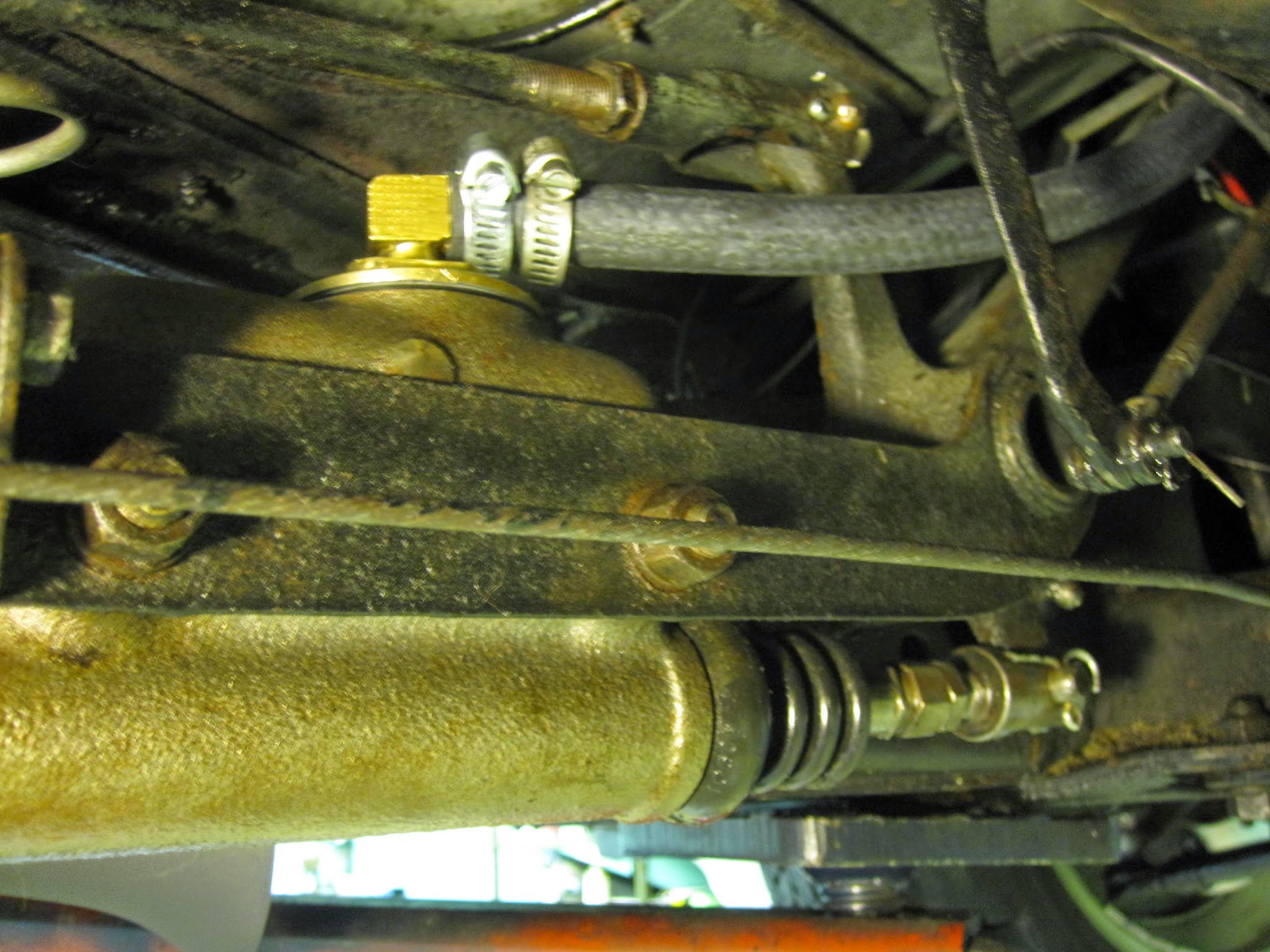

Charlie Harris has remote fill kits. He advertises in the WTN, I bought one from him at the National Meet. Ed Moore0

I am leaning toward the remote reservoir -- it seems very practical and convenient. I have already added seat belts, a radiator overflow tank, and the car came with a 12 volt conversion, so I am not obsessed with having everything in the engine bay look factory original.Thanks again, folks, for all the good suggestions and pointers!0 -

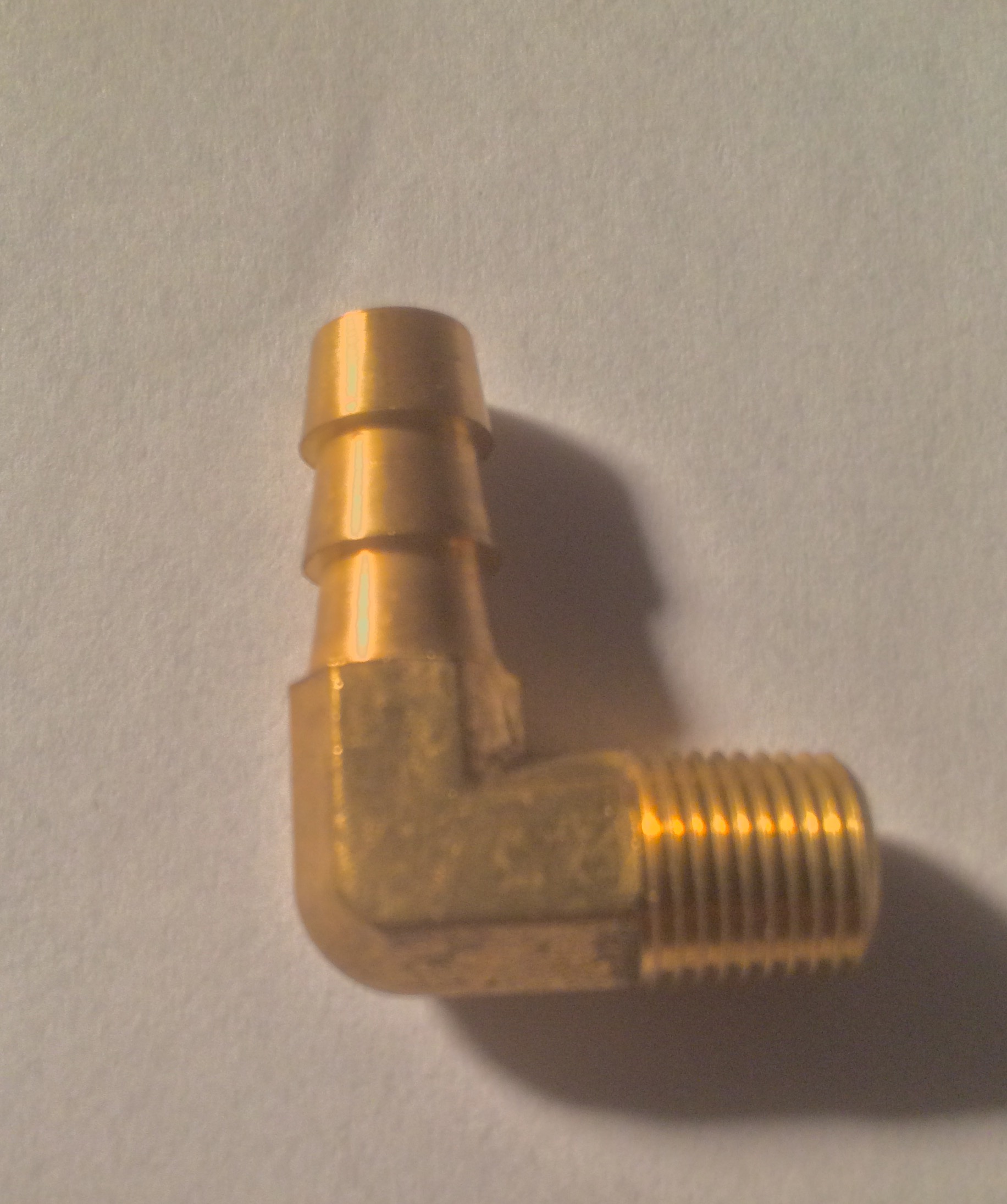

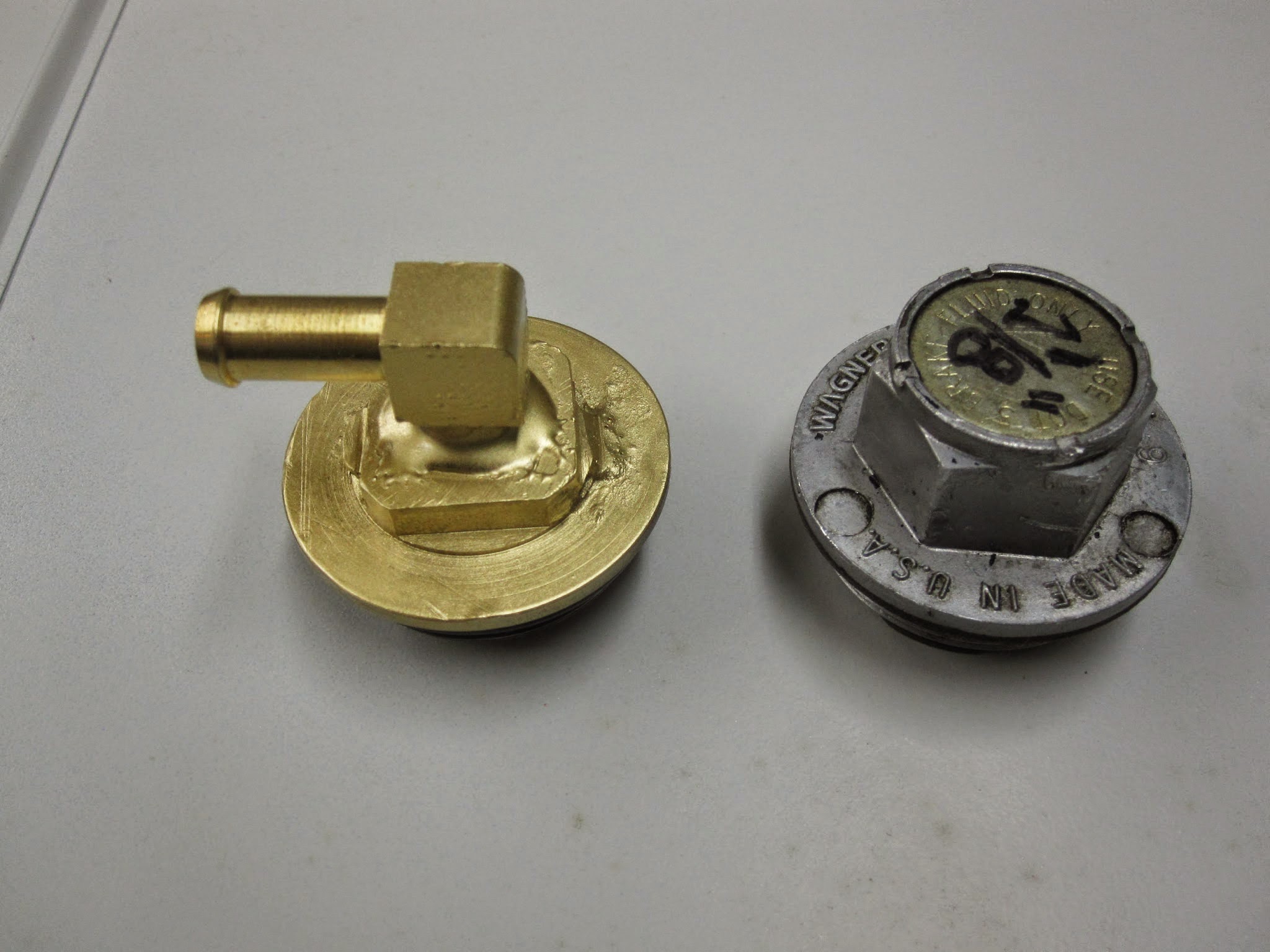

Note: the aluminum orig cap must be replaced with a brass cap so you can braze the 90 degree fitting thru/to it for no leaks.0

To RichardD,
Where can I get the appropriate brass cap? Is it a standard item?
Thanks,
Ed
Got mine from Lance; sorry, don't know anything else.0
Our chapter VP ordered a box of these and passed out 2 to each member. Drill & tap the oem lid then use thread sealant,
