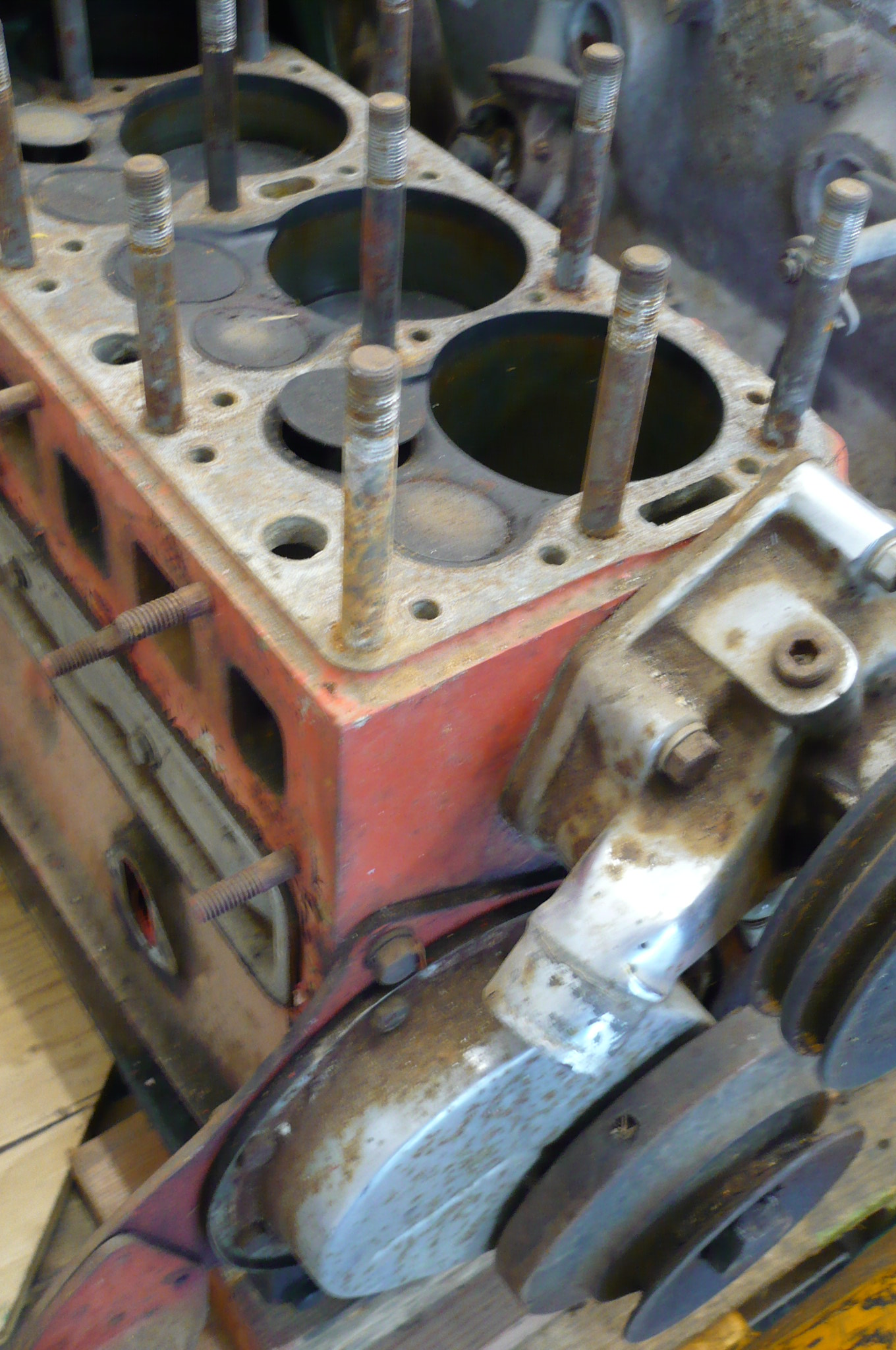

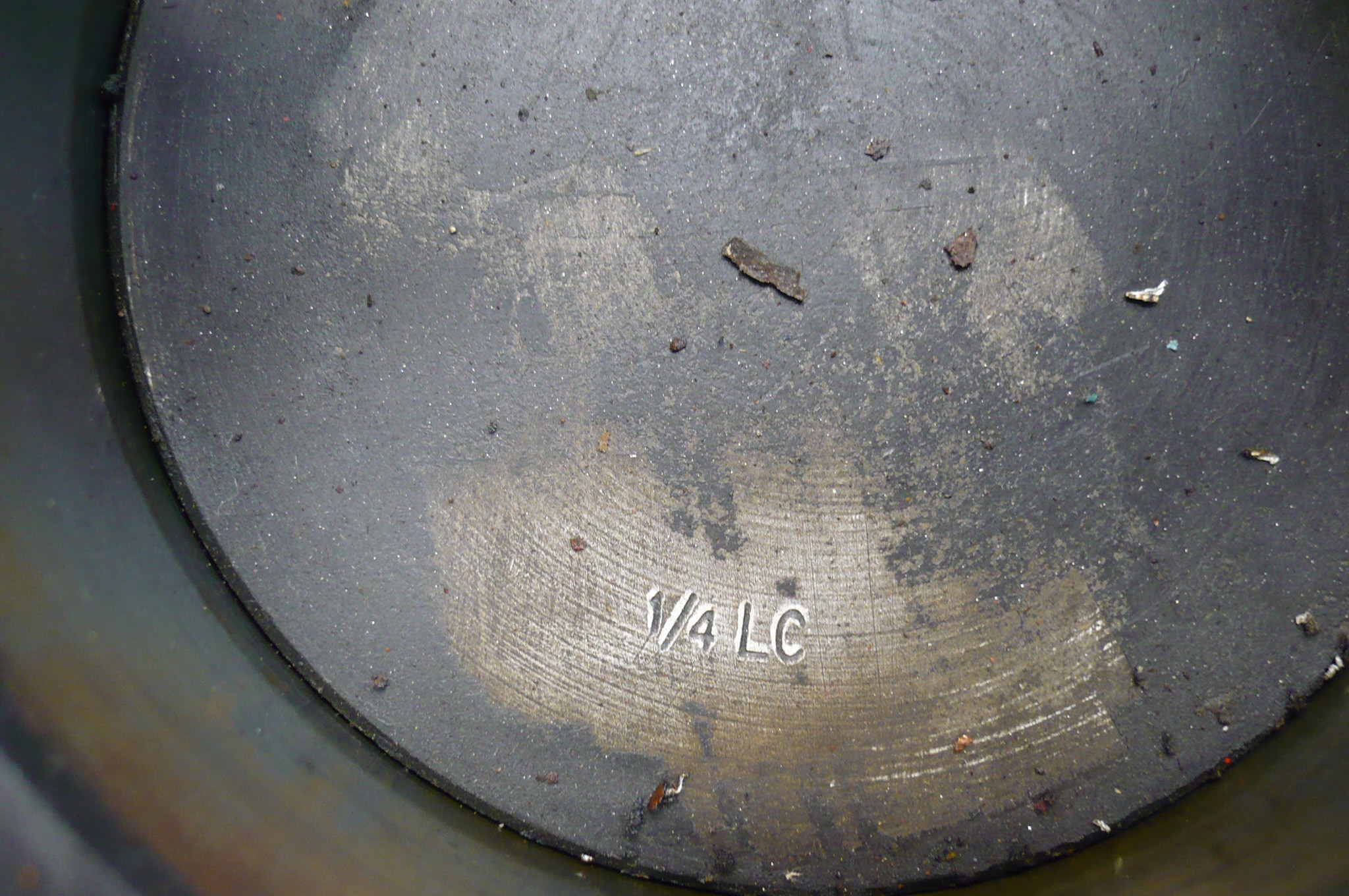

In a clear attempt to drag this out forever, I thought that I'd respond to Bill's Q about piston make. Since the engine is still largely assembled (sans head) I can only see the top of them so I attached a photo of that. It certainly was someone's toy as is evidenced by the chromed water pump, timing chain cover and tappet chamber covers.
It appears to be in good shape yet with no obvious ugliness. I'd guess that it gave the previous owner plenty of good memories and many miles/hours/laps/passes. Valves are oversize though I find it interesting that the cam shows stock lift. It pencils out to 361 Cu. in. Too much on my plate to look into it now but I'll get into it eventually.
Also, not to question Ken's comment on the subject, but it shows evidence of having had a stock type head gasket on it as opposed to the copper version.
Frank
