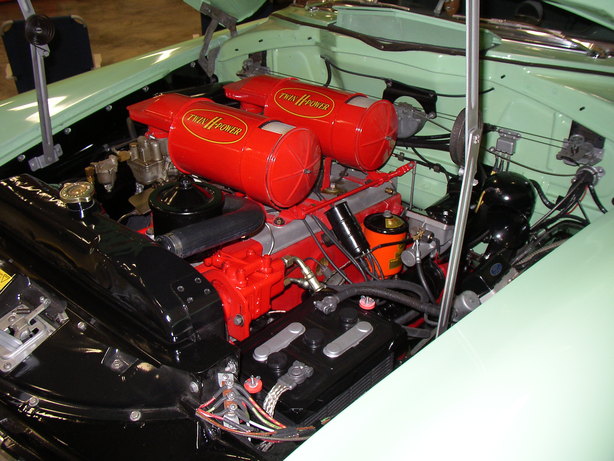

Can anyone enlighten me as to what the CORRECT Twin H air cleaners are for a 54 Hornet?
I've seen at least 3 different types, and they've all been mounted on 54s. They can't possibly all correct, could they?
The first type has the large perpendicular canisters on the end, which I assume are oil baths? (I also assume these would be the earliest type? Yet I've seen them on lots of 54s online?!)
The second type has a more conventional metal mesh/fabric/paper filter element right on the end, and is squarish where it connects to the carb (I would think this is the correct one for 54)
The third one is very similar to the second one, but is rounded/curved where it connects to the carb (people on eBay seem to indicate that this is for the 55 Hornets)
Thanks!

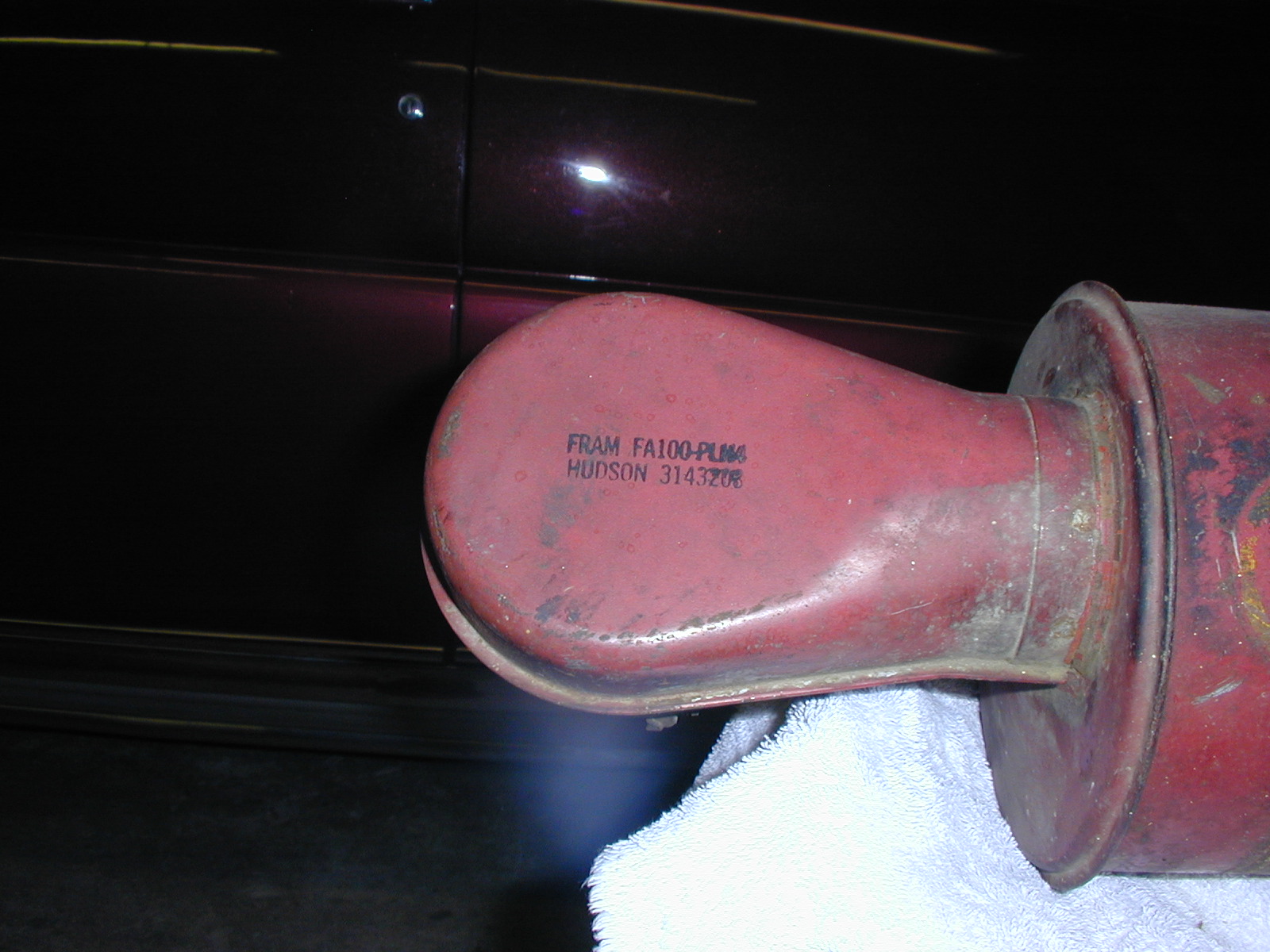

I have two rounded end Twin H canisters with paper filters on my 1953 Super Wasp. I was told the Twin H setup was added to the car by the dealership (Mutto Sales, Belleville, IL) in 1954 (along with a whole bunch of other dealer accessories) as a means to help finally push the car off the sales lot.
Of particular interest, the Fram air filter care instructions on each of the canister decals read at the very bottom, "Hudson Motor Car Co., Detroit, MI." No mention anywhere of American Motors.
Could be that Hudson made these rounded end Twin H canisters available to dealerships prior to AMC introducing them on the 1955 6 cylinder Hornet and Wasp models.

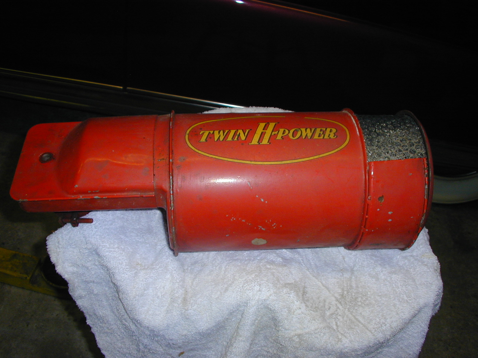

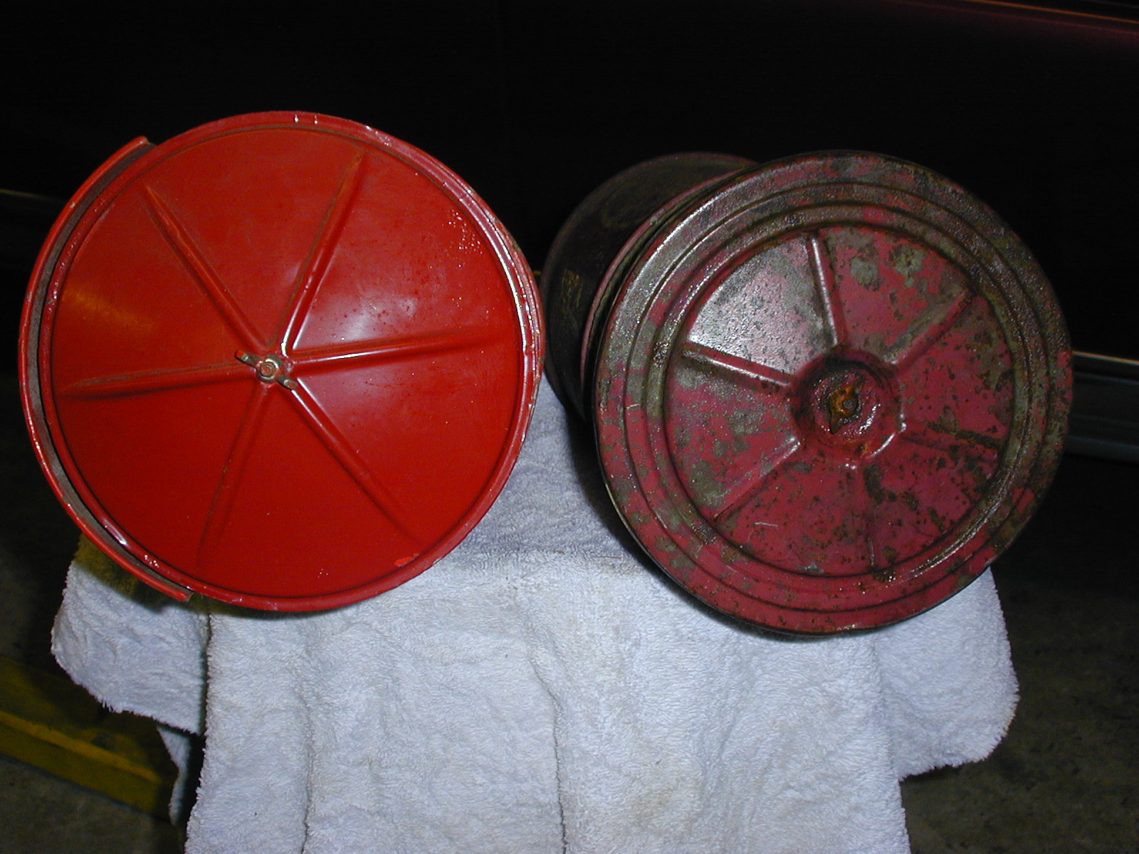

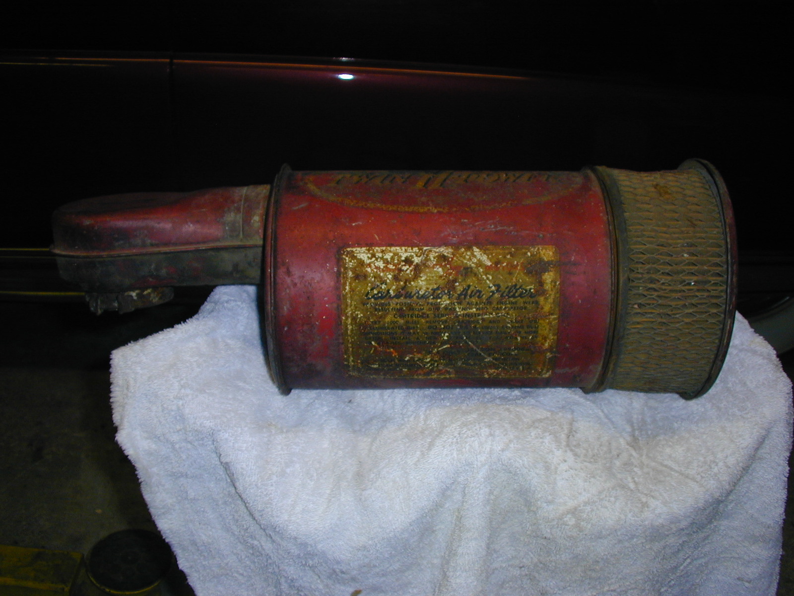

just for the heck of it. I took some pics of the two different filters. The late or "hash" are original and not modified as far as I can see. All decals in original position. The stepdown ones have been painted with wrong shade of red and someone has drilled a hole above the carburetor to prime the carb. Decals are also in wrong place. note that even the end caps are different.0
