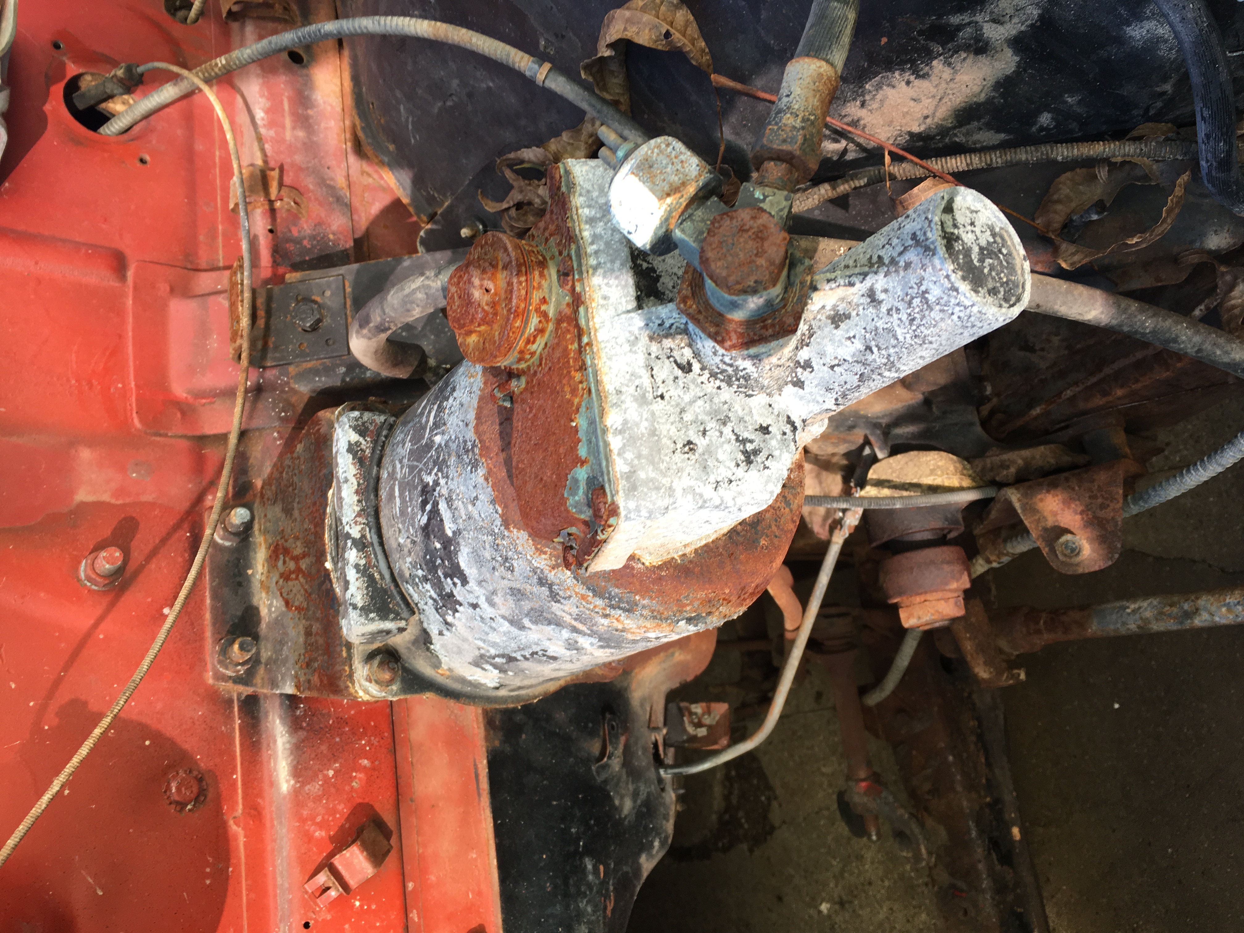

Does anyone have an idea as to what master Cylinder this might be? I haven't seen one like it before and need to get a rebuild kit.
It's a Bendix Treadlevac. Google it. There are kits available plus rebuilders. A very different MC for sure.0
And there is the answer. Thanks, that is an odd booster for sure. I am thinking I may just replace it with dual circuit power master cylinder rather than rebuild the thing as they seem to be both expensive to rebuild and rather strange.0
Rather than a piston and seal that pushes the fluid.. They use a piston that displaces fluid. They seem to work OK when properly rebuilt. I think GM used them back in the day also.0
