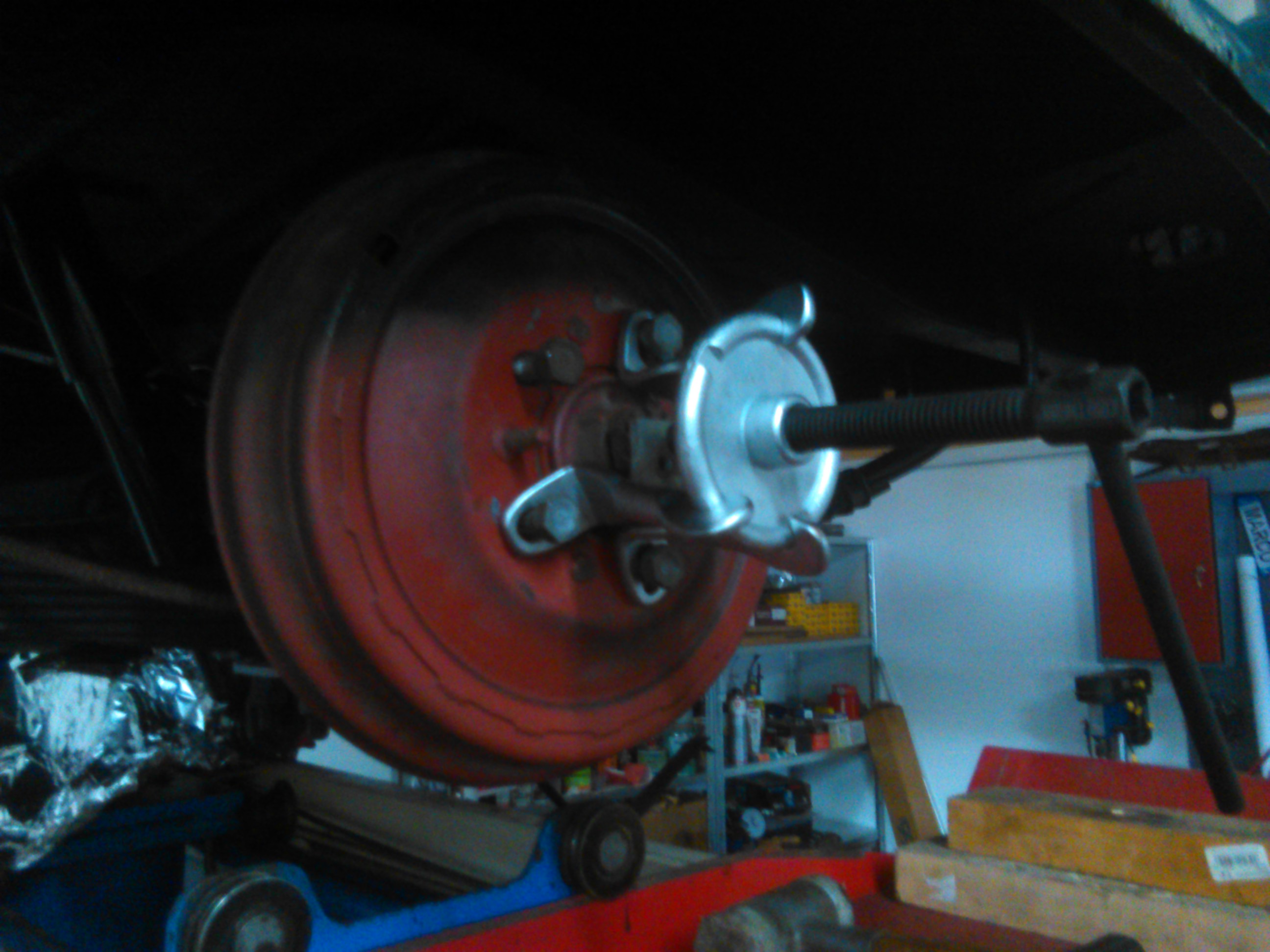

Are you using the correct puller?
http://hudsonrestoration1948-54.com/index.html Go to this website, on the left side select "brakes". On that page select Stepdown brake drum removal and you will find a pictorial description of how to remove rear drums.0
Oops, looks like this nut has taken the axle nut all the way off. Bad plan, as when this thing breaks loose, it'll take off across the garage, maybe you with it. Just loosen it 1/4 inch or so until it breaks loose.0
And damage the thread in the process.0

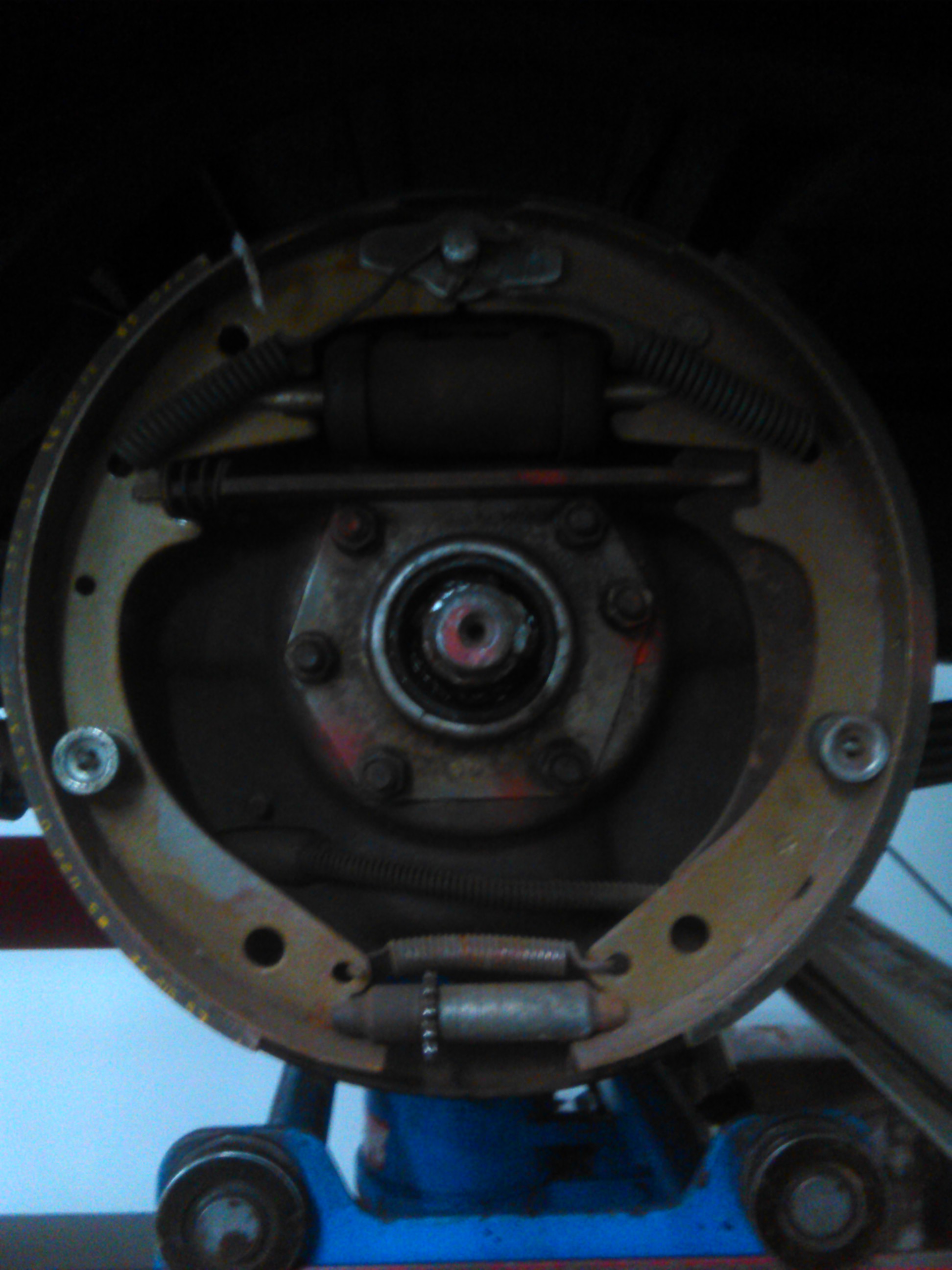

...new brake linings in it....and it looks really clean. Brake drums look like new. Thank you Kenneth for offering me sending a puller. Never needed a puller for the brake drums on my other cars....Thanks0
....that is because your other cars probably didn't have tapered bearings!
Wow, that puller looks nice foxsnout, where did you get it?
That "T" increases the price by a factor of 6 or more.
