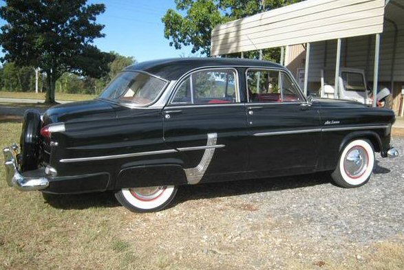

54 Super Jet for sale in Georgia CL, now in my driveway
After owning 3 stepdowns, I am ready to try out a Jet. I found this one in the Florida, a 4dr. black Automatic Trans with red interior. Craigslist http://atlanta.craigslist.org/nat/cto/5906068200.html
in Cleveland, Georgia. The owner seems a bit elusive, doesn't want to talk on the phone, but we got to emailing.
He refused my request to have a local mechanic (at my expense) do an inspection, saying that he had done that in the past and they 'messed up' his car. He agreed to do a compression test, and the results sent to me were 64 - 67 psi.

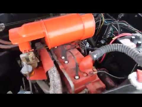

While doing research on '54 Super Jets, I came across this video, of which he made no mention.
https://www.youtube.com/watch?v=mdxjNnsFq-w I find it odd he did not direct me towards this video as a potential buyer.
https://www.youtube.com/watch?v=mdxjNnsFq-w I find it odd he did not direct me towards this video as a potential buyer.Does anyone have any knowledge of this car's history ? Or tried to buy the car ? When I emailed him that the

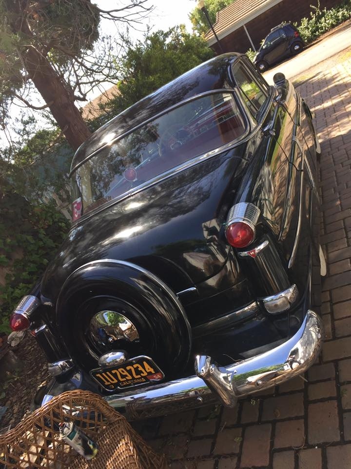

Here's one more pic, more to come. In California we can get 'Year of Manufacture' plates, if you have a set (I had a set). I did buy a Red-rad, just need to hook it up. I don't have an ipod, so need to get something to play mp3's.
