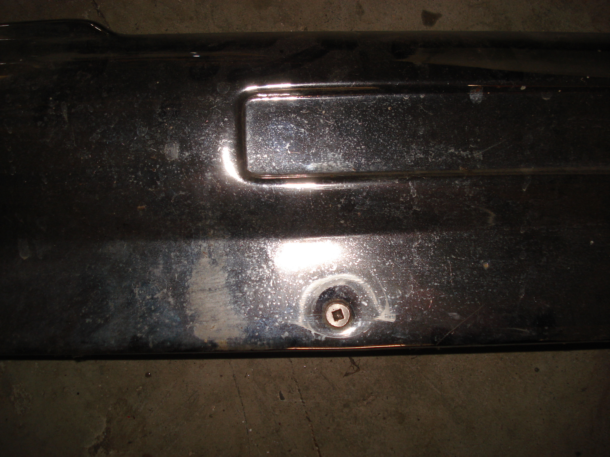

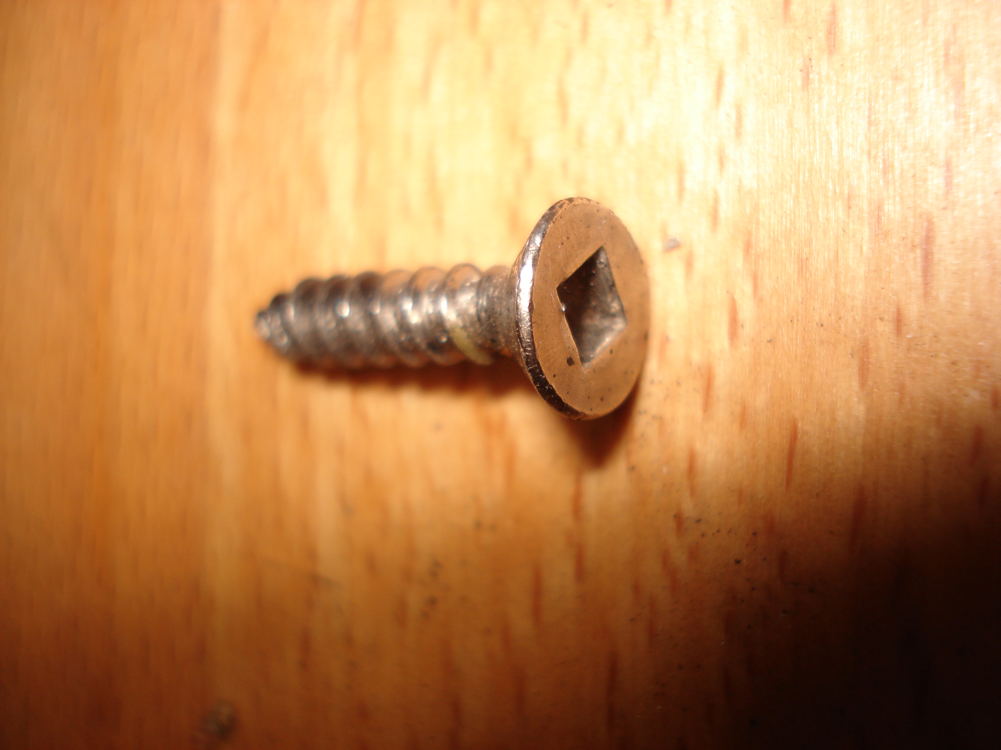

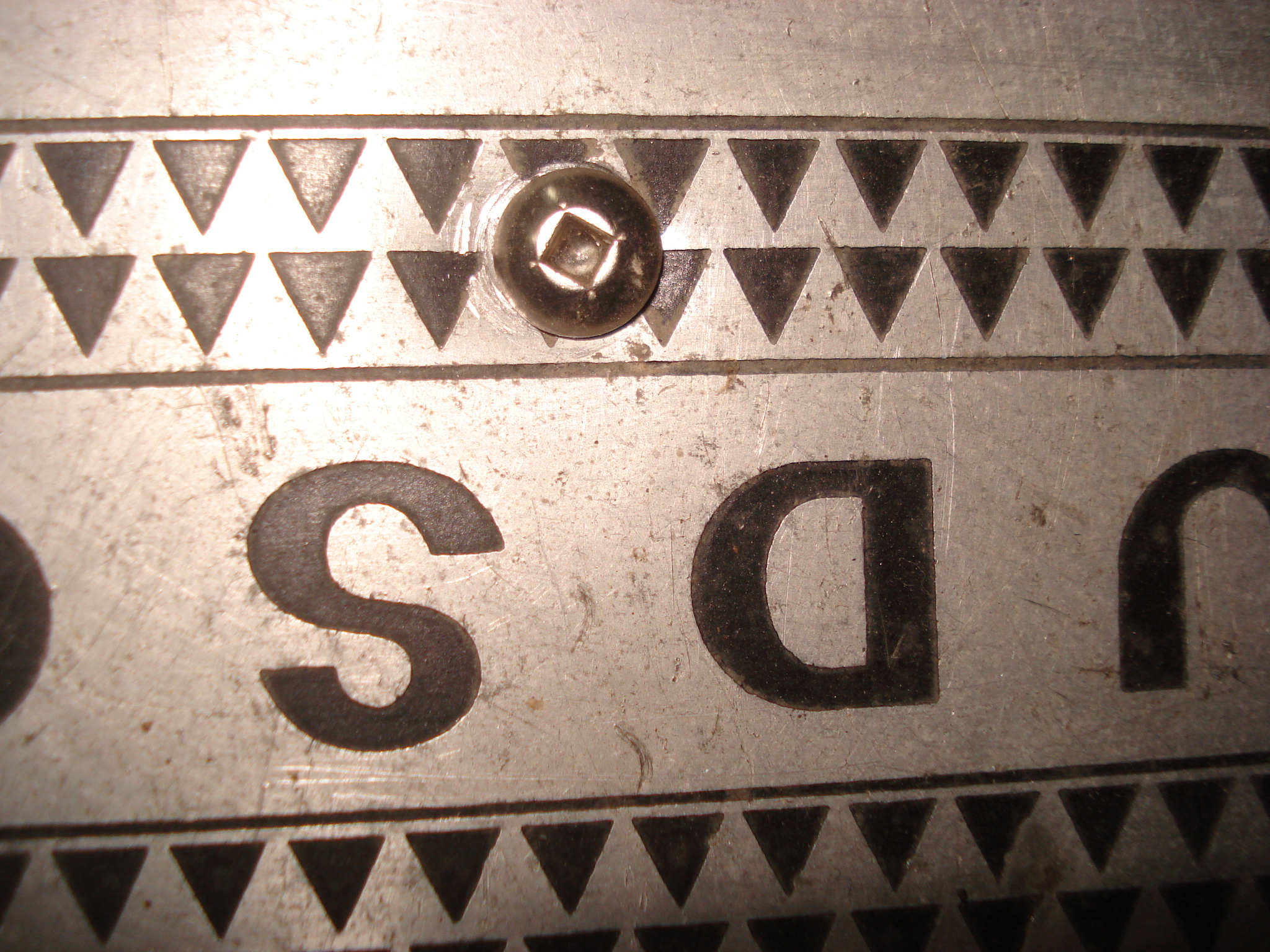

I´m wondering if some of the screws on my 52´ Hornet have the correct style...on my Hornet they were used e.g. on the door sill plates (domed) or for the chrome facing on the rear (flat ones here). And what about the taillight housing? Does anyone have a picture of the correct screw style in these places?
Thank you so far, Marco
Marco, Those are NOT the screws Hudson used when attaching the thresholds . They used a chrome plated truss head sheet metal screw with a #2 phillips head recess. The ones you have are Robertson head screws. Very popular in Canada ,not so much in the states.0
Thank you...i thought so. Yes, phillips heads. I will change that! Any pictures?0
