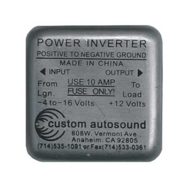

Don't they make an "inverter" for changing 6 volts pos. ground to accessories with 12 volts neg. ground? If that's so, one could simply plug the modern 12 volt accessories to the inverter and leave the rest of the car's electrical system alone.
8 volts will make all the bulbs go black eventually. Or burn out. Better to keep you system maintained properly with all tight and clean connections, and adequate wiring.
Is this like a perpetual motion machine? (just kidding!)Jon B said:Don't they make an "inverter" for changing 6 volts pos. ground to accessories with 12 volts neg. ground? If that's so, one could simply plug the modern 12 volt accessories to the inverter and leave the rest of the car's electrical system alone.
yep, burned up two of these things. They may work well for a very low powered radio (I would not know). I do know a good base note from a low powered external amp lets all the magic smoke out.
