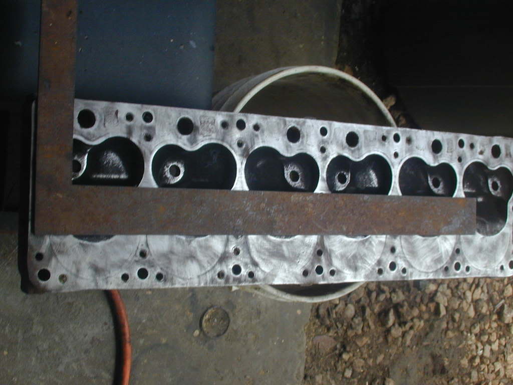

Early (narrow block) 262 engines had some early failures of # 6 rod bearings. The cure was to enlarge the combustion chamber on #6. The problem never reared it's head after the wide block was introduced in 1951.
have a picture of the "revised" 49 262 head showing the larger chamber.0 -
The recent hand-written articles by Bernie Siegfried outlined this problem, and it was the rear main bearing that was failing. Interesting that it went away with the re-designed block. Misalignment? Distorted casting? Weakness in the casting? So perhaps best left alone after all.0
