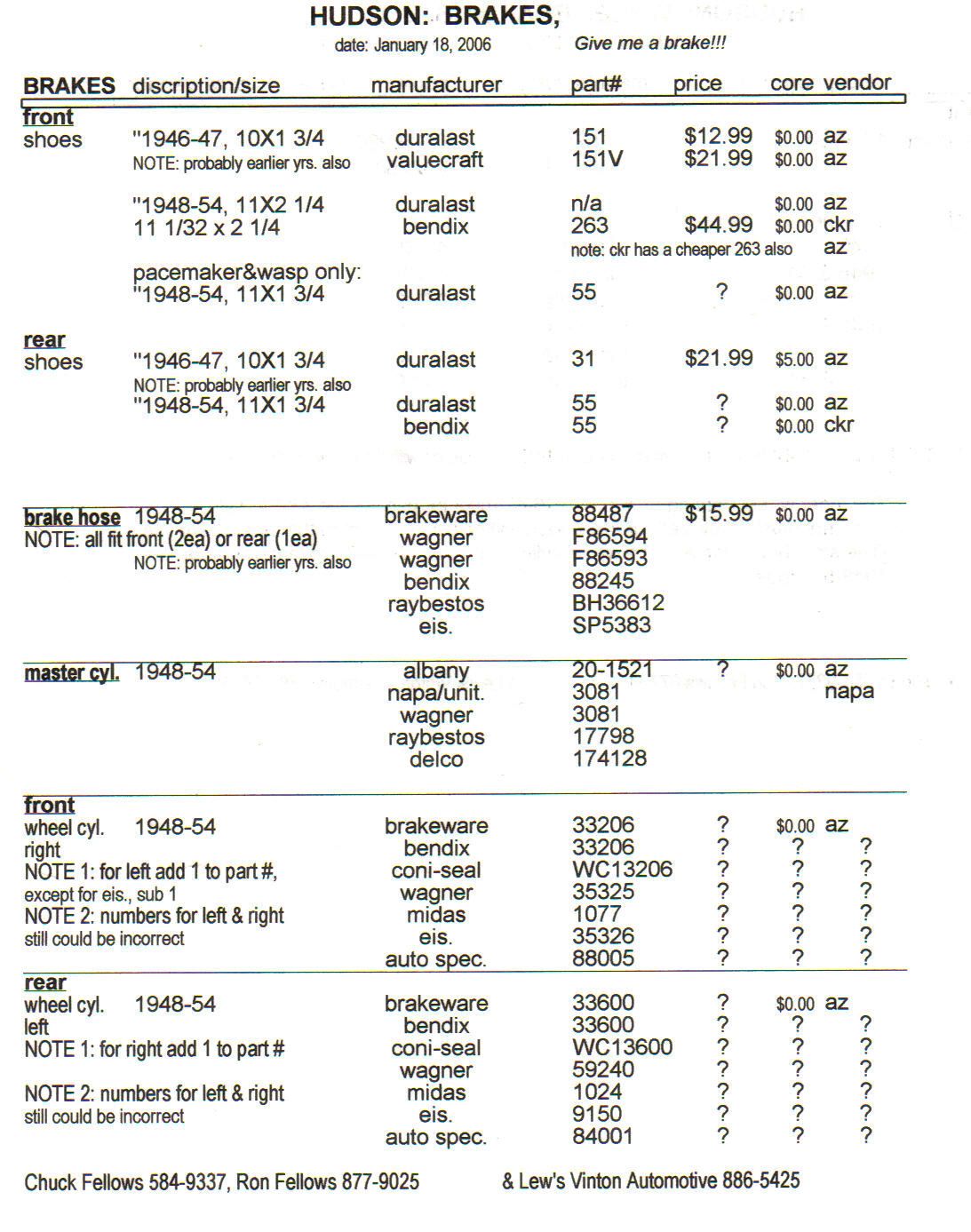

Looking for application or part# for rear cylinders for my 51 Pacemaker or verification on what I found. I researched and found that cylinders from a 1971 Ford Thunderbird are the same size(15/16. These also fit other Ford models plus AMC, Jeeps, Nash & Hudsons 1956,57 plus more. So I purchased a couple from Auto zone, compared them to original and they look OK. I mounted one and then held a shoe in place and it centered OK on the cylinder. The only difference I see is the line screws directly into the cylinder where the factory one has a short brass fitting in the cylinder that the line screw into. Any one tried these or? My original can be rebuilt but the pistons are kinda pitted and rough. My years of being a mechanic tells me this will work but I am probably just second guessing myself.
My Hudson Restoration Website has this listing... I do not have a Hollander that will show your find to those posted. But this may allow you to confirm your selected part. Merry Christmas Ken
Old Farmer, thanks for your reply, the 33600-601 are the # cylinders I got at Auto Zone although when I got there and gave them those #'s from their web site they had a different # but on the receipt it show both #'s. I will save your website for future use0
