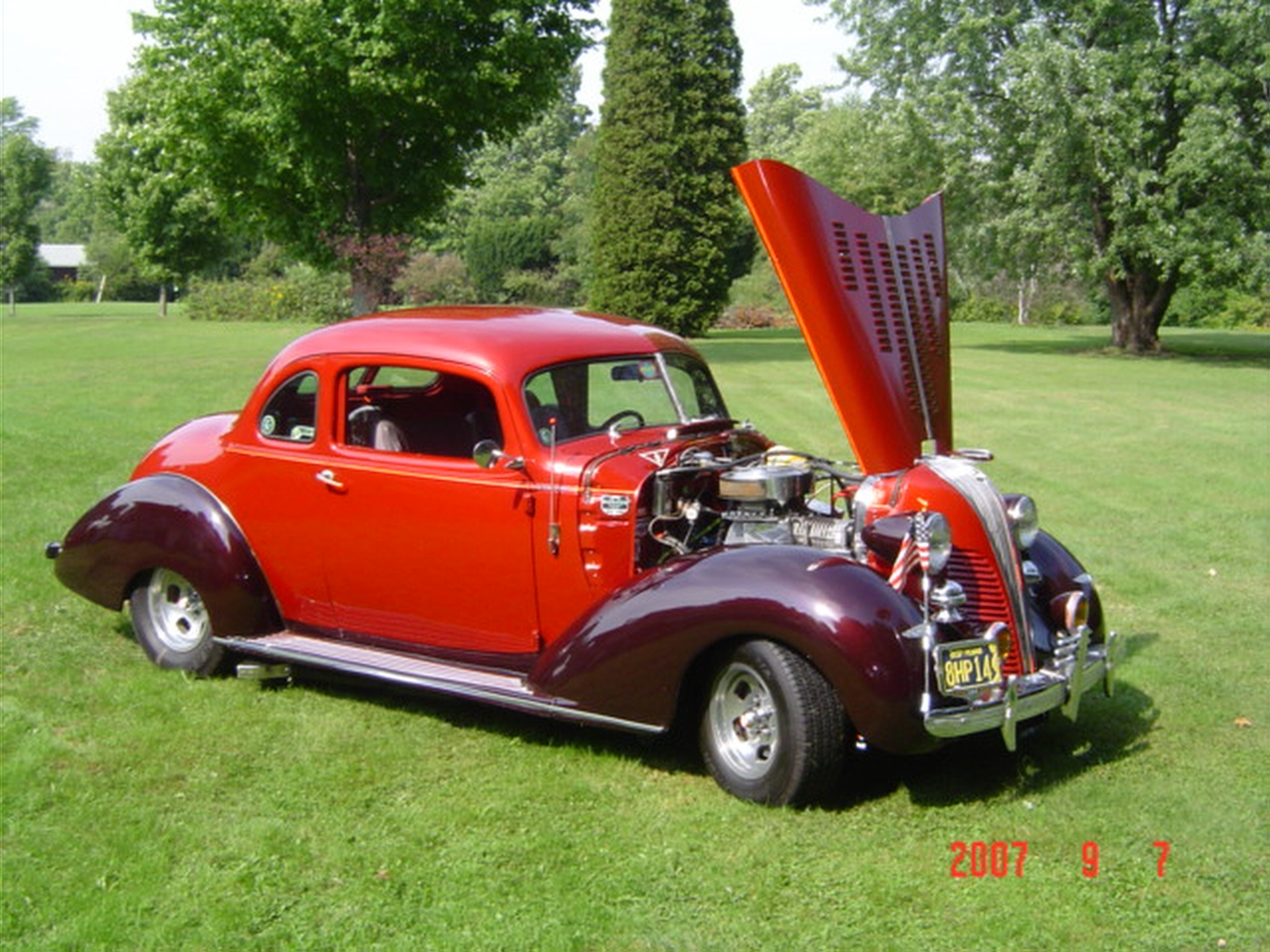

I put a Hornet Mtr with automatic into my '37 Terraplane by trimming the firewall slightly then notching the frame under the radiator for Damper. Looking back, even though avid Hudson guy, it would be easy to put in a SBC or V6 with an automatic. You would also need to change the rear end gears with an automatic.

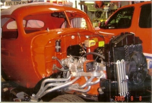

I put a 308 in my '37 Terraplane with automatic, I only trimmed the firewall slightly at the middle above the floot board (black insert) then notched the crossmember under the radiator for the Damper pully. Additionally, I slid the radiator forward and use an electric fan in front of the radiator.
Nice work, looks great! Do you have a pic of the finished products.0
The '37 has a modified Hornet, Turbo 350 Trans, and narrowed Ford 9" Sure-Grip along with all modern car Power accessories...0

Thanks every one. Work continues to go smoothly. Off to the you pull it for a transmission this weekend. Going with electric fans instead of the original due to lack of space. Have to move compressor and alternator up high for clearance and move the battery box back to get it away form the headers. It is a steep learning project.
