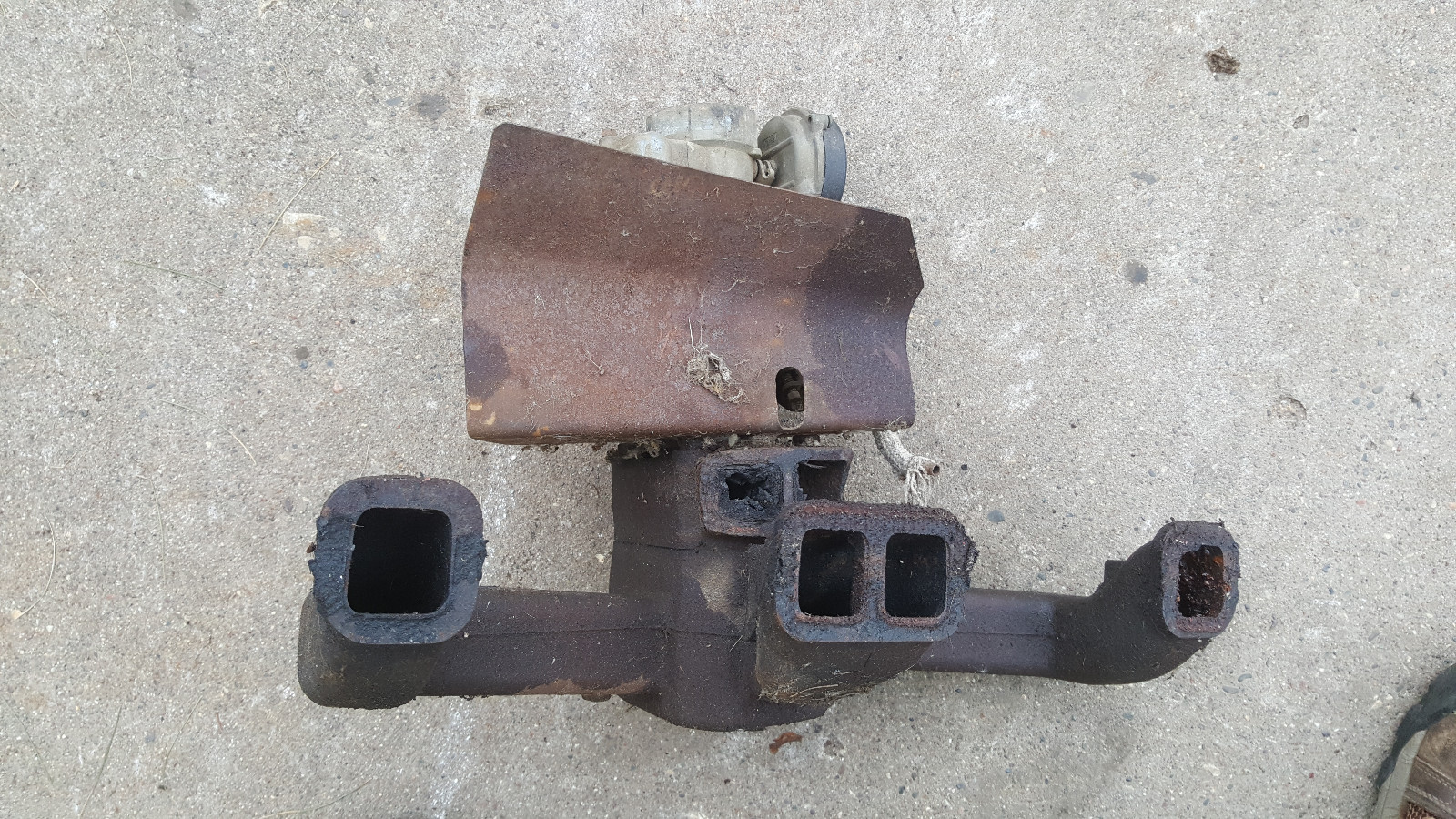

I have long suspected the parts of the 202 were parts used in the larger engines. Hudson was trying to save money at that time and cutting corners. Why develop something new when you already have it. The 202 looks to be a recast of the 8 block. The give away is the intake ports. It has 4 intake ports. Four cylinders are have a shared port and 2 cylinders have individual ports. They chopped two cylinders out of the center of the 8 block. It took Dale Cooper over a year to find me bearings for my engine. One will have to take what you can find. Harris and Kanter does not have any the last time I checkes. Keep looking some will turn up somewhere. Good Luck. LHud0
That is a myth. The 202 was a completely different engine, newly developed. The only relationship to the eight was the bore size and the connecting rod length, which is tenuous to say the least. There are three inlet ports on the 202, and n o similarity in the castings at all. The Jet main bearings are the same diameter, but shorter in length as the bigger motors.0
Intake manifold for the 202.
Point taken, but there is absolutely no resemblance between this and an eight cylinder manifold. On the eights the larger portion of the manifolding is within the block and the exhaust manifold sits on top of the block. The 202 was a completely new engine, and a good one, but it just did not fit in with the times.0
