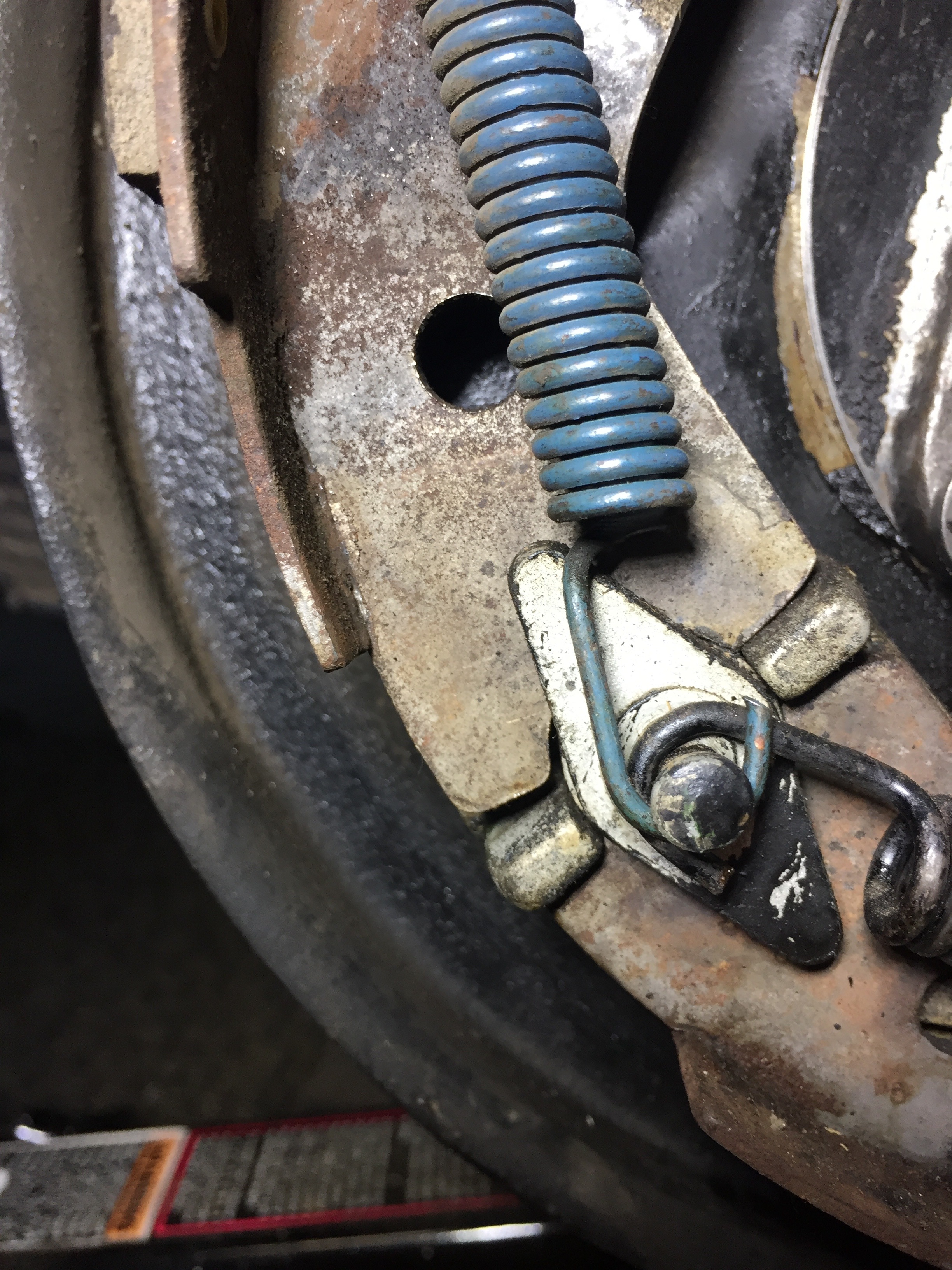

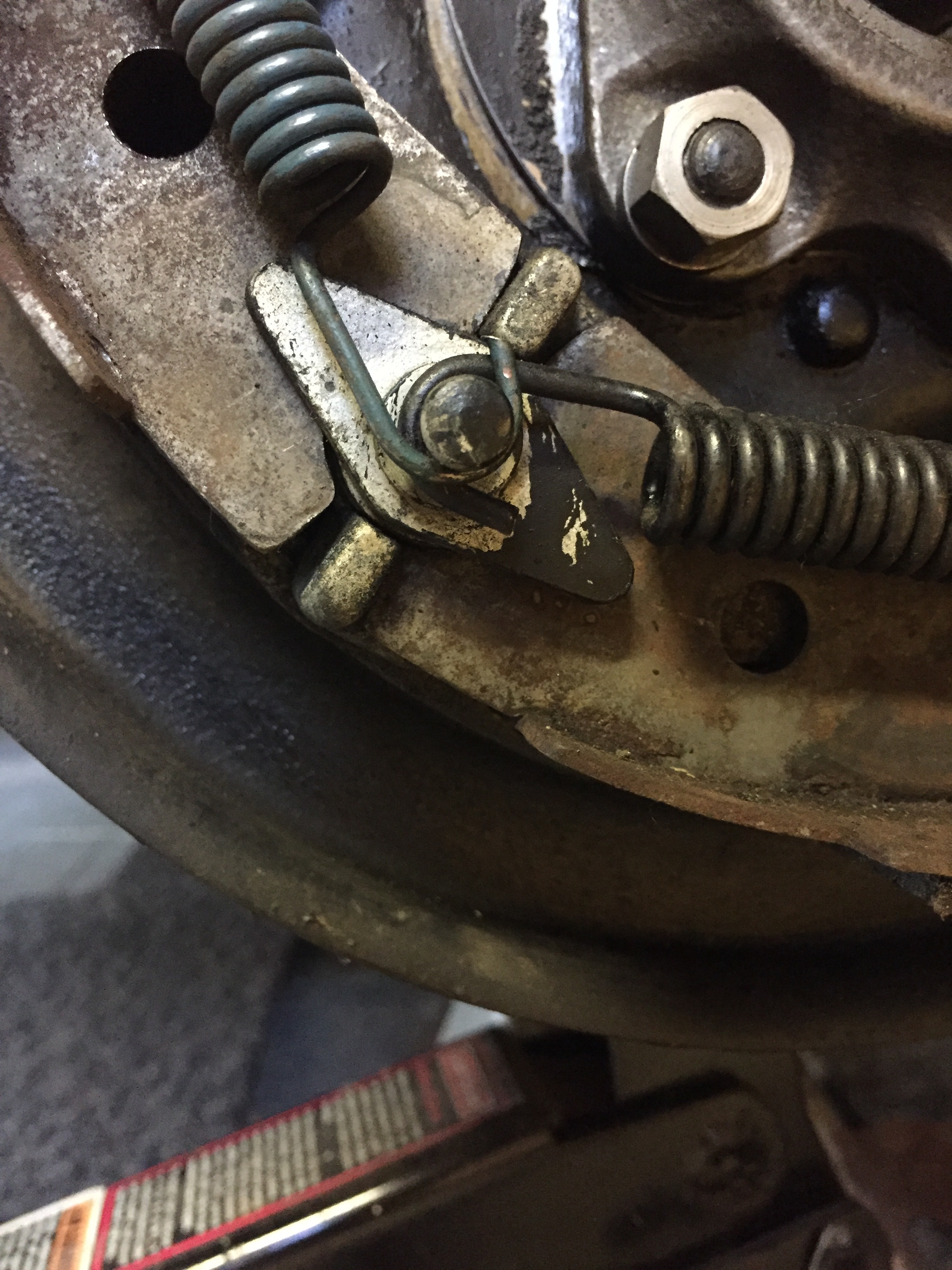

Hi Everyone,
After finishing the rear bearing & seals and putting the drum back on I checked the clearance between the shoes and drum thru the inspection hole in the drum. With the star wheel all the way in was getting 0.010 on the upper rear shoe and about .10 on the front lower shoe. Took it for a test drive and noticed the car pulling to the right when I applied the brakes.
Got home struck my finger thru the slots in the wheel and the drum was hot. Checked the other three drums and they were cool to the touch. Took the drum off and had my wife push the brake pedal. Only the upper rear shoe moves. The ends of the shoes do not touch evenly on the anchor pin. The manual all in caps says don't adjust the anchor pin unless necessary. Any suggestion on possible problem OR solutions. Was wondering it the anchors pin needs cleaning and lubrication.

Well, that was before the generic brake shoes you get these days, where the half-circle for the anchor pins is lower. Walt Mordenti highlights the problem and the solution in his tech booklet. if the pin is not concentric with the shoes, you have to move it, like loosen the nut, take up the shoes and tap it with a hammer. If that doesn't lower the pin enough, you have to grind .050 out of the bottom of the pin slot. Just had to go thru that on a 47.0
Thanks Larry
I bought Walts Tech Tips a few years back. Forgot he had the write up on the 35 brakes. Just read thru this Tip. Didn't see anything about grinding the anchor pin hole out in Walt's TIP but I think I get the idea. When I pulled the drum off again I noticed the blue spring toward the rear appears slightly smaller than the black spring toward the front. I plan to take them off and test with a spring scale to see how much force is required to pull each say 1/2" to see if they have different spring rates. The springs are also anchored in a different holes on the shoes. Could be the last person who did the brakes on this car didn't have the correct springs. I have four brake springs I bought 4-5 years ago off Ebay that were sold as 35 Terraplane brake springs. You know, just in case I ever needed them. They appear to be the same as the black spring toward the front. Will test these as well and see how they compare to what is currently installed.
