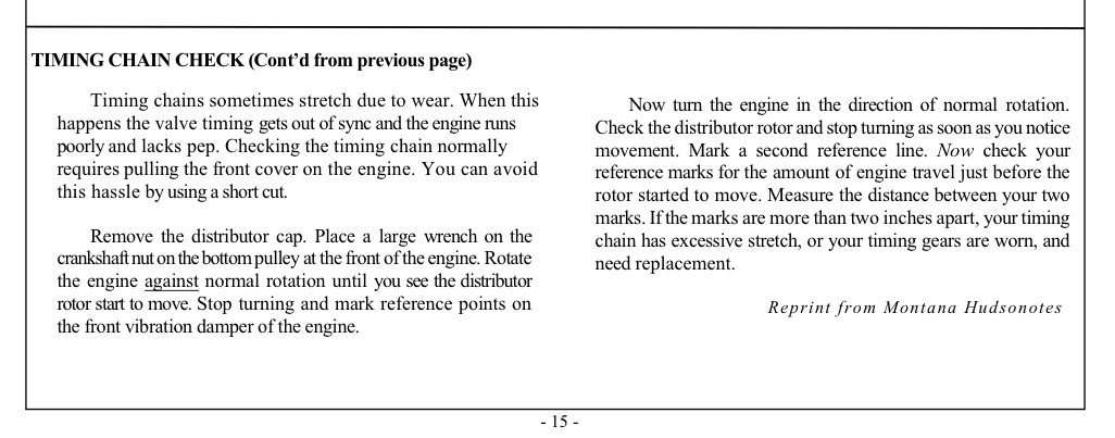

Attached is an excerpt from tech tips provided by Larry Cramer which are posted on my website.
Thank you! I will try this timing chain check and see about rebuilding the carb.0
