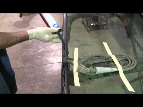

YouTube video I watched in preparation
https://www.youtube.com/watch?v=vr7Prioj9Xo
notice they used 3M 8509 sealer / urethane on outside once windshield is installed.
Note to me from Doug Wildrick--Hello Kerry. Well, the big deal was sealing it in and doing it so you didn't get sealer- butyl ] on the headliner. Just installing it is rather easy. If the headliner still needs to be replaced, it is just as well you didn't seal it in. If the headliner is OK, and still somewhat presentable, then you might want to seal it. Using a tube of butyl, which is pliable and doesn't set up hard, NOT urethane, apply it around the edge of the rubber. I have been using a plastic door panel tool to lift the edge slightly as I apply it. One of the big things that creates a problem doing this is the stainless molding. One of the things that are absolutely necessary is to clean the stainless molding to perfection on the inside, and then glue it to the rubber before installing the glass. The book describes this, but doesn't tell you to glue it. We use black 3M weatherstrip adhesive, and after we have installed it, tape it in place on the glass and let it set overnight. After you have installed the glass back into the body, use the butyl to seal around the outside edge, like described, lifting the edge of the rubber slightly to apply a thin bead on it. Once that has been apply, carefully pull the tape off, and using wax and grease remover, clean any extra butyl off. With the outside now cleaned, take the butyl and slightly lift the inside rubber, apply a thin bead there, wipe off clean. After you are done, you will see the butyl sort of skin over.
A tip on how to use, you can push the butyl down into the grooves and/or voids using a rag to work it down in there. Make sure you have your box of gloves close.
Originally they used the butyl in the pinchweld groove of the rubber, and is common to find some butyl in both upper corners between the glass and rubber. I'm almost sure they had an install fixture, which was probably a simple clamp that compressed, thus opening the inside flap open, then they set it into place, pulled the fixture off on the inside. I have done countless back windows and have never seen any butyl on the headliners, just perfectly applied in the pinchweld groove.
