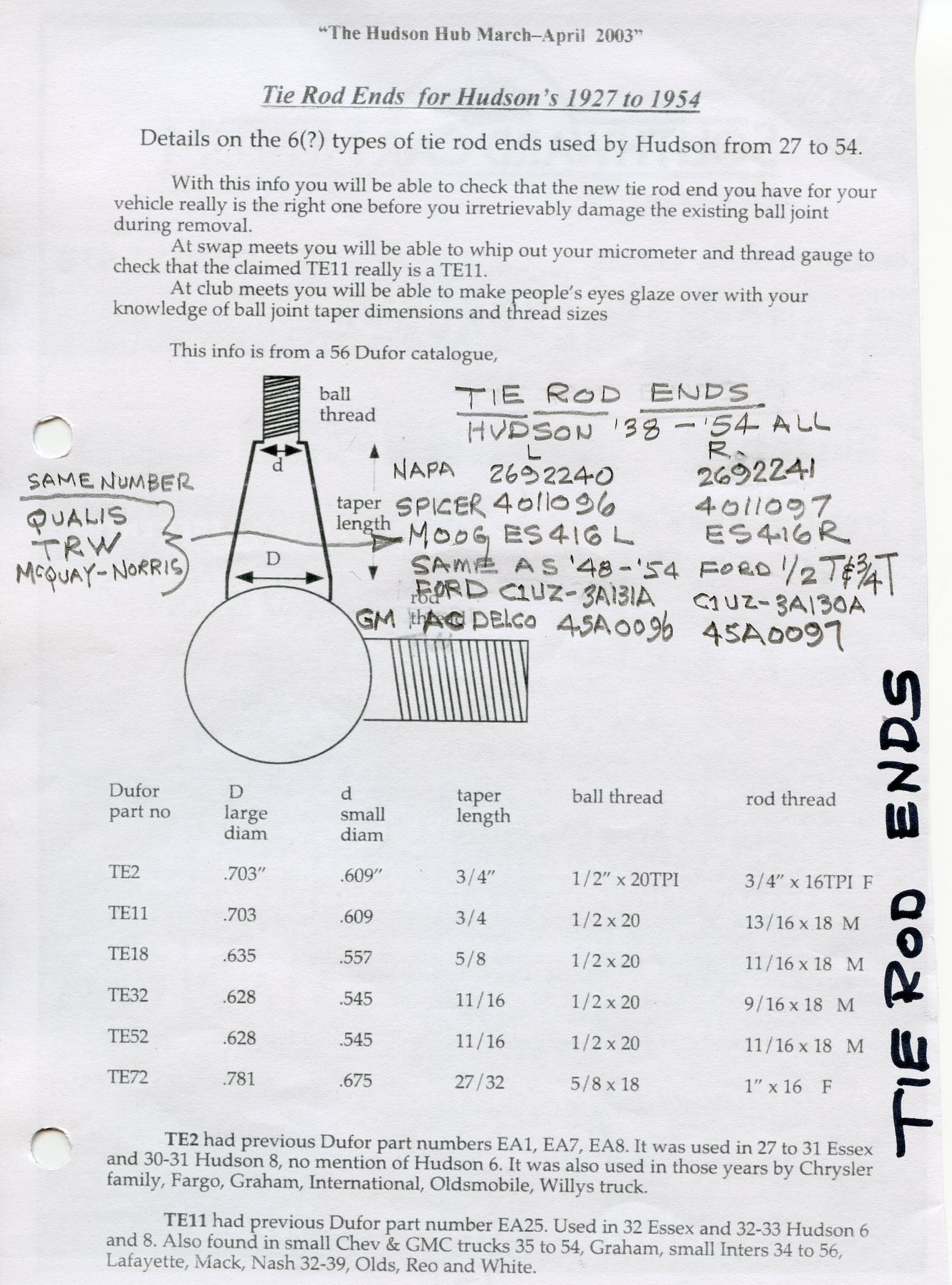

I used ford tie rod ends on my 38. The taper is longer but the same taper. I might be able to find the part number if you need it.0

Bob Ward first saw this info I believe many years ago .... when he wrote it. There is a page 2.0
