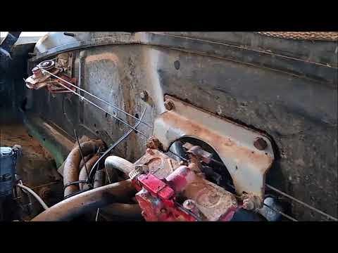

I've been tinkering...this morning, I decided to see if the wiper motor would do anything. I fiddled with the control cable and got it moving ok, and adjusted. I put a bit of oil into the motor, and lubed the wheels that the cable rides on, and after some manipulation, it seemed to be moving ok. So I put the hose back on, and started up the engine...
