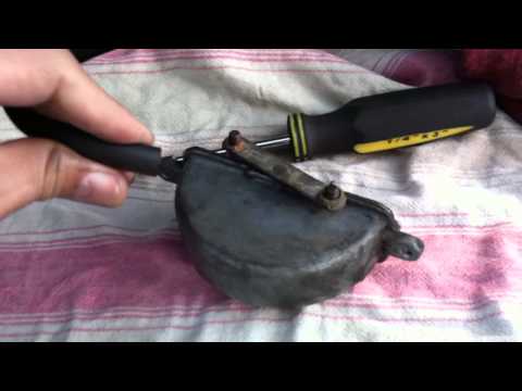

Here's a YouTube video of someone's 1940 Nash Trico vacuum motor getting a lube job:
https://www.youtube.com/watch?v=UQ_MMKfhSwM 0 -
So I see they use brake fluid I did that last fall and my wipers did not work this spring I just used three in one oil and that got them going I was just wondering what everyone else was using0
