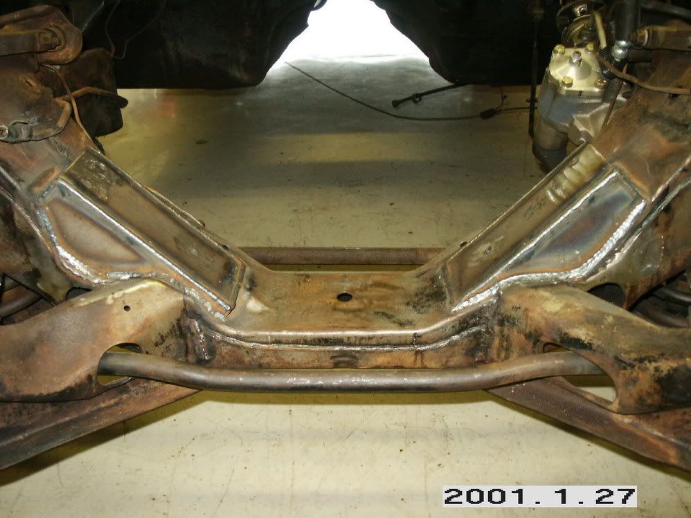

Geez Dan, I throw a blanket down too except when I get in a hurry. :rolleyes:
I probably mop it 2-3 times a year but there is nothing that I won't do
because of the floor finish,Actually I think its the best part of my shop.
$$ well spent.
[IMG][/img]
BTW, its pretty dirty in this pic,still I don't need a creeper to slide under
anything.0
