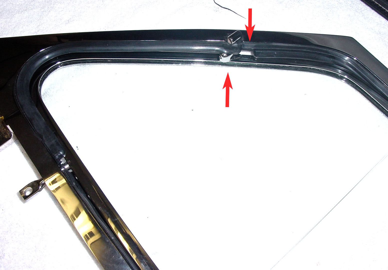

Did you have this problem with gap for the window hinge being in the wrong place? As you can see from the pics, it is about 3/4" off. I am tempted to just trim the outside portion, but I am concerned about the outside part allowing air in and whistling. Perhaps I am worrying about nothing. Still wondering why it is off. Maybe the converts are smaller, or maybe I got the wrong seals?????
Anway, for those who have already installed this, can you give me some feedback?

convertibles and hollywoods have a different vent window profile than the closed cars, perhaps you were sent the wrong rubbers.0
I don't know about a '49 but I put them in my '54 coupe and there was a piece of paper in the bag, saying that they may need to be trimmed slightly to fit. I have had no trouble with mine, 5 years now.
