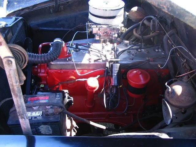

While I have been taking alot of time working on the stroker project, my Dad lost patience and started a rebuild of his own using the good parts I had that weren't slated for the stroker project. Of course I got involved, I wanted a stock 308 for the Wasp anyhow.
As usual, the engine needed alot of attention. New Dale Cooper pistons, bearings, gaskets, stock valves and guides. Nothing fancy on the interior besides holding some tight tolerances on the machining. The machinist we've used several times in the past didn't let us down. Its not a ground breaking build by any means, but Hudson through and through.

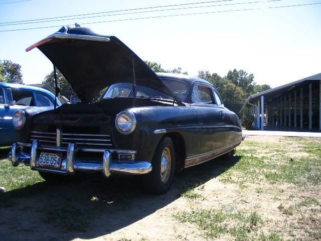

Our goal was to make the Redneck Roundup, which was this past Saturday,a local show for pre '64 cars that pretty much caters to the Do it Yourselfers etc. The '49 isn't pretty, but it sure does run good. I had lots of visitors and they came to see one thing, which we didn't disappoint them - they wanted to see a Hudson flathead engine. We had one for them to see!
We drove the new engine to the show, it had just fired up on the Thursday before. Purred like a tiger all the way there and back. The Headers sound nice.

Is that an early 2 barrel aluminum hudson intake (48-49) with a 4 barrel on it?0
hudsonkid wrote:Is that an early 2 barrel aluminum hudson intake (48-49) with a 4 barrel on it?
Its a really early Clifford 4 barrel intake. It actually has "HUDSON" cast into it and was cast with the appropriate bosses/flanges to be mounted on an original exhaust manifold.
I think Jack was trying to blow one by the NHRA inspectors at the time. Hence the "HUDSON" rather than "CLIFFORD".

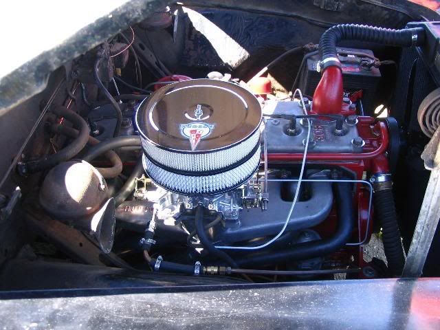

Hudsonator, Are you running a 500 or 650 cfm Edelbrock 4 barrel? I want to do this conversion on my wasp and just about have all the major pieces.
How's it run with this setup?0 -
hudsondad wrote:Hudsonator, Are you running a 500 or 650 cfm Edelbrock 4 barrel? I want to do this conversion on my wasp and just about have all the major pieces.
Its a 500 cfm Performer, Model 1404. It came from JEGS, they went on sale with rebuilt 500's selling for about $150.00 just after I ordered this one.
It runs GREAT. I would advise buying the jetting kit for it when you buy the carb. I also had float height issues "out of the box", which caused it to flood and leak fuel into the primary venturis after you shut the engine down.
I have rejetted it 4% leaner in the primaries, with a little more to go. The rejetting kit comes with all the metering rods, primary jets, secondary jets, and step-up springs you'll need. The carburetor itself comes with one of the best owner's manuals I've had in my hands - ever! Its comprehensive and makes jetting changes very easy to understand. Most of the jetting changes and all the step-up spring changes can be made without taking the air horn off. This has become one of my favorite carbs to mess with, I only wish I had come in contact with them sooner.
One more thing about using these on a Wasp. This engine will eventually make its way into a Super Wasp much like yours. The linkage you need is for the single WA-1 from either a Wasp 232 or Pacemaker. They have a fulcrum that is stock, integral to the coil bracket, and pulls across the head. If you'll look at the pictures of my linkage and carb orientation, its a "pull" outfit. The Super Wasps have a "pull down" linkage in the center of the engine just rearward of the coil. On a Super Wasp, this pulls the WGD linkage and causes it to rotate similiar to a Hornet. On the Wasp/Pacemaker with the 232, it pulls down on one leg of a fulcrum that causes a rod to pull across the head and tug at the WA-1. So, all you would need to do is replace your current coil bracket with the one from the Wasp/Pacemaker with single WA-1 and fabricate a rod to go from the fulcrum to the carb. Easy-peasy and All Hudson.
One of these days Jim Guinn will send me the Pacemaker WA-1 linkage to do just what I've described to you. In the meantime, and until the stroker is done - I'm gonna run this engine in the '49!
Its really strong and torquey, a very road mannerly engine. I'm getting 15 mpg out of it with a 4.10 rear gear and non-OD. I think that could be improved on, as I'm not finished with the jetting just yet.
