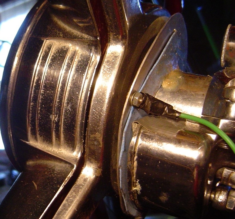

On at least one type of electric steering column, the horn wire cannot be used (with the regular horn button). Button must be mounted elsewhere. I don't know if this is true of all the electric steering columns.0
There is probably a way to run it thru. The electric motor is spliced into the column. I am going to experiment with doing it the next time I work on one.
FYI
On my electric steering I didnt want a Tractor horn button so ran the horn wire outside the shaft but inside the column half way, then drilled a hole with grommet to go outside just below & over the motor then hidden inside the U shaped chrome turn signal wire cover (under the column). Then drilled the steering wheel, made a brush type contact down thru the wheel onto a thin insulated plate diameter of the s/wheel hub using turn signal switch cover screws. However, im certain there are other ways too...
