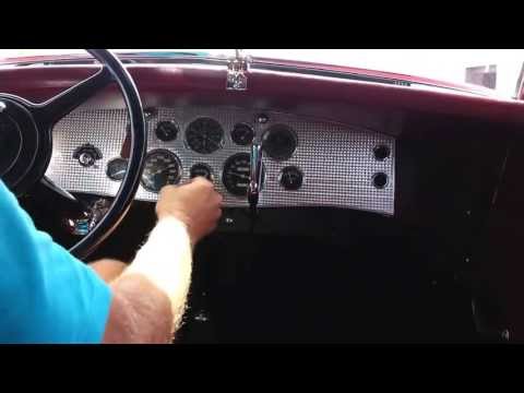

The eight was only running on 7 cylinders or less - you can see in the video that the front cylinder plug lead is off the plug!My 212 sounds clattery like yours, it had very worn lifters with troughs cut in them which I replaced with a refaced set but I didn’t get the cam reground. Still runs great, and the sound disappears over about 2,000 rpm. I have heard quiet 212’s though. Can’t say I agree with Ken, especially as RR bought their own Terraplane Eight to analyse and were amazed at how smooth and quiet the engine was compared to their own engine. This is all documented in James Fack’s book on the Terraplane. There are reasons why the side valve Hudson engines were quiter than OHV engines, mainly because the valve gear was buried in the engine block and not on top of the head inside a tin can cover. Duesenberg engines are horrifically noisy, Youtube has some good in-car videos to demonstrate that.0

terraplane8 said:Duesenberg engines are horrifically noisy, Youtube has some good in-car videos to demonstrate that.Enjoy the noise!
https://www.youtube.com/watch?v=7TaDI4D-xdg
