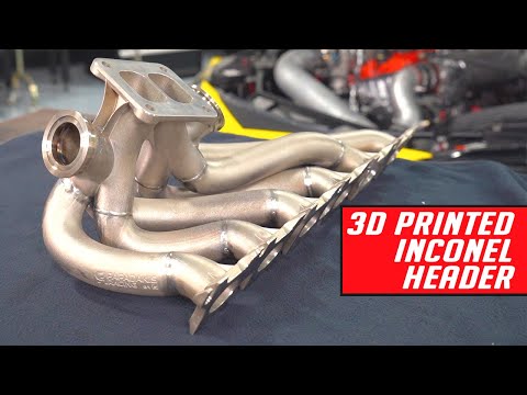

Wow, that technology changes the game!
I want some of those tools. haha0 -
