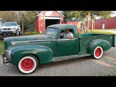

First time this 1941 Hudson BigBoy has been on the road under it's own power in more than 40 years. Going to get a front end alignment. Made it there and back without incident. Phew! 250 Chevy inline 6/ 700R4 8.8 rear from a Explorer.Hope you can see this video on facebook. https://www.facebook.com/100005267387975/videos/2044978622318116/

Thanks! I can't believe how nice it drives on the highway. Smooth ride and tracks/ steers great. And here is a link to a video on youtube.

I love it and am jealous. Beautiful property0
