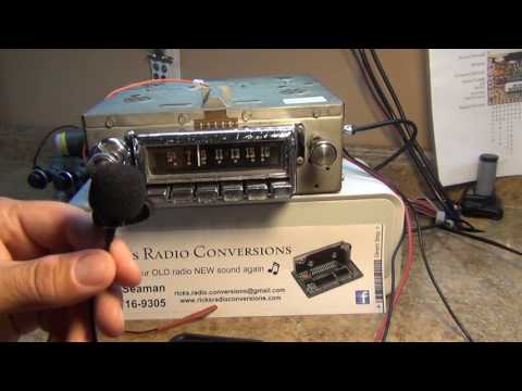

hi - here is the link to what i did in my hudson, which includes my modern solution for the front speaker- i'm really happy with the results, including mixing mono and stereo - the mono rear speaker sound reflects off the rear window nicely, and having the stereo front speakers locates the sound correctly- i also have kept the original radio (converted to 12V) working, and it has a very nice warm tube soundhope this helps
