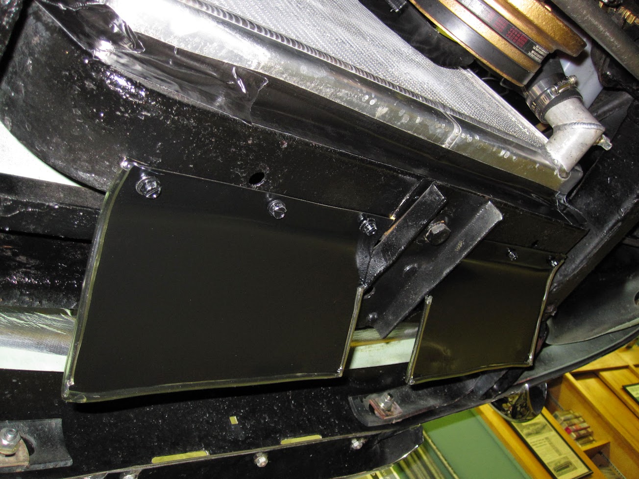

Use Gorilla tape around radiator--anywhere air will bypass it; LOOK AT IT ! The 2 scoops here are to get more air into the radiator. More air the merrier !
