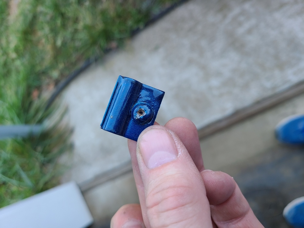

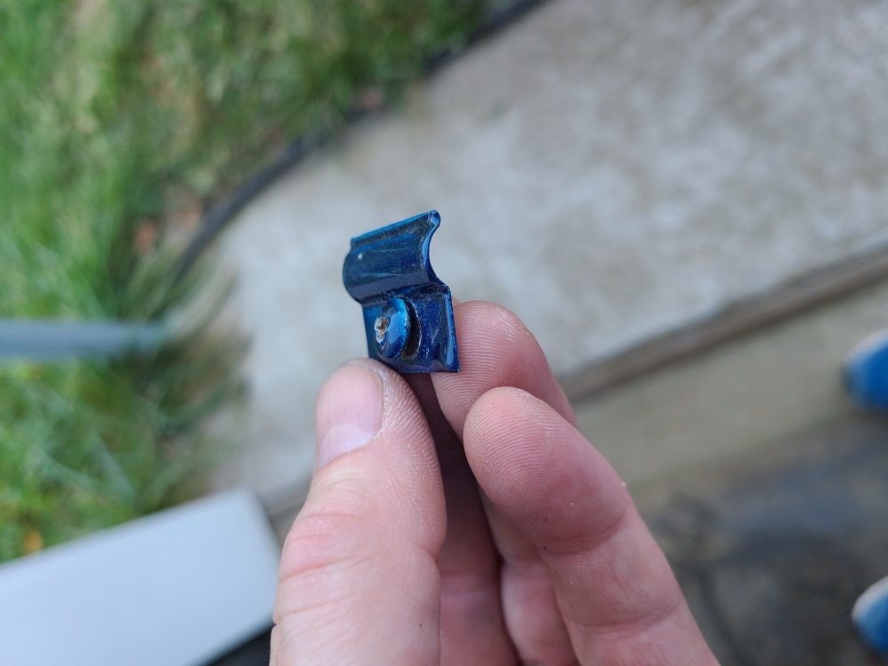

The retainers were totally rusted out. Does anyone have pictures on the retainers used
to attach the rear sail panels?
52 Wasp Sedan

I was unable to locate some for the front windshield trim for my 53 Hornet and ended up using chevy nova rocker trim clips. They should also fit the rear as well.
https://restorationpartssource.com/store/rocker-molding-clip-1962-72-nova-kit-oer-details.html
ratlee2 said:I was unable to locate some for the front windshield trim for my 53 Hornet and ended up using chevy nova rocker trim clips. They should also fit the rear as well.
Thanks for the link, I will order those today.
