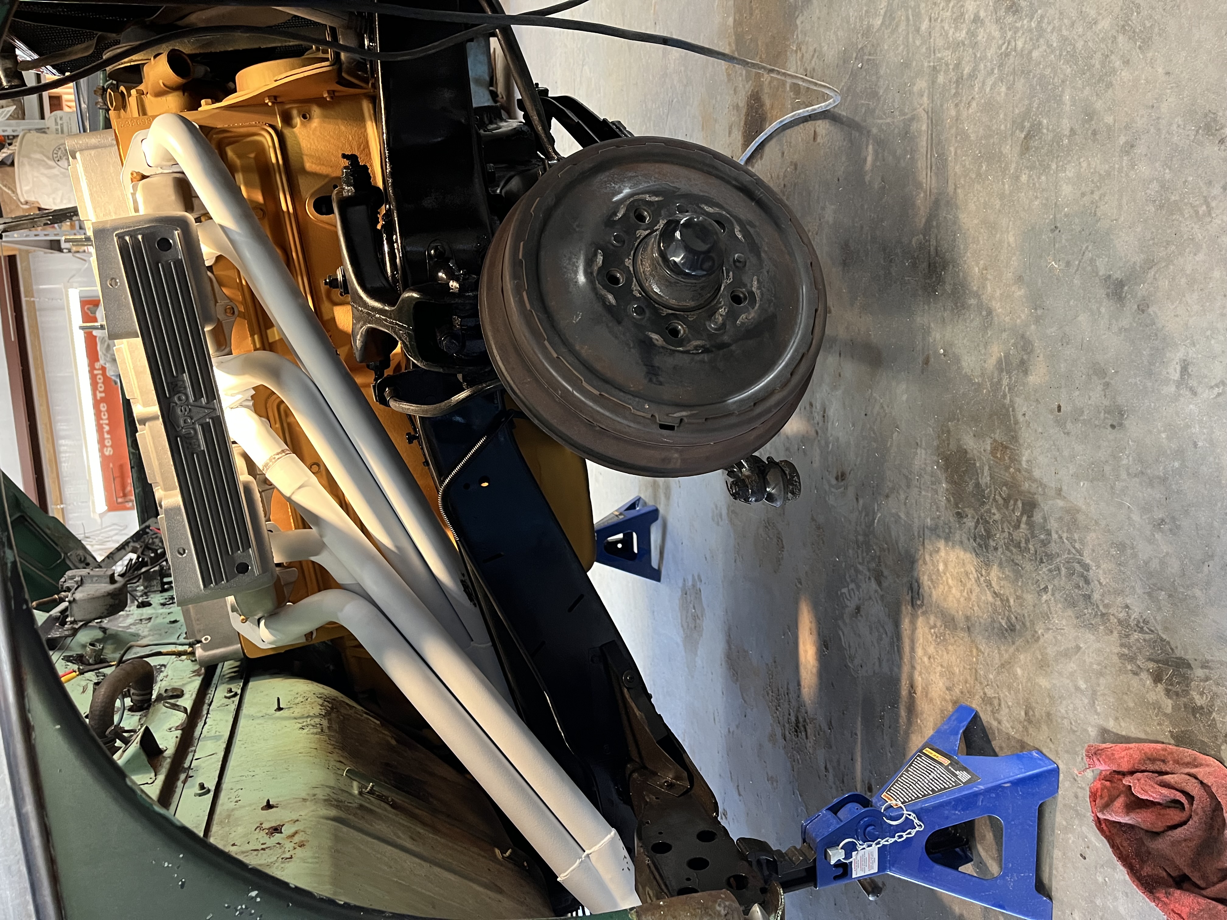

Well I finally got the old guide out today and the new guide, Thank you Gert!!, and a new seat installed. I was unsuccessful pulling the guide, it crumbled itself but the rest stayed in the block. I pulled two different pieces of SS all-thread w long coupling nuts in half. Even tried my impact gun, no dice. So I loaded the car on the trailer and took it to my friends machine shop. All that was done in about 45mins. Then I had him dress all of the other seats and valves. Now it’s back home and I’ll start the assembly process along w the new head and twin 2bbl intake from Dan. Turns out this engine and Hydro were worked over by Clifford back in the ‘70s, bored .060 over, unknown other internal mods.

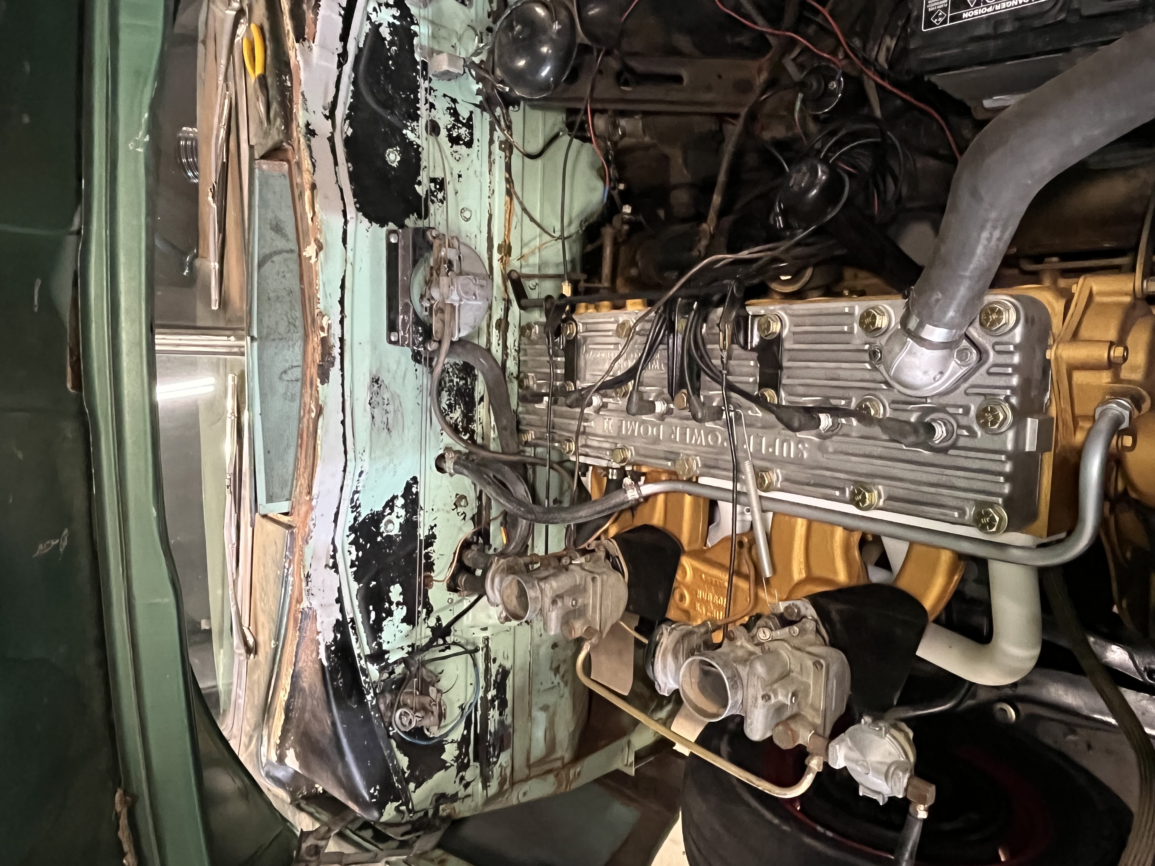

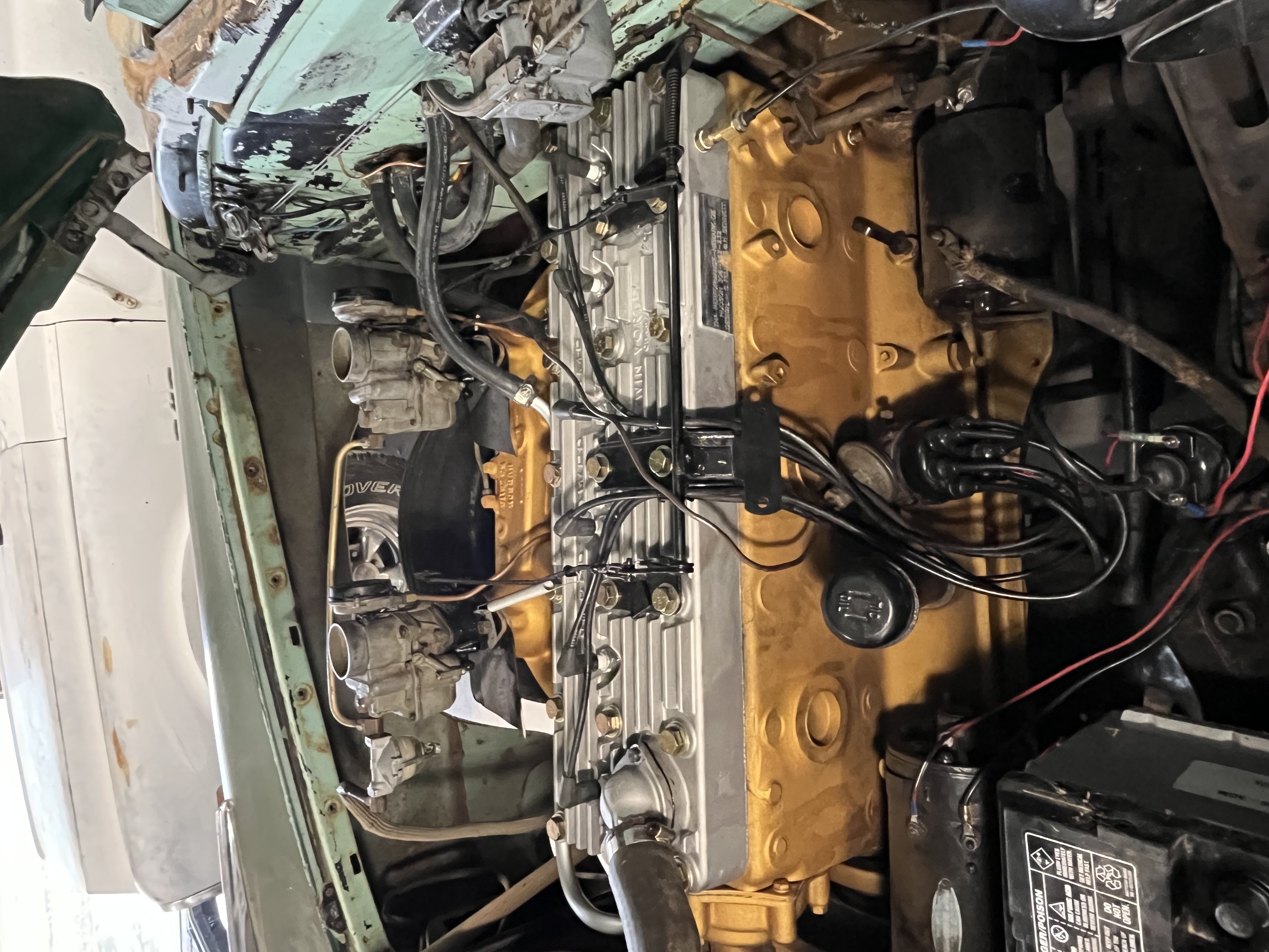

Heres a sneak peek at the look.
Glad to help - looking good. I am also rebuilding a Hornet engine. Gert

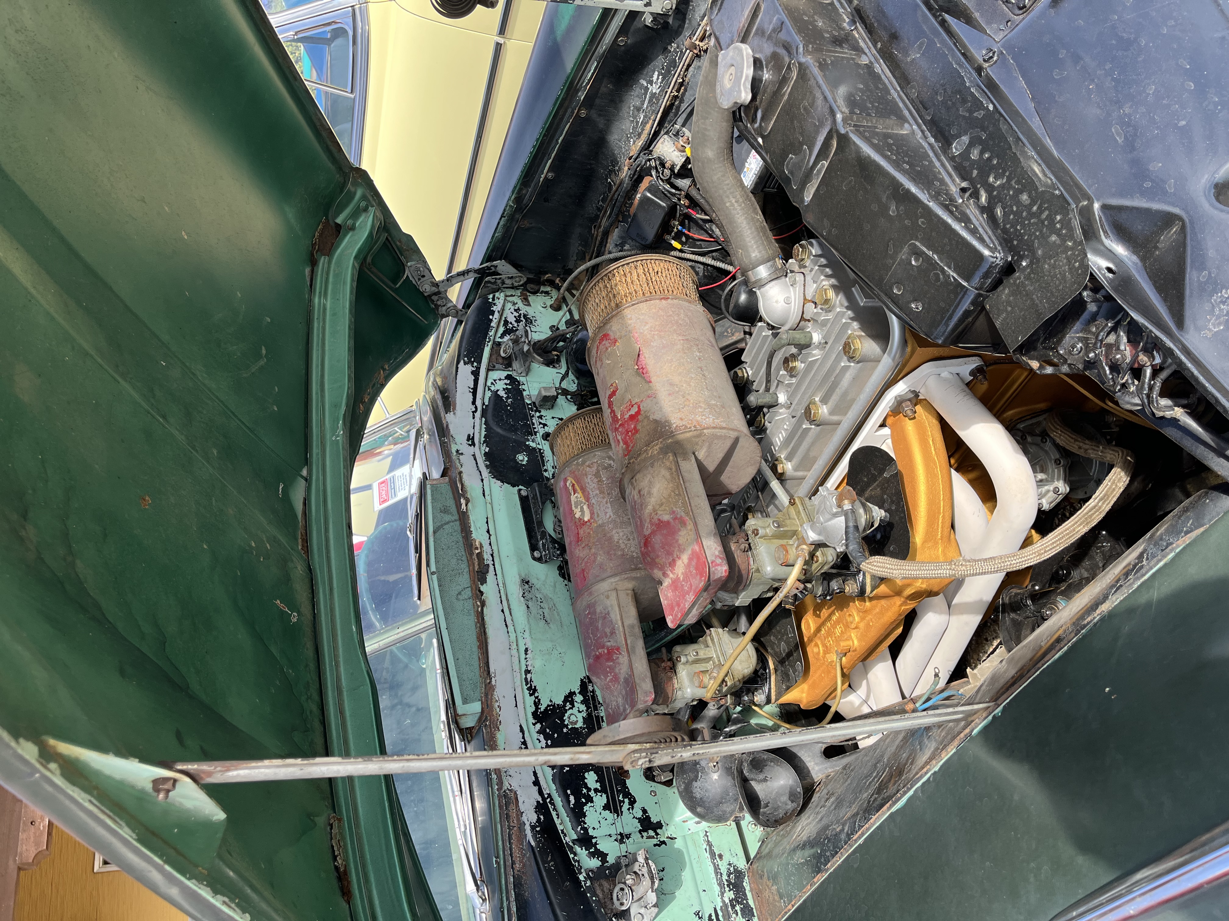

I got the ‘53 Hornet back together, with new head, a month ago, just short trips close by but last weekend went on a 70 mile round trip to Lubbock and back for a car club event. Engine and head run flawless and definitely feel the power. Of course around here I have the only Hudson but it’s always well received. Coolant temp even in traffic never got above 185°. Also ran down the highway for several miles around 80-85 mph. I’ll work on getting the air cleaners re-painted soon, to much going on right now.
