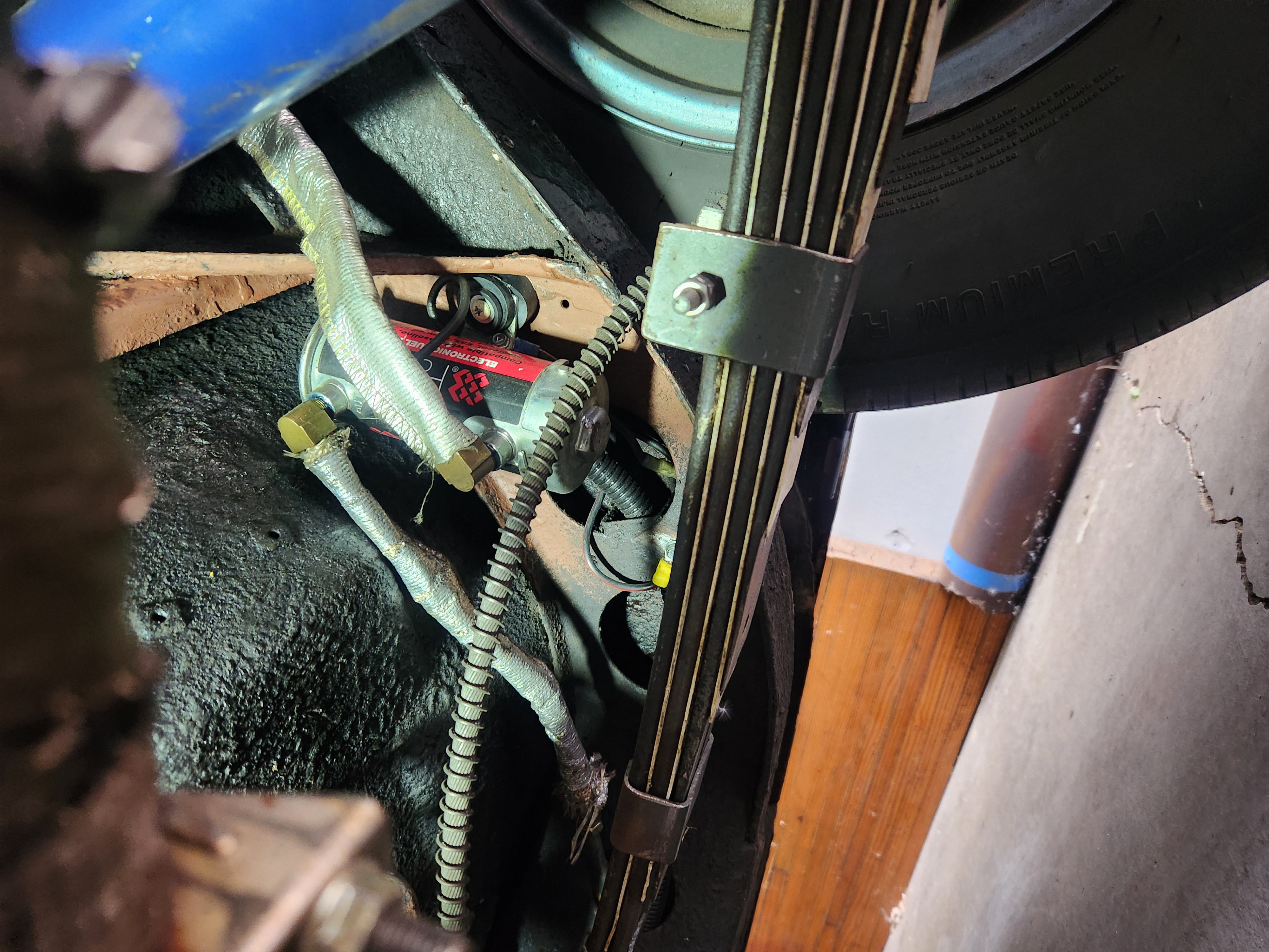

Is this to be your main pump or is this a booster pump to prime the carb? I put a booster pump on the rear outside frame rail, just tapped into the metal fuel line back there.

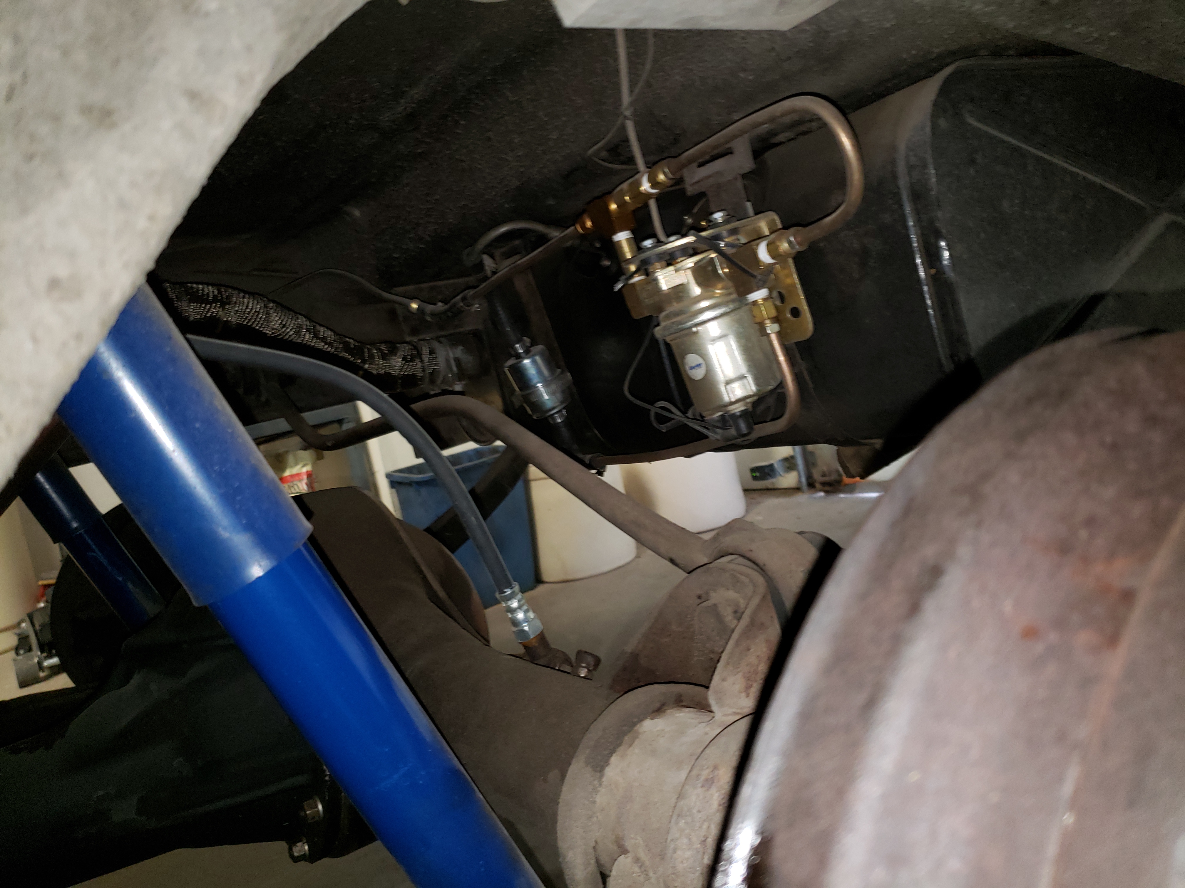

I clamped it to the driver's side fuel tank strap and ran a ground to the chassis. This keeps it away from the heat of the exhaust. Mine electric pump is setup for priming and has a bypass with a check-valve.
Here's where I mounted my fuel pump.
