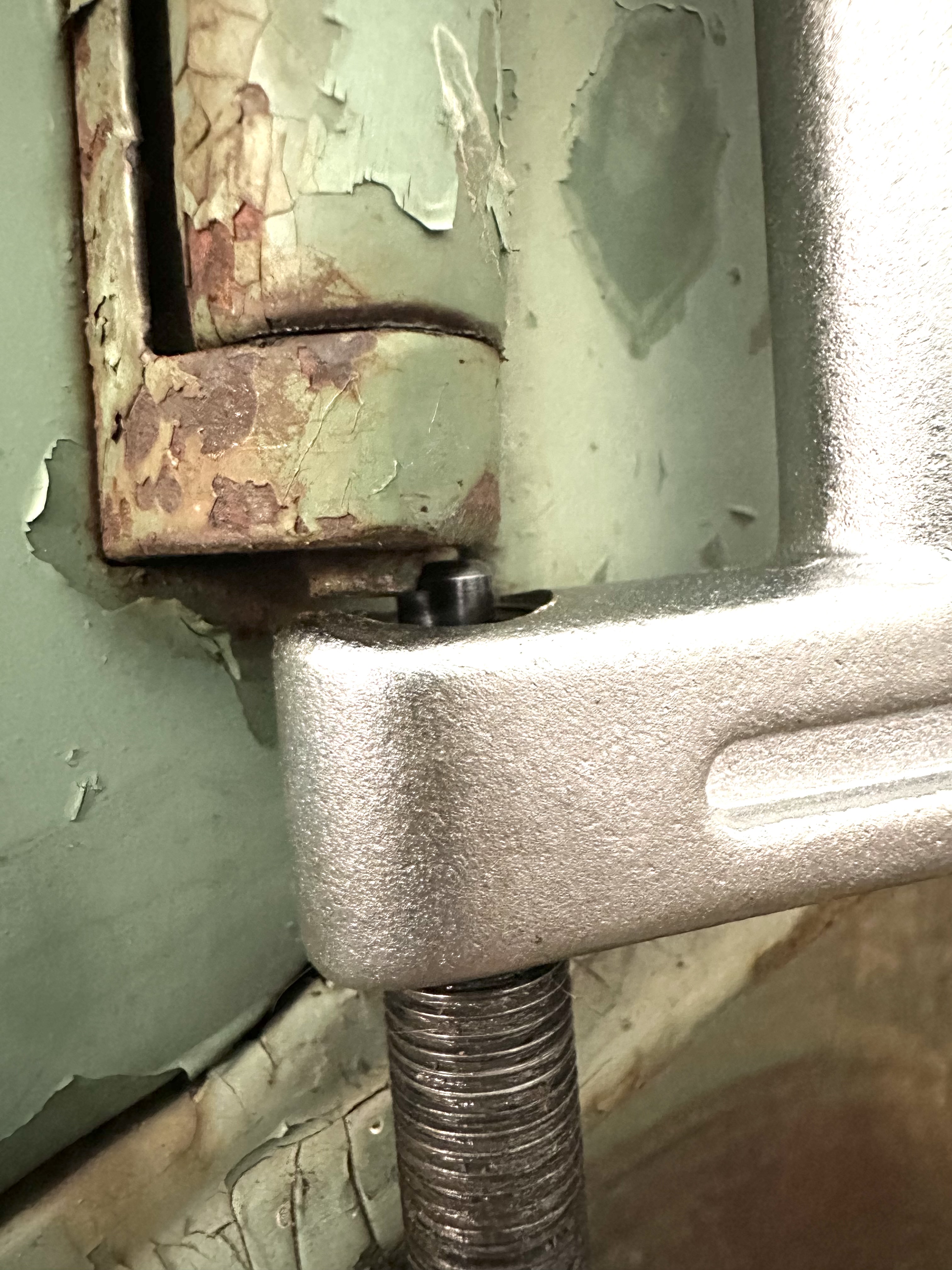

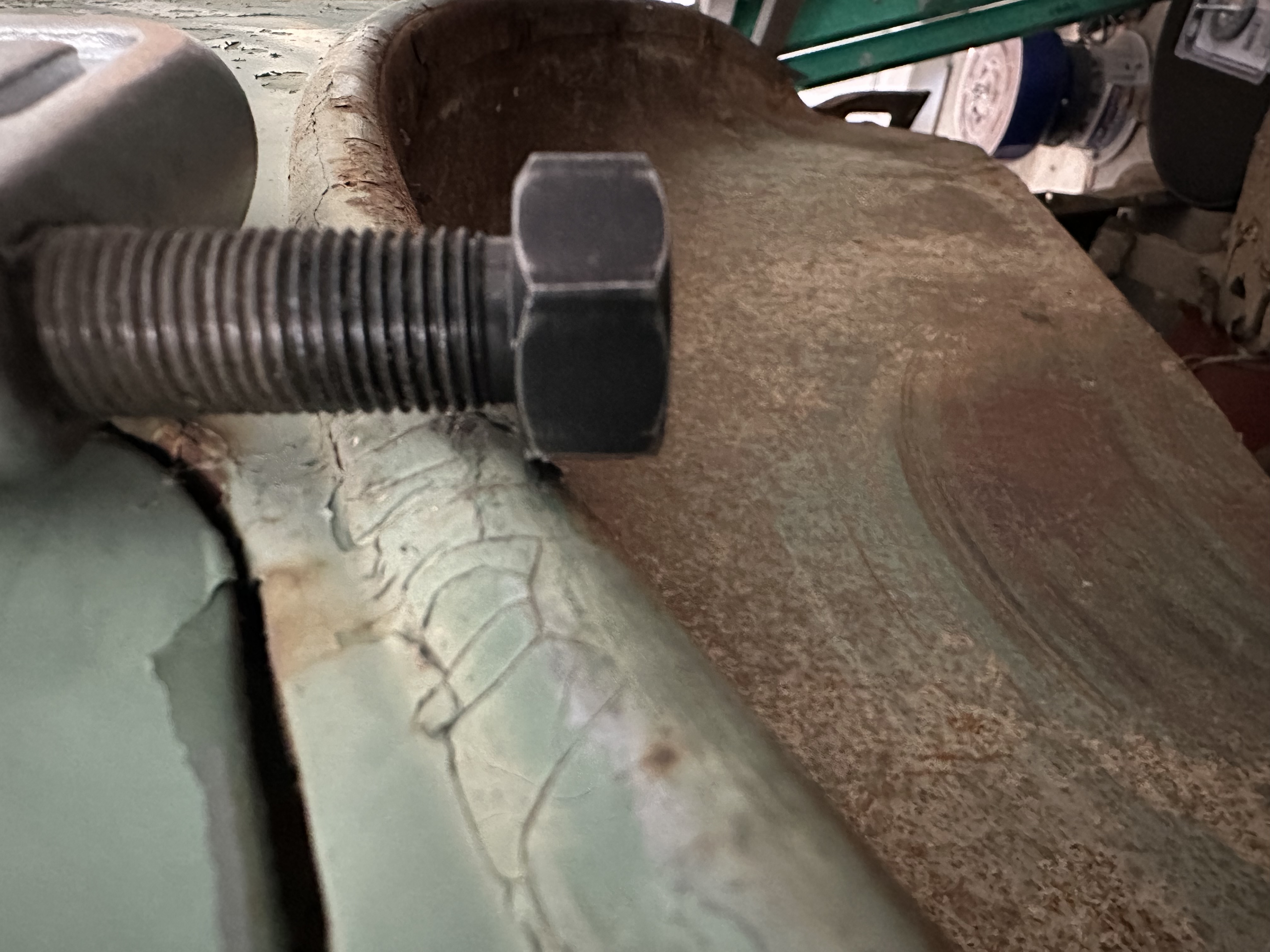

I’m stuck. I’m trying to remove the rear doors hinge pins on my 36 Hudson. I bought this Bob drake hinge puller kit and it’s been a great tool for the front doors. But the bottom hinges on the rear doors are giving me trouble. The short pin in the kit (1”) is maxed out because the hex head bolt is hitting the lip on the body where the fender meets. And the next longer pin (1.5”) is too long to allow the bolt to get threaded into the bracket. I’ve tried hammering the pin up, but it won’t budge. I’ve considered grinding length off the bottom of the 1.5” pin but wasn’t sure how the hardened pin would handle it. Any advice?

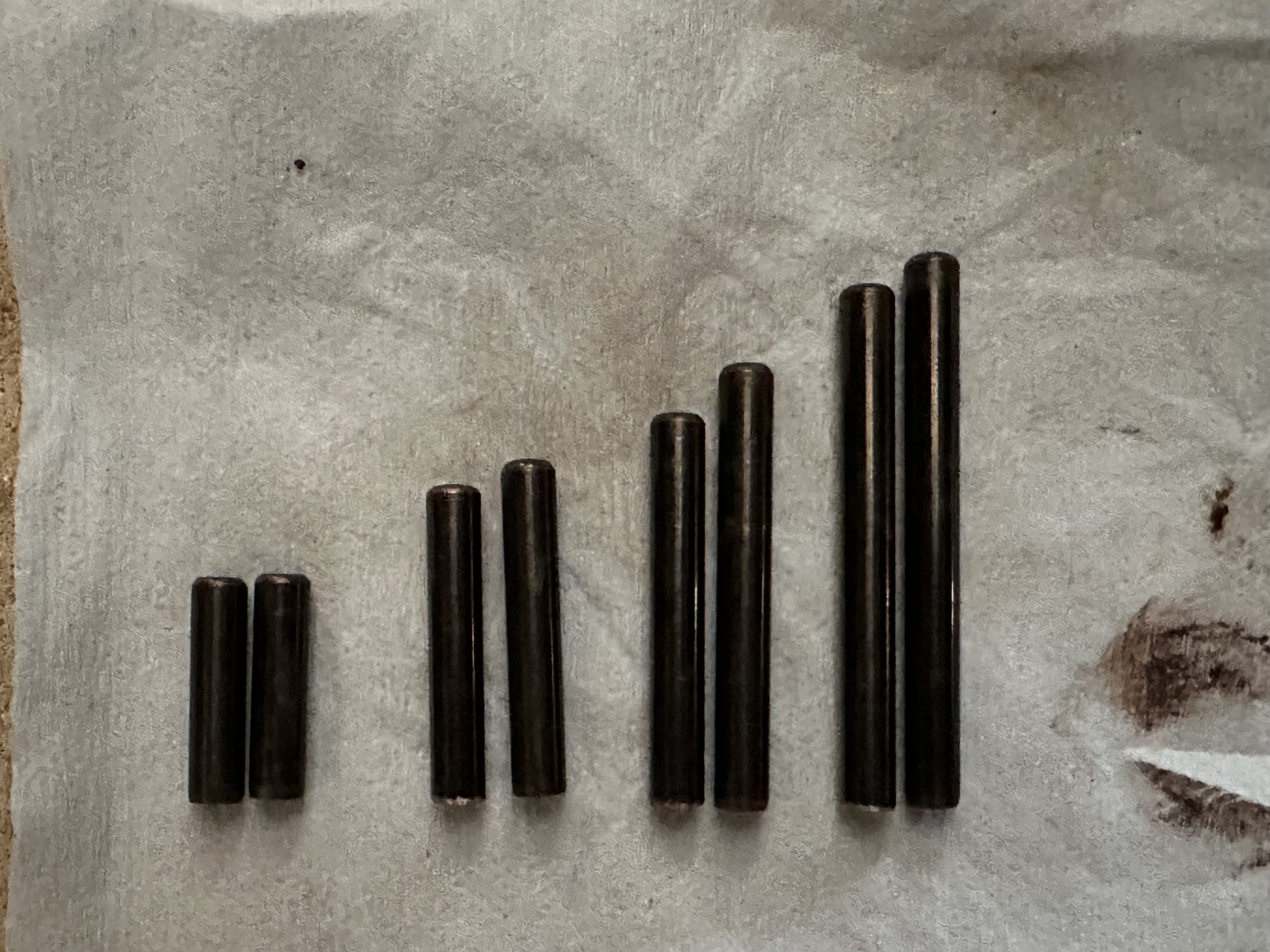

I solved it. I ground a few millimeters off of the pins that were too long but then ran out of length for the next pin before the driving bolt would rub on the body. I ended up ordering a second set of pins to have enough runout to drive the hinge pin all the way out. It took a couple of combinations but now I’ve got a much more stepped range of diving pins!
