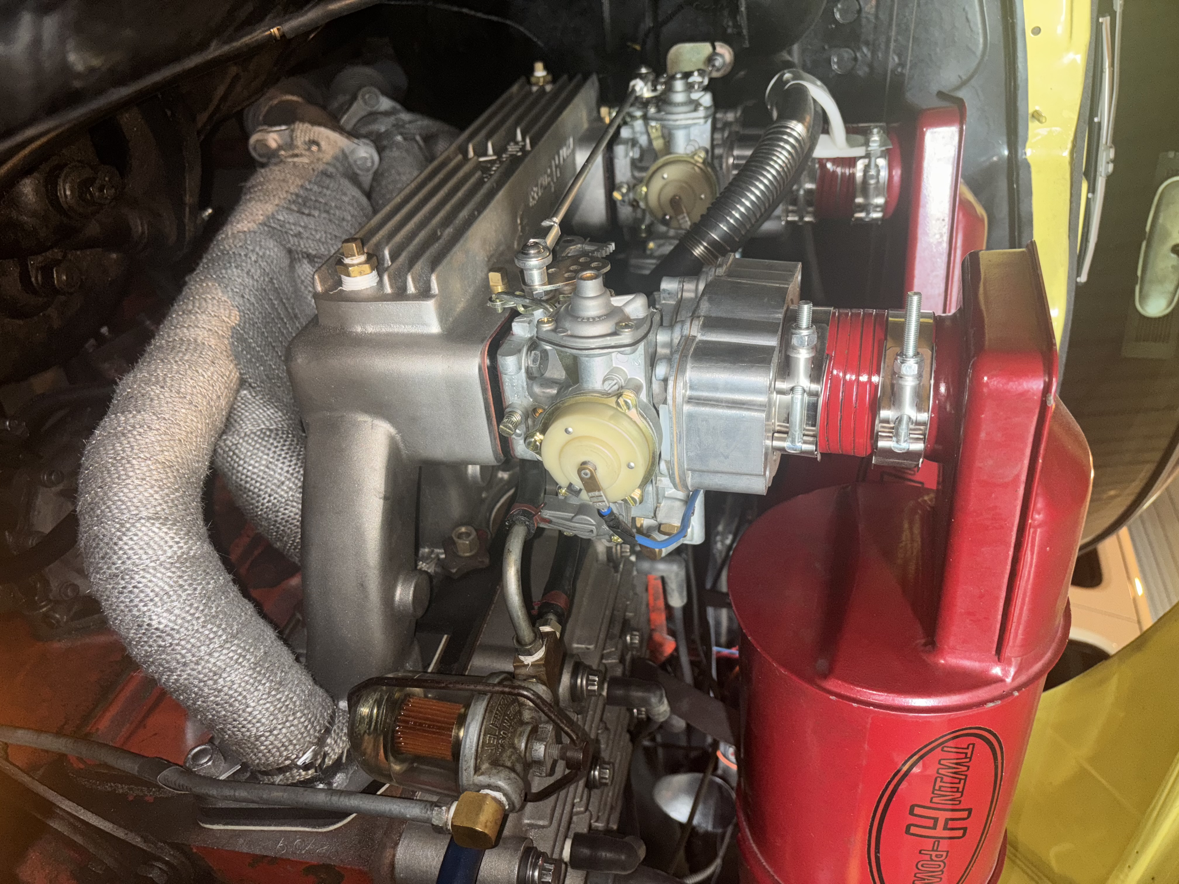

I did check for some infos for ceramic coating and though it could have been a good option, the process is very long if done the right way ( removing the header for proper cleaning before putting the coat ). So I opted for the header wrap as it is easier to install. It only took me half a day to do it while taking my time to do it right.
As seen on the picture, it does look good and it did help a bit heat wise. I recently drove a couple of miles under a hot sunny day and the coolant gauge was just under half way. Naturally, it does bump up a little when driving in town or when when driving at high speed ( 60 miles per hour and up ).
Not bad, but I would like to bring the temperature a little more lower.
The car's cooling system is equipped with a 160 degree F thermostat and I want to know if changing it fo a thermostat that opens at higher temp ( i. e. a 180 F thermostat ) can help or not.
