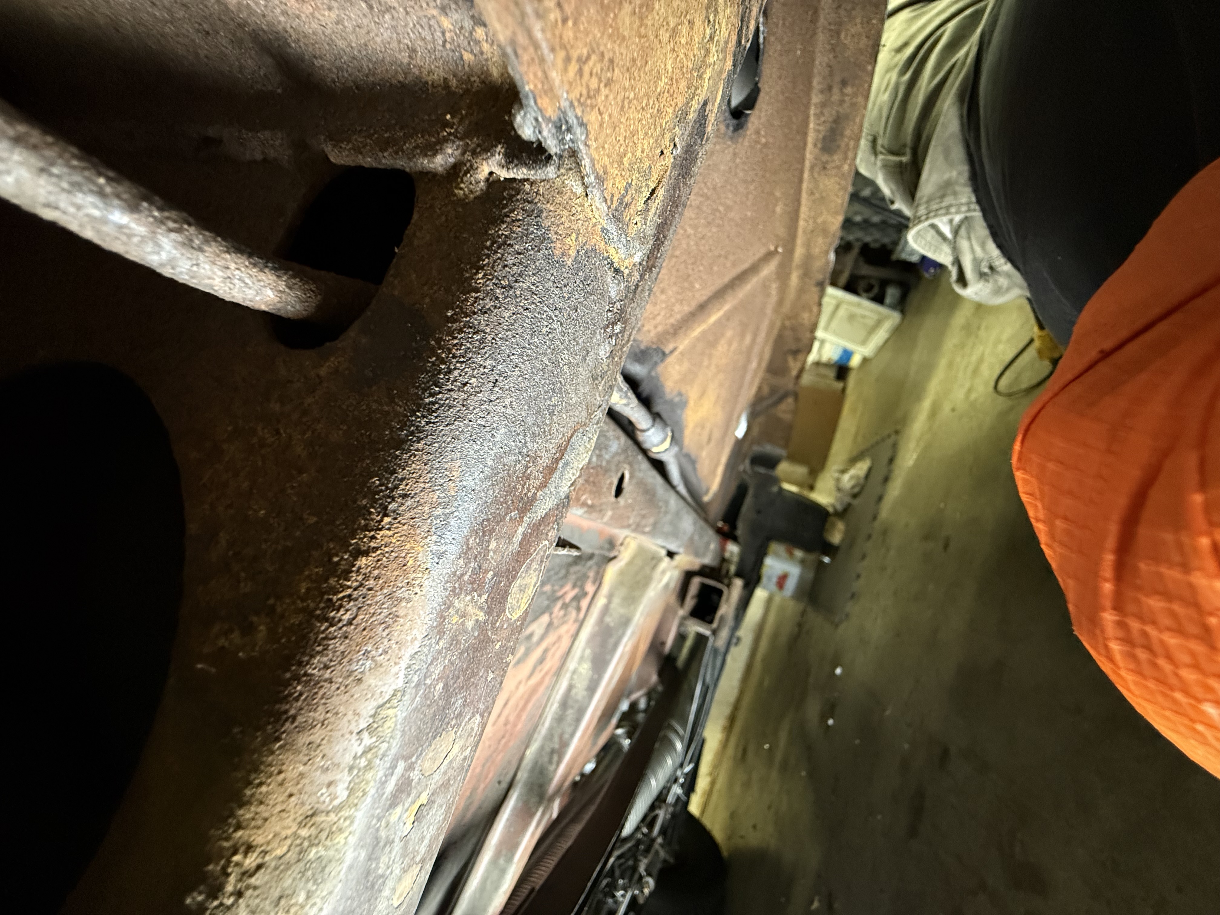

I am replacing the rubber fuel lines in my 51 Hornet with the correct metal lines but would like t I make sure I route them in the right location. Any pictures you may have would be very helpful. I tried the Facebook group and I was banned from posting for a week? Anyways, thanks in advance!

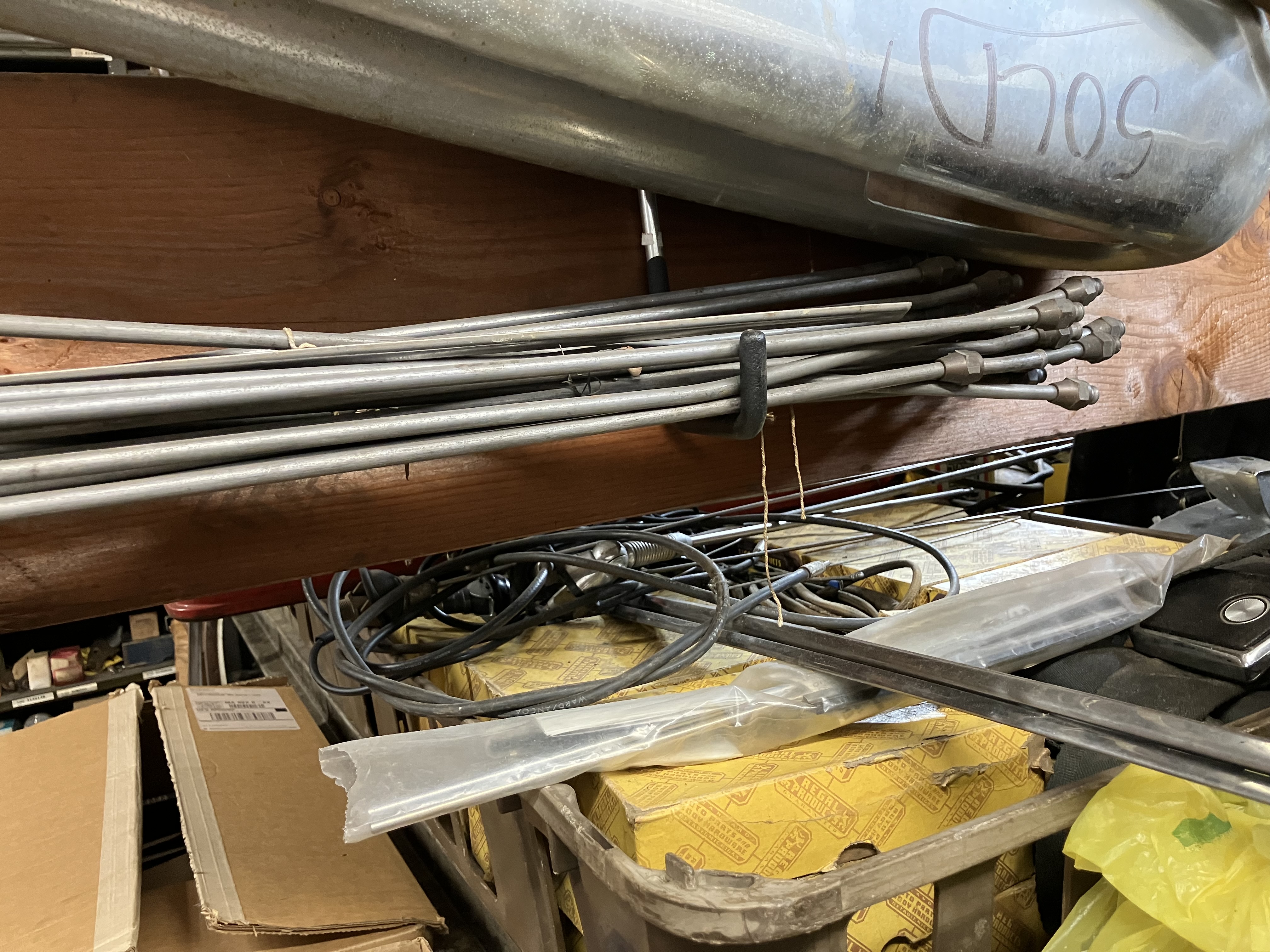

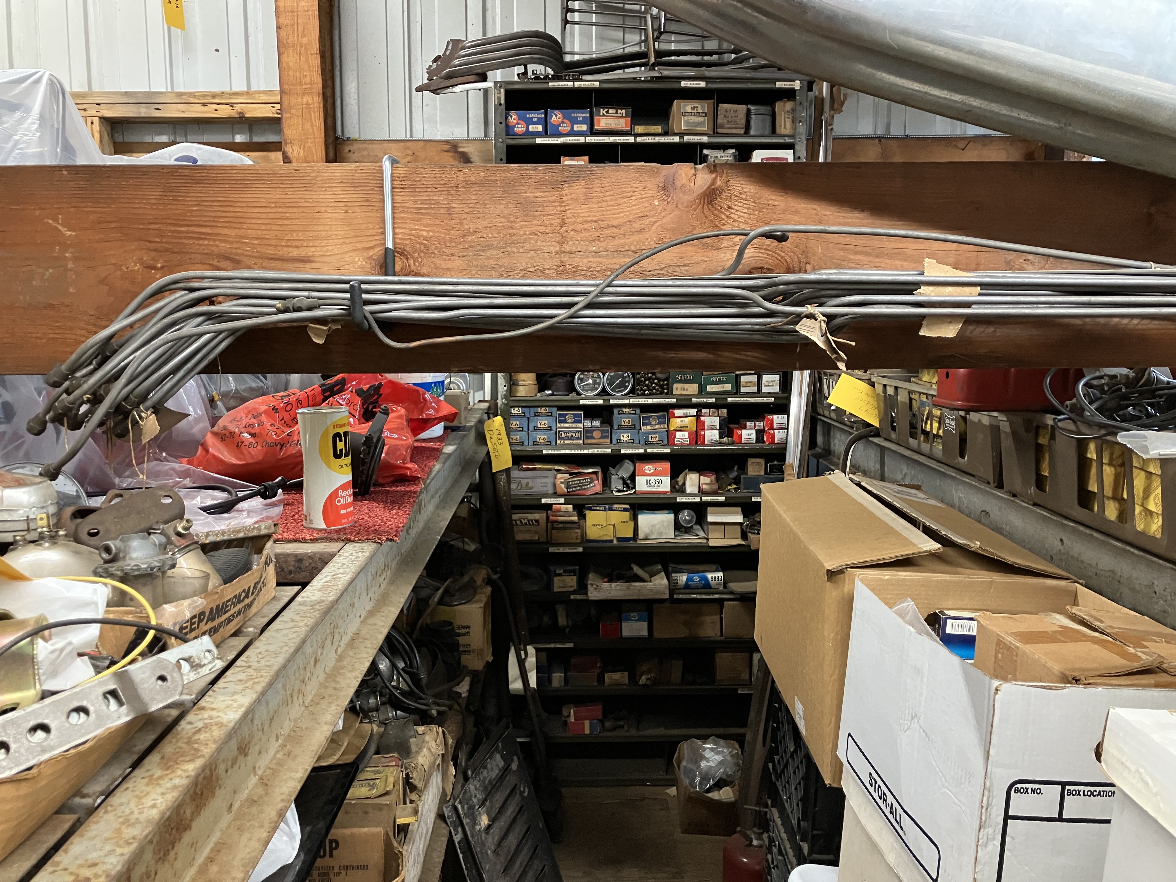

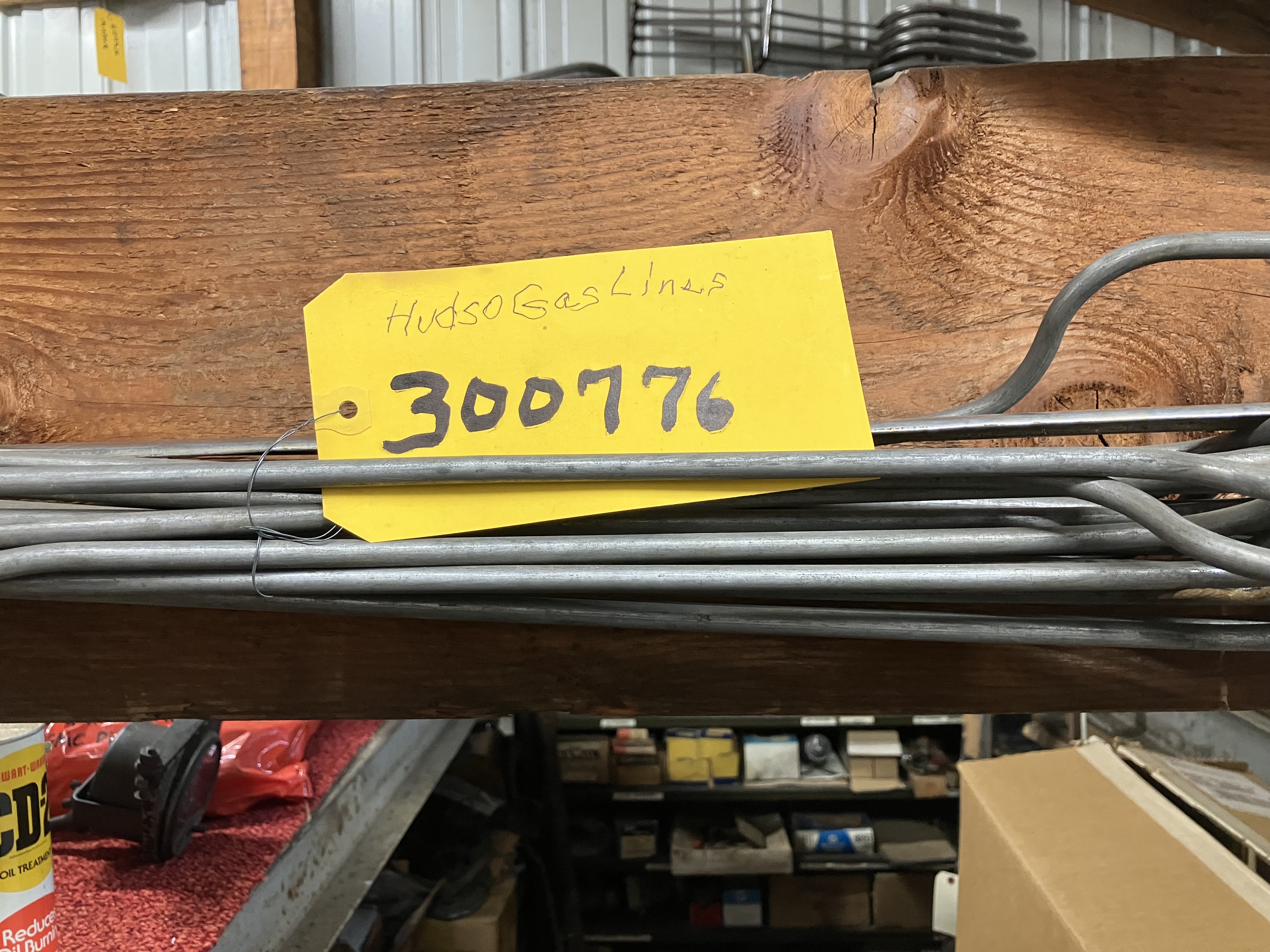

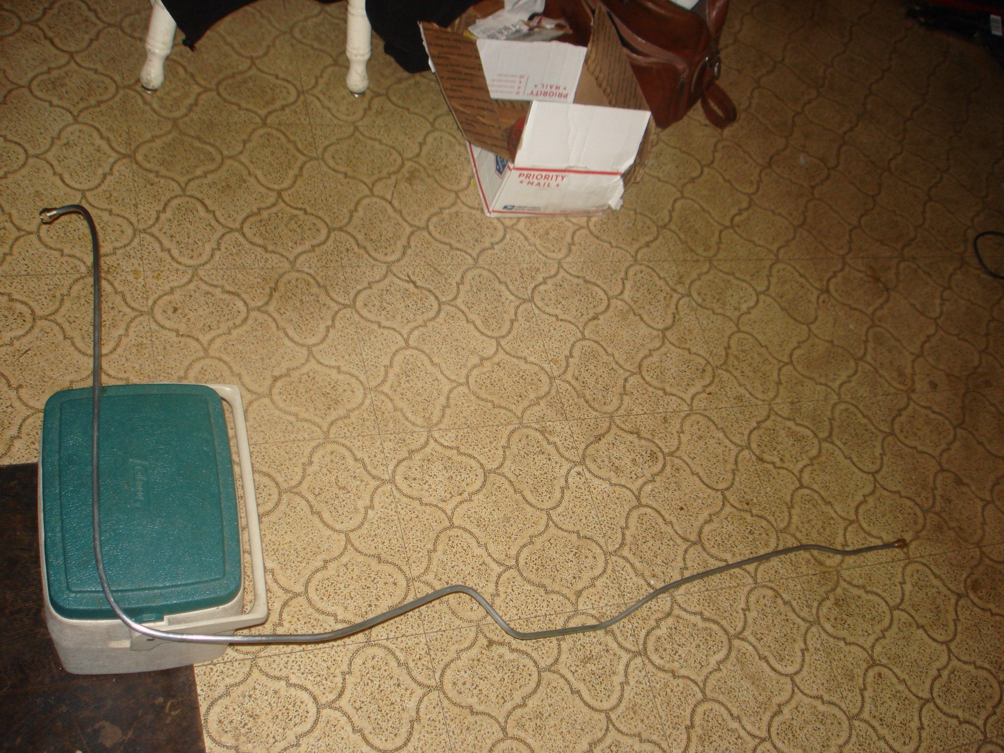

I have NOS front gas lines for step downs $ 25. Factory bent with correct fittings. No shipping. I maybe able to have someone deliver to the National, or I can deliver to Hershey.

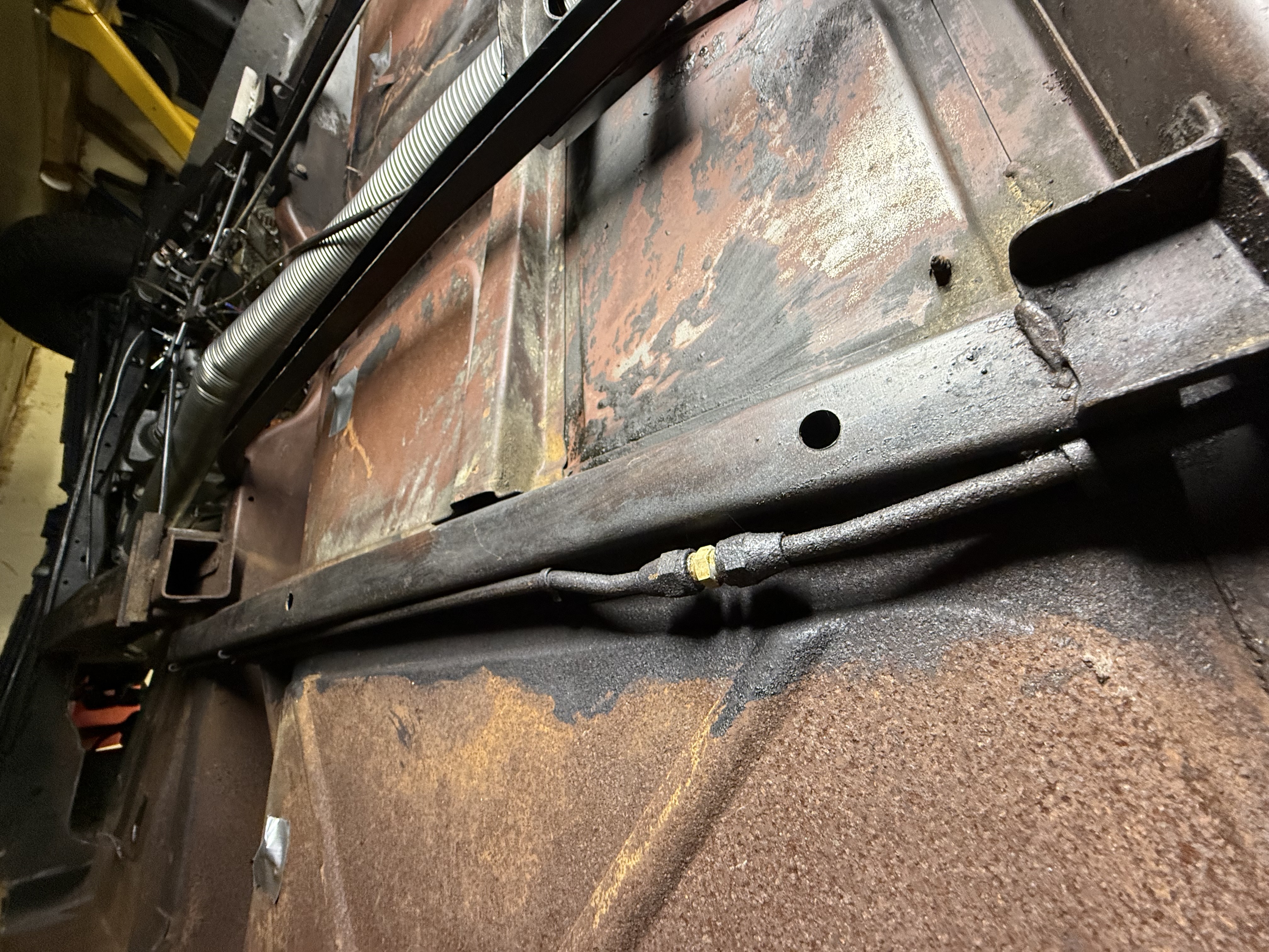

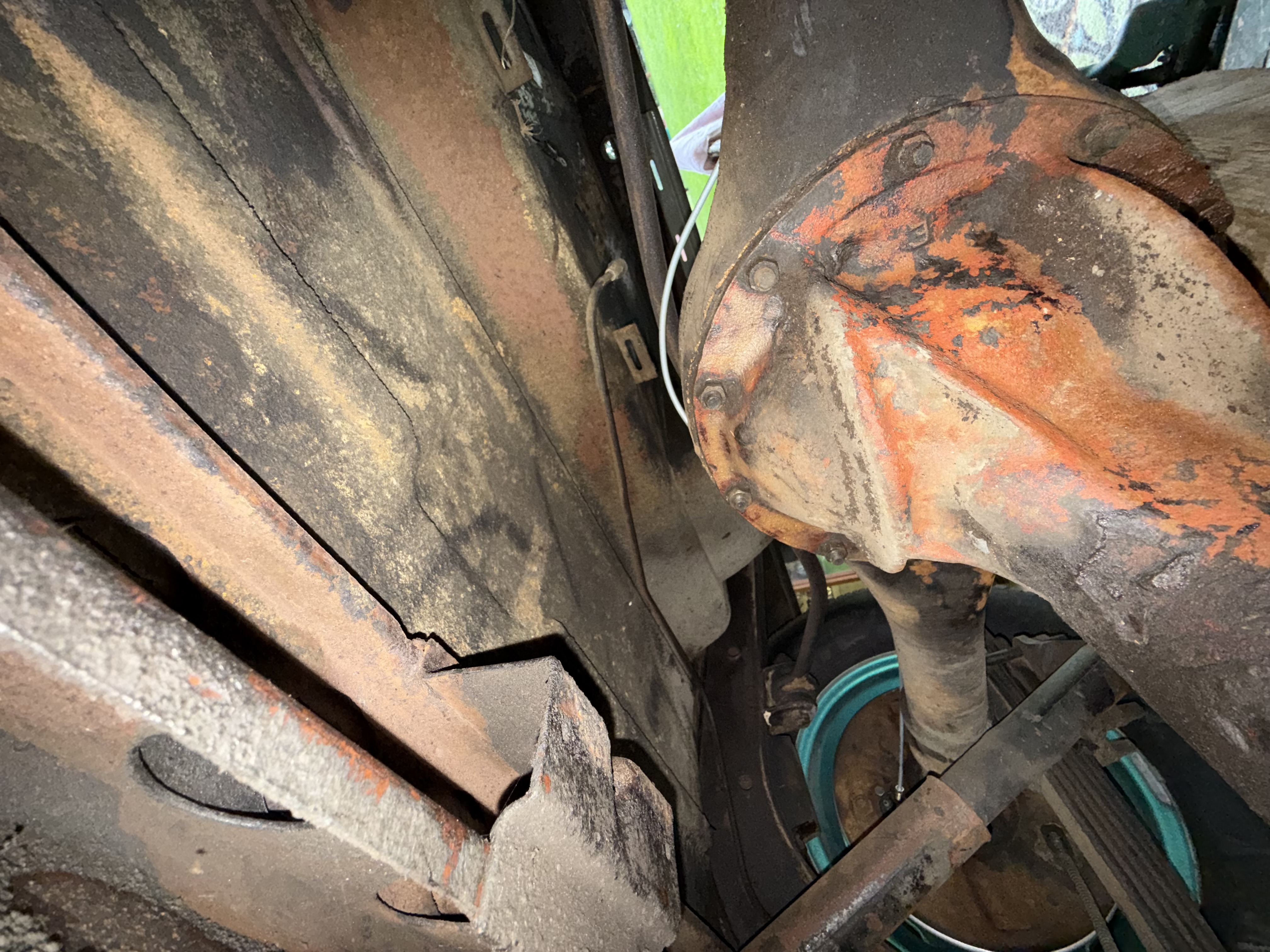

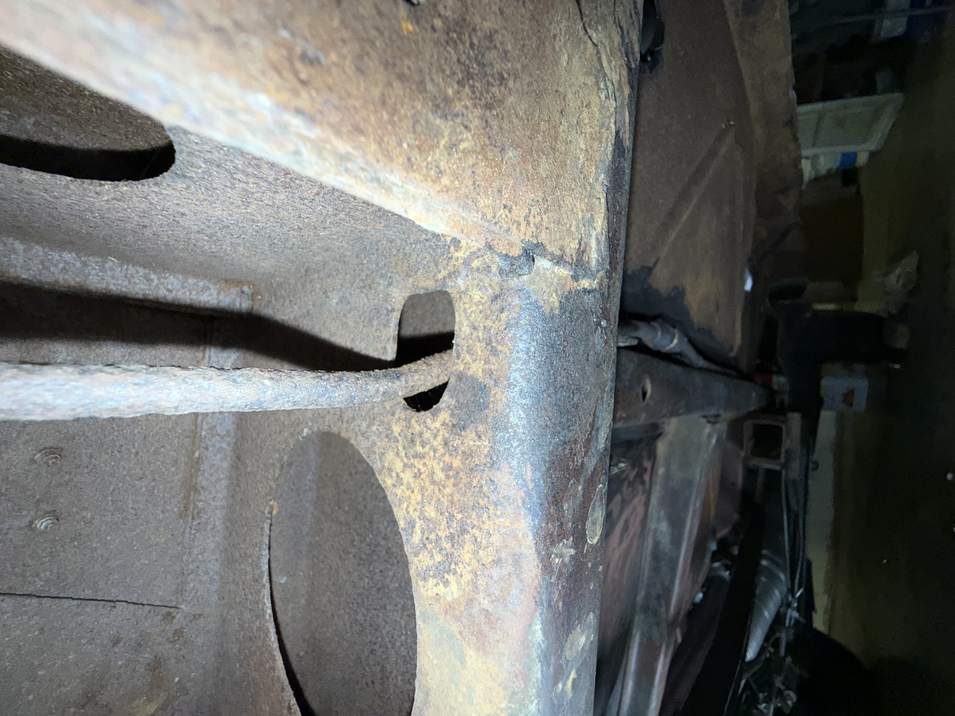

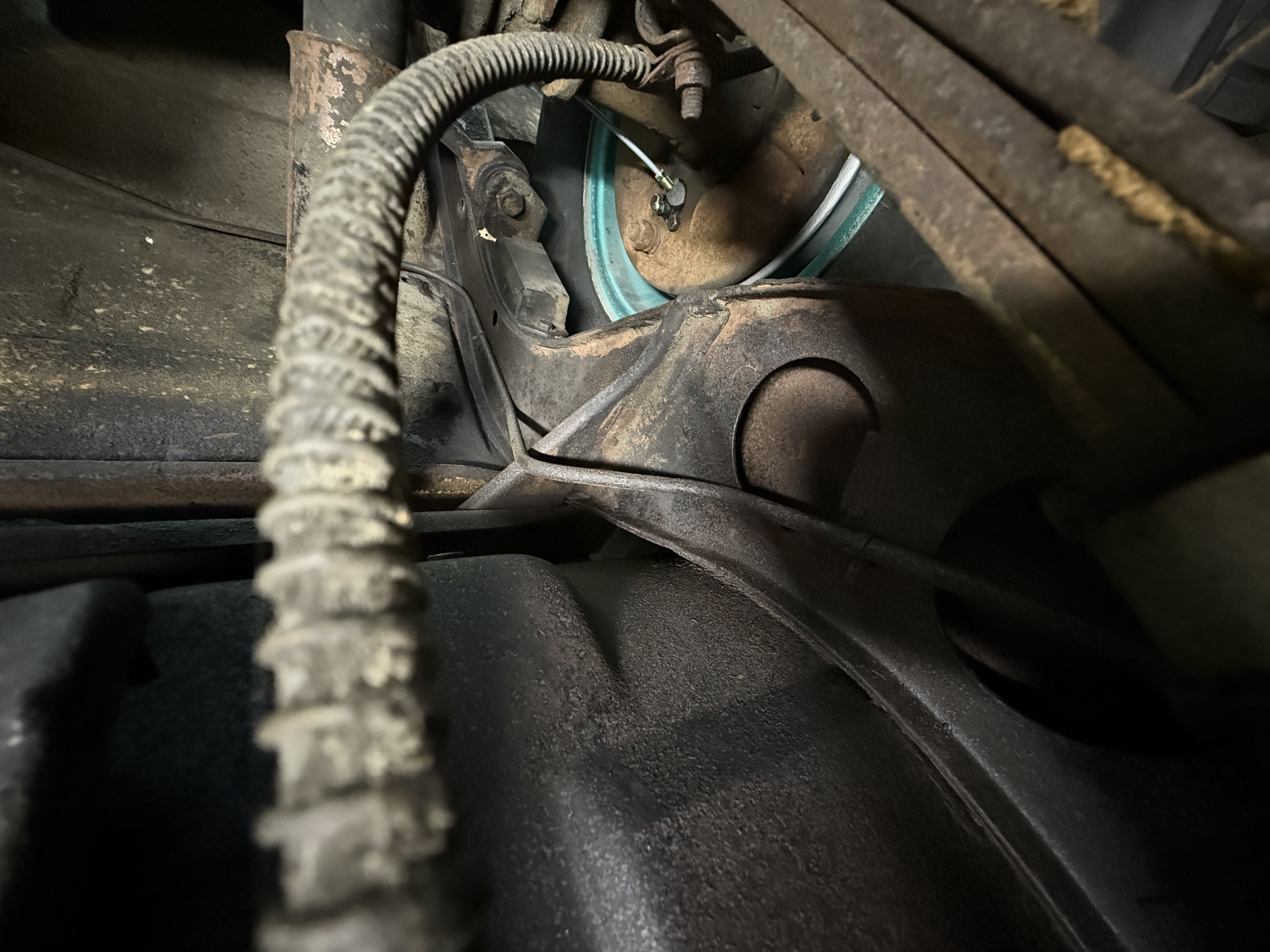

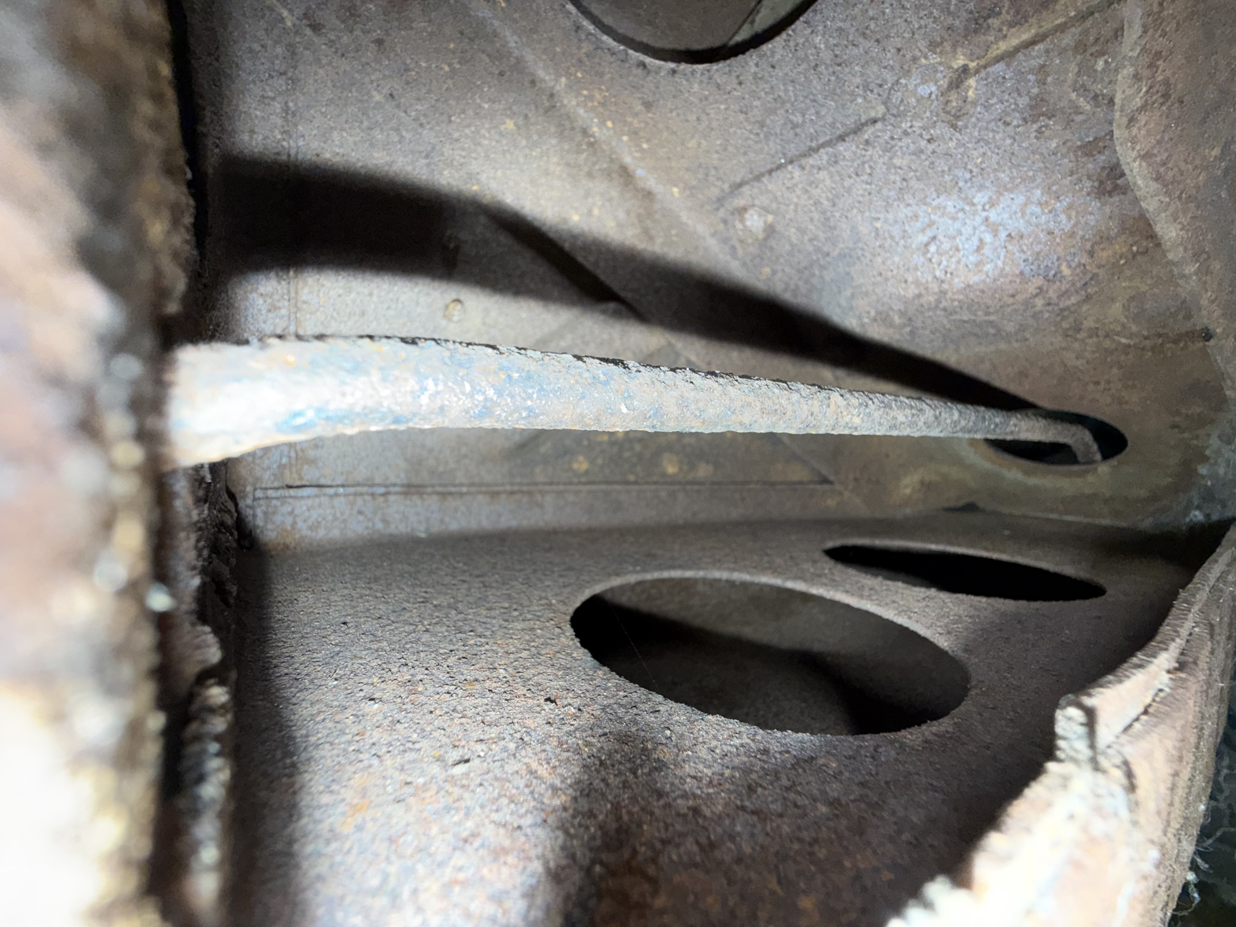

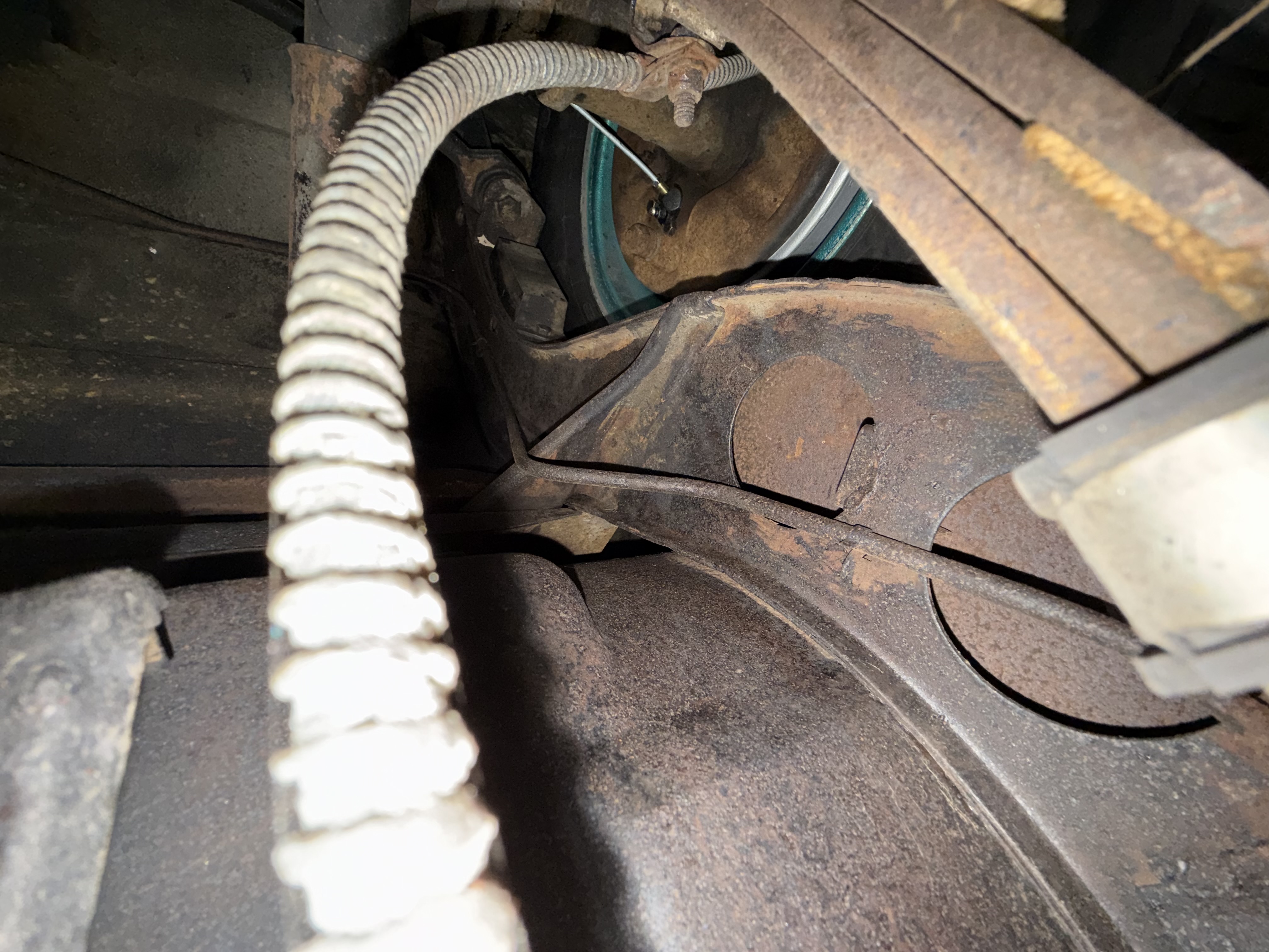

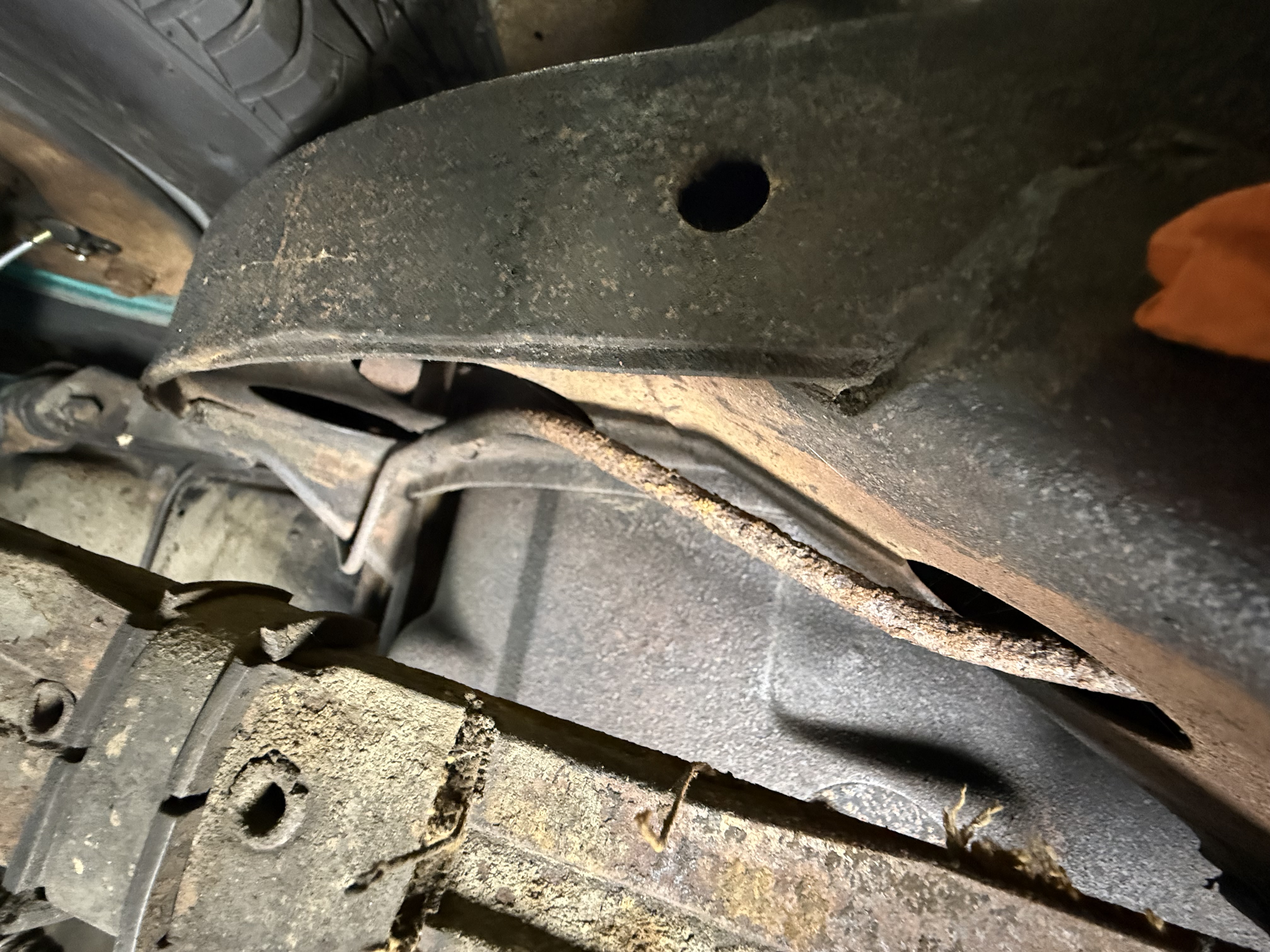

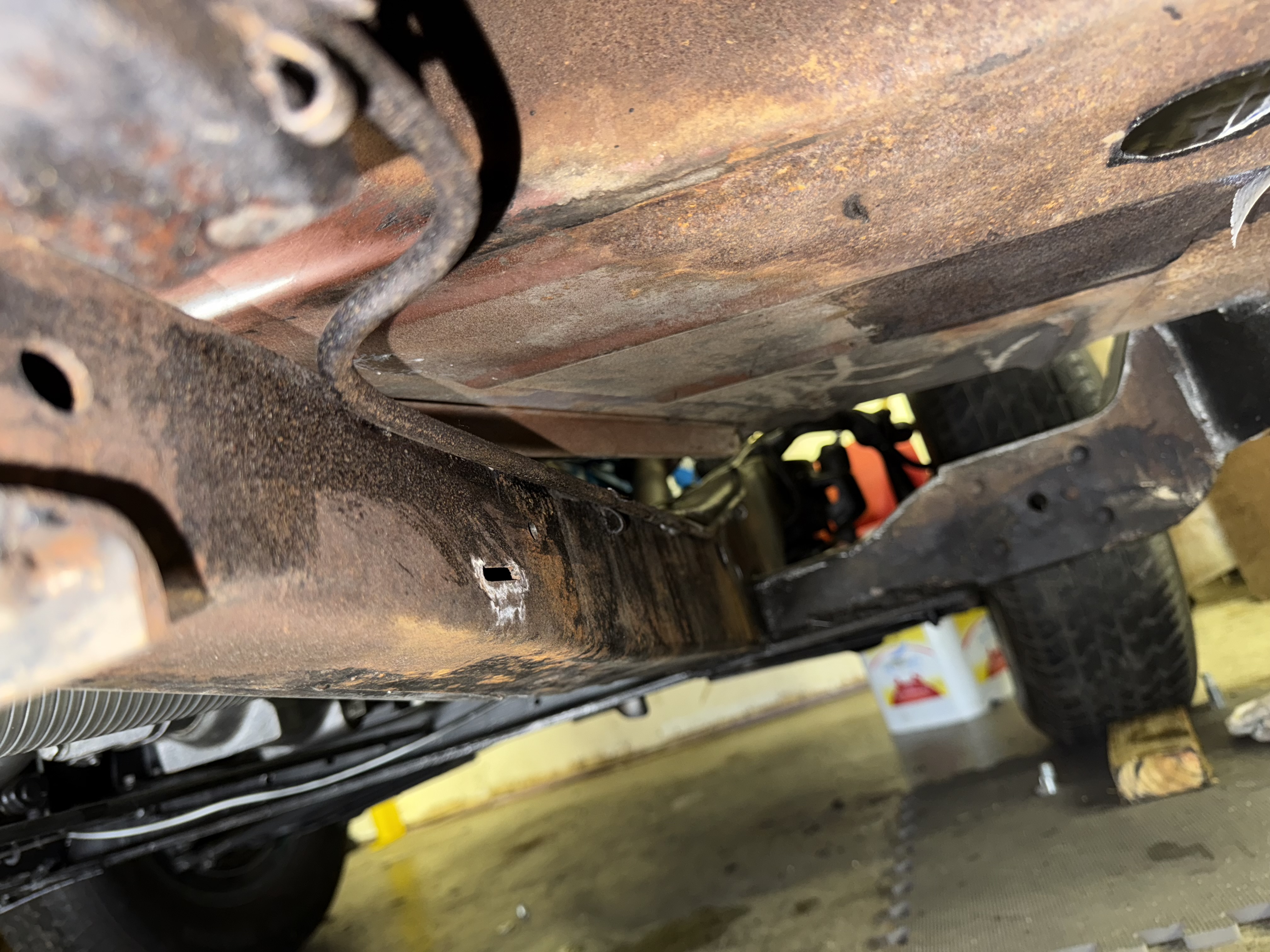

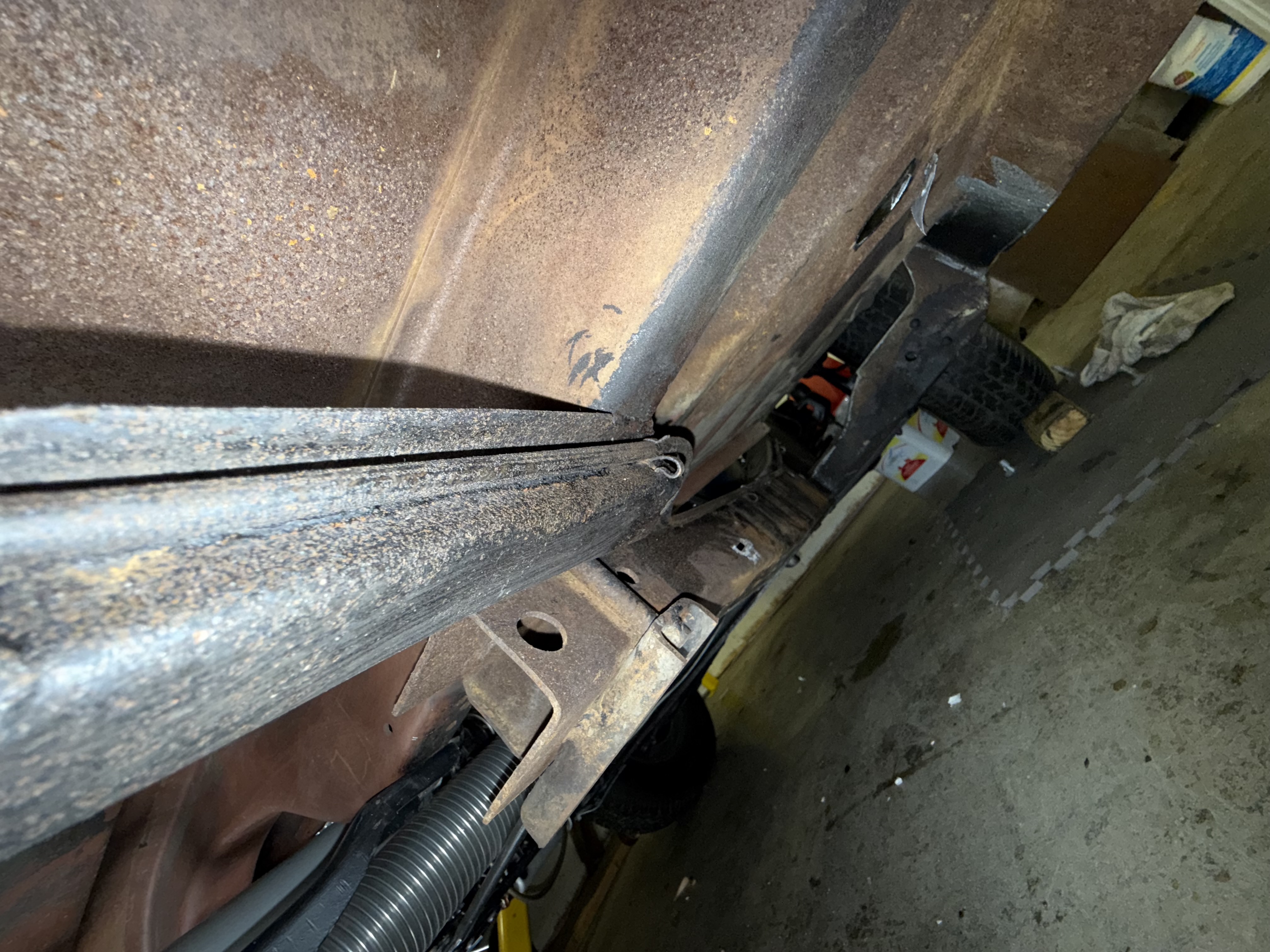

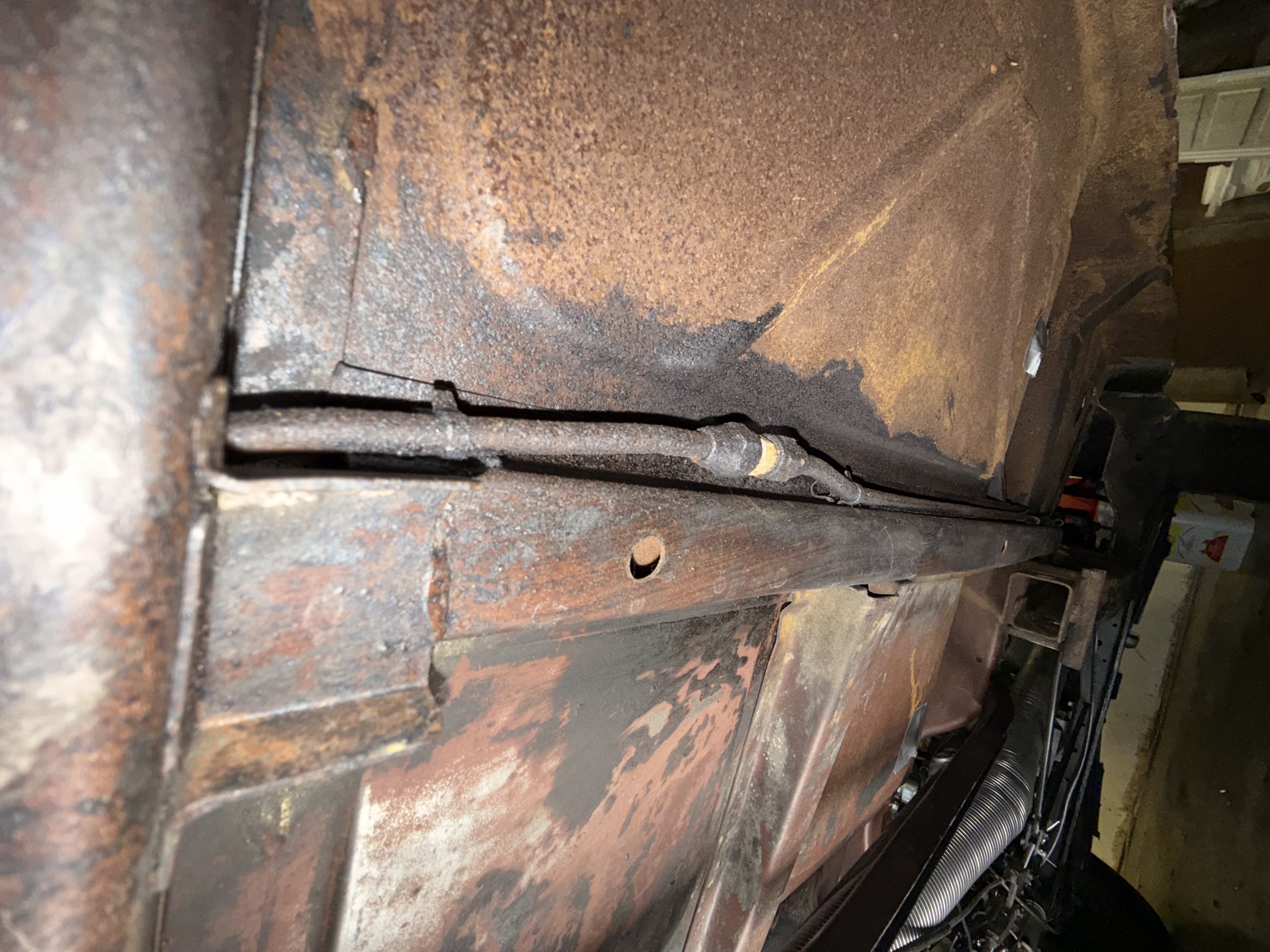

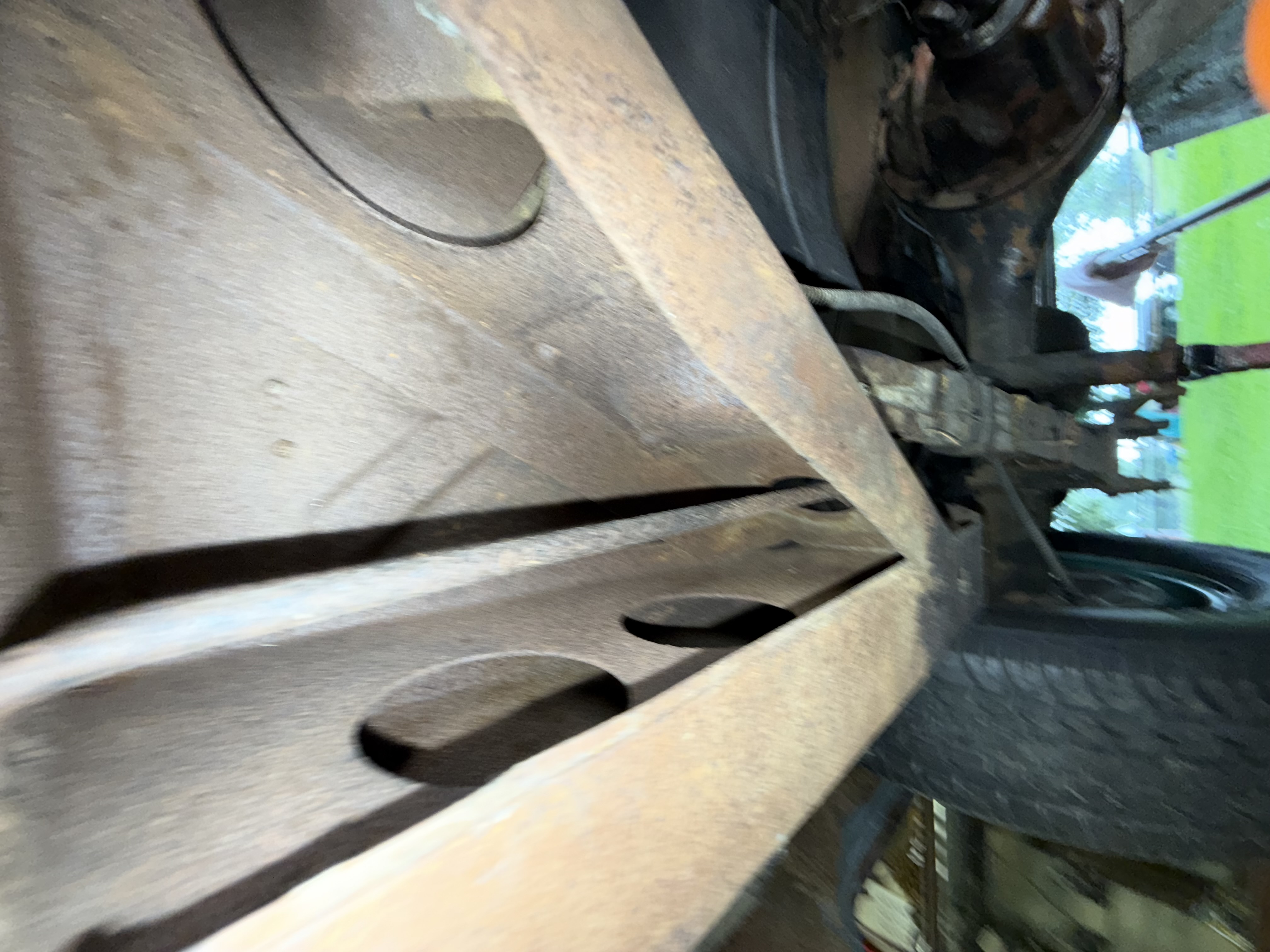

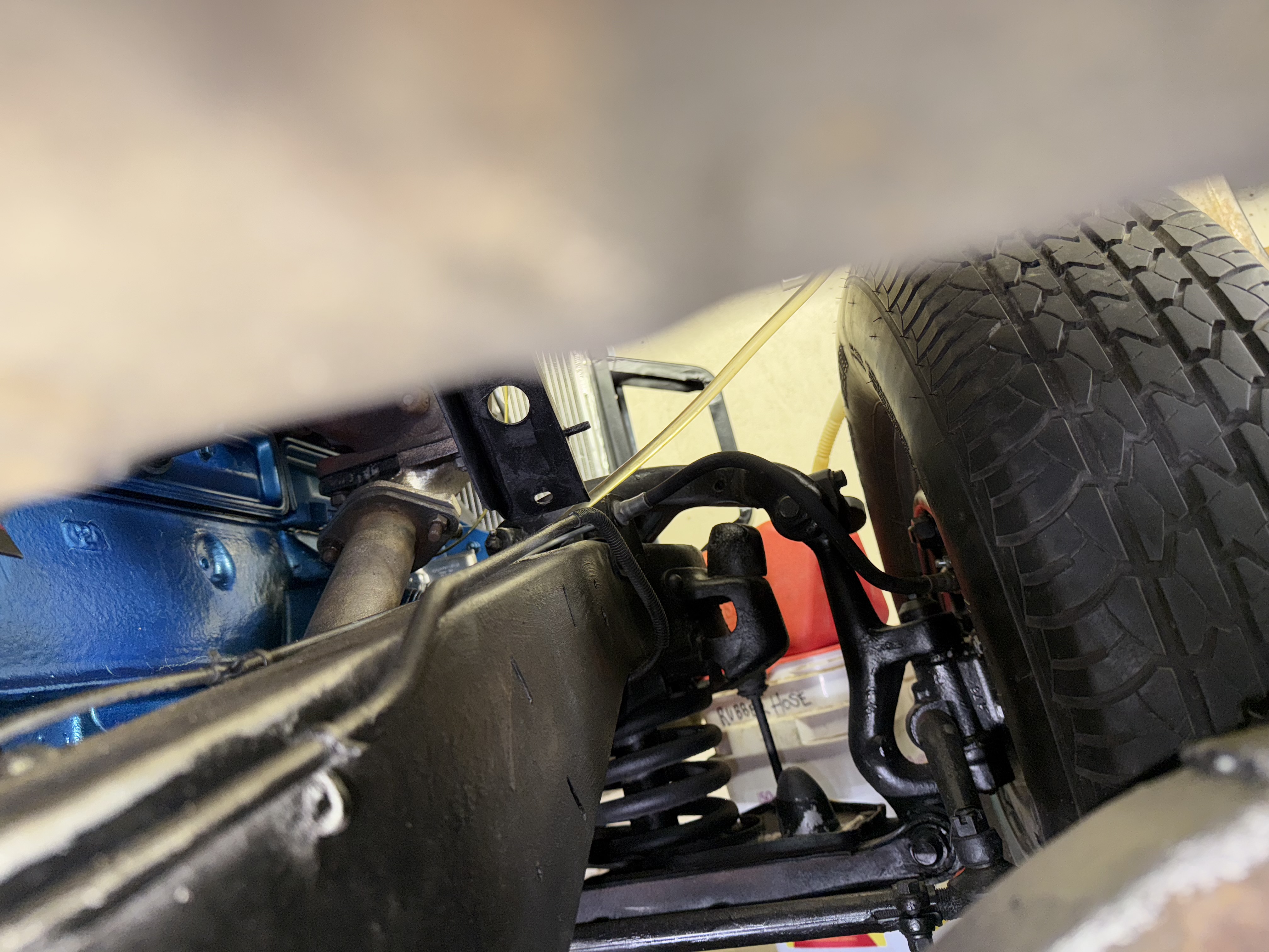

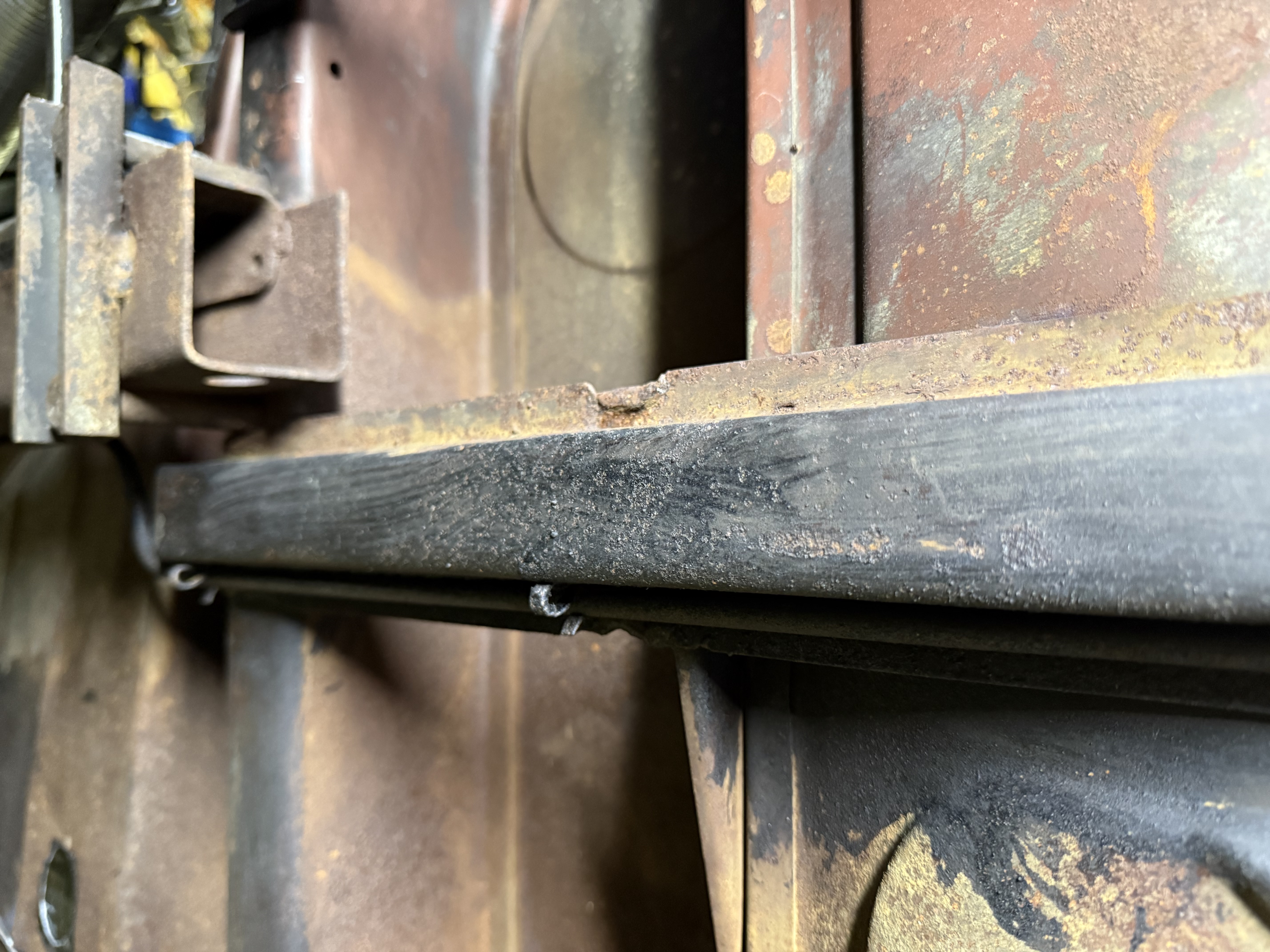

I did my best trying to get pics that might help you out-

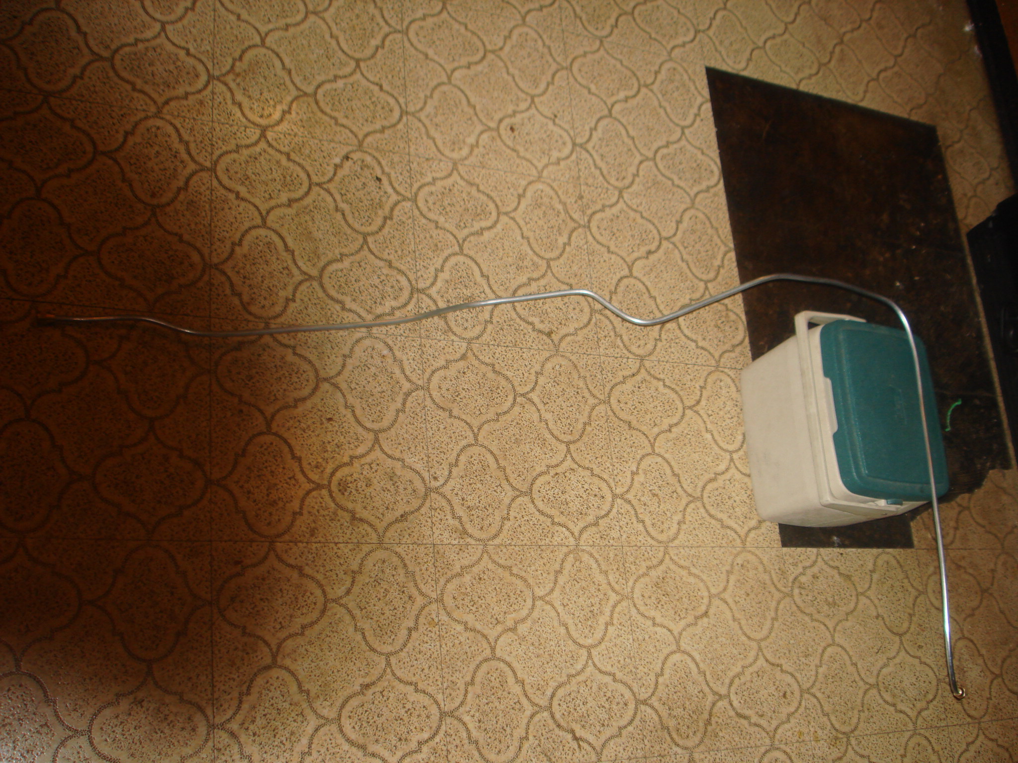

Here are photos of the NOS gas lines. Ed Moore
