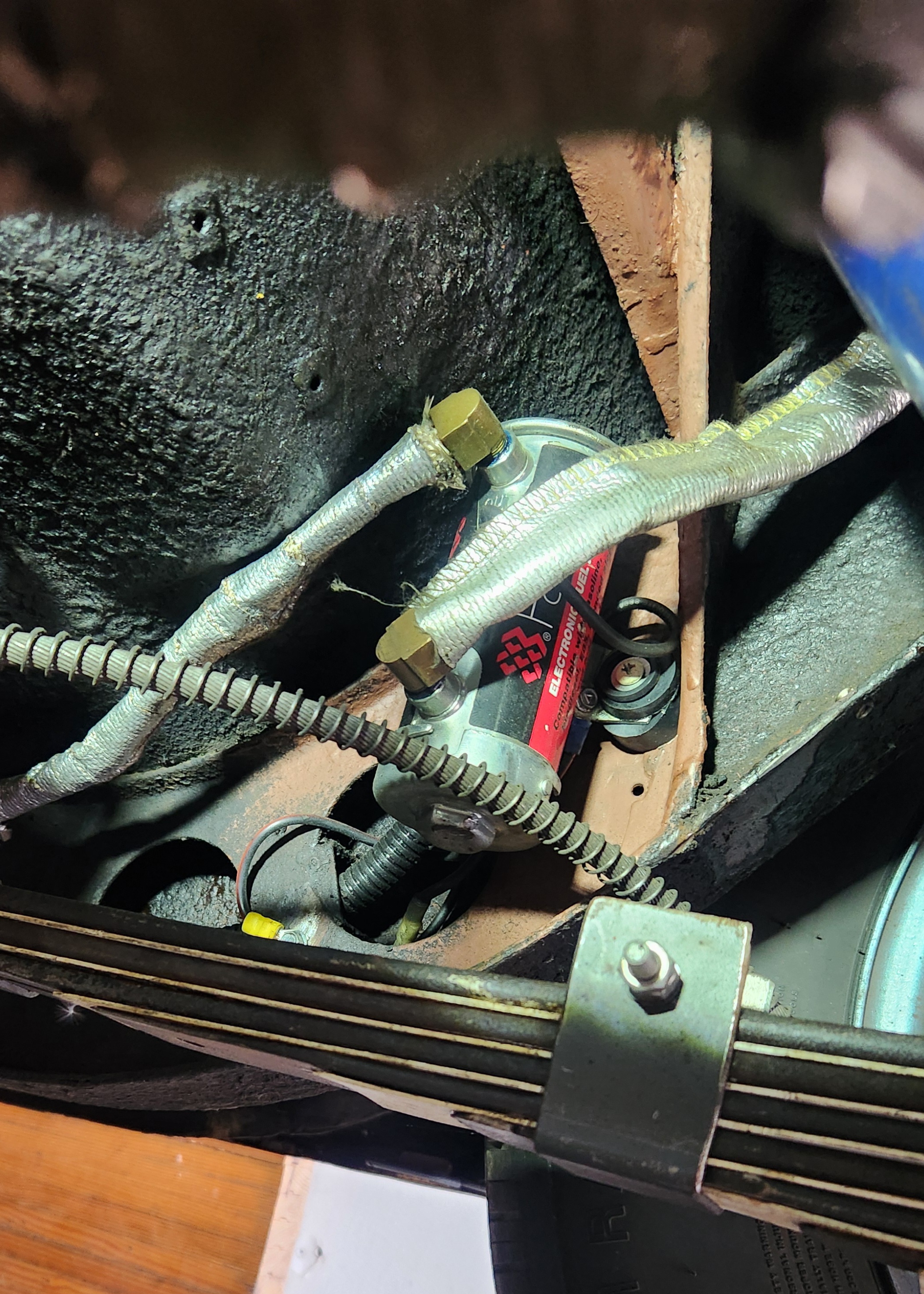

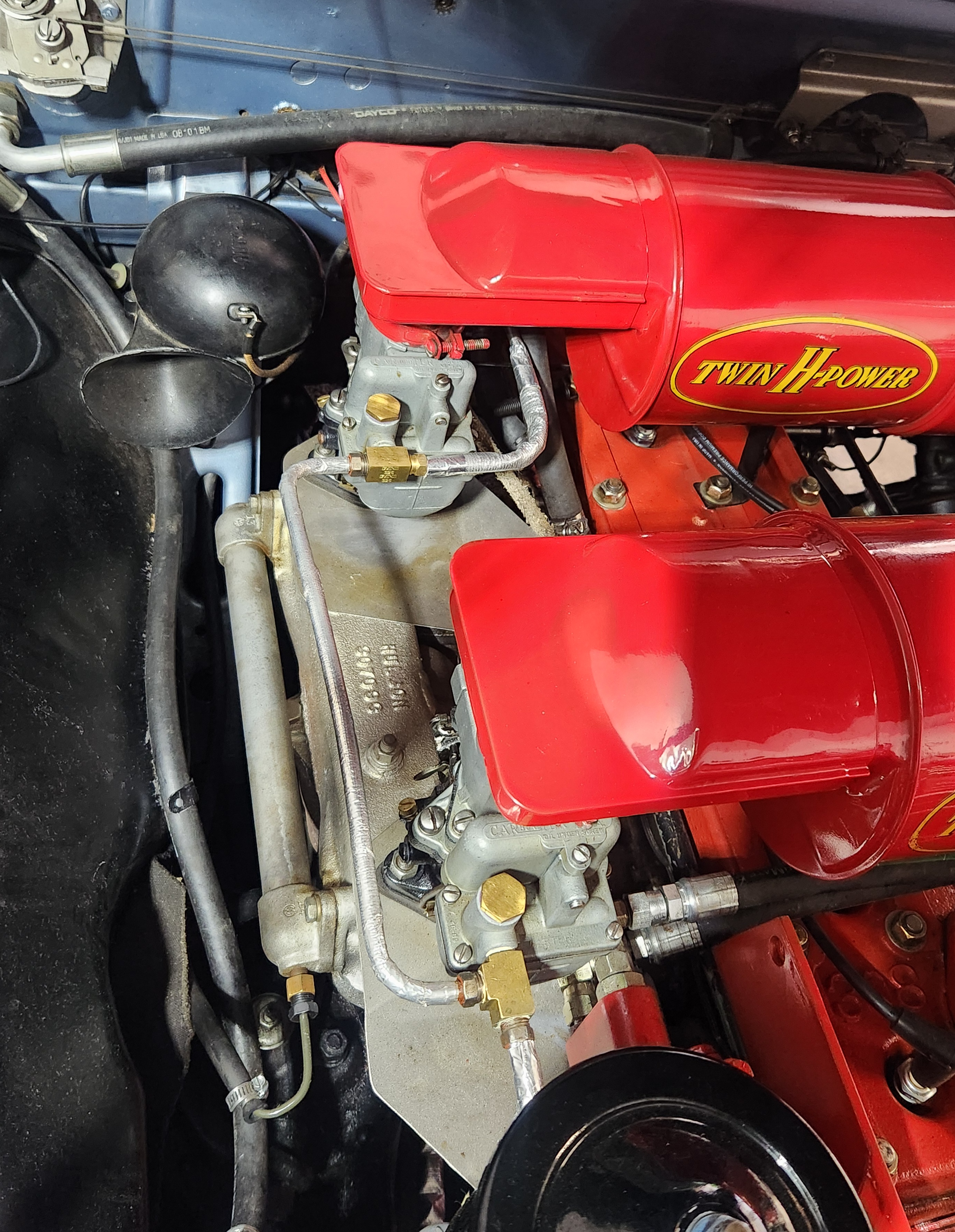

I put an electric pump on my 54 Hornet Twin H 308. I set up a feed thru type system that goes to a bypass regulator and returns to tank.
For the pump I used a fuel Facet Gold Flo cylindrical pump (6-8 psi , 32 GPH) , the regulator is Holley 12-887 set to its lowest setting of 4.5 psi.
I have ran it up to 6 psi for a few days and the needles did not seem to leak, But I now keep it the regulator at it's lowest setting of 4.5 psi.

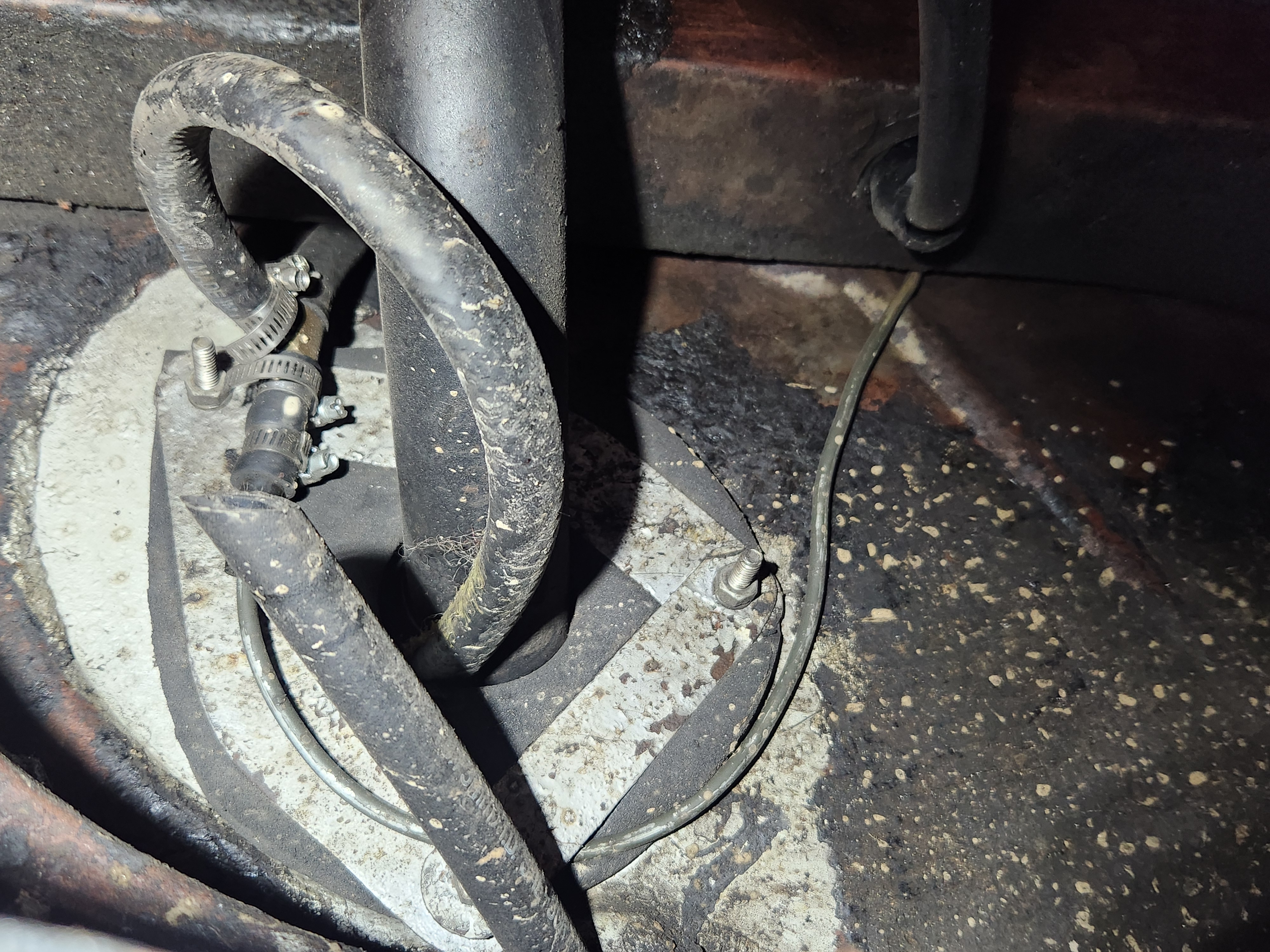

The return is 3/16 brake T'd into the vent hose and hasn't caused any problems.

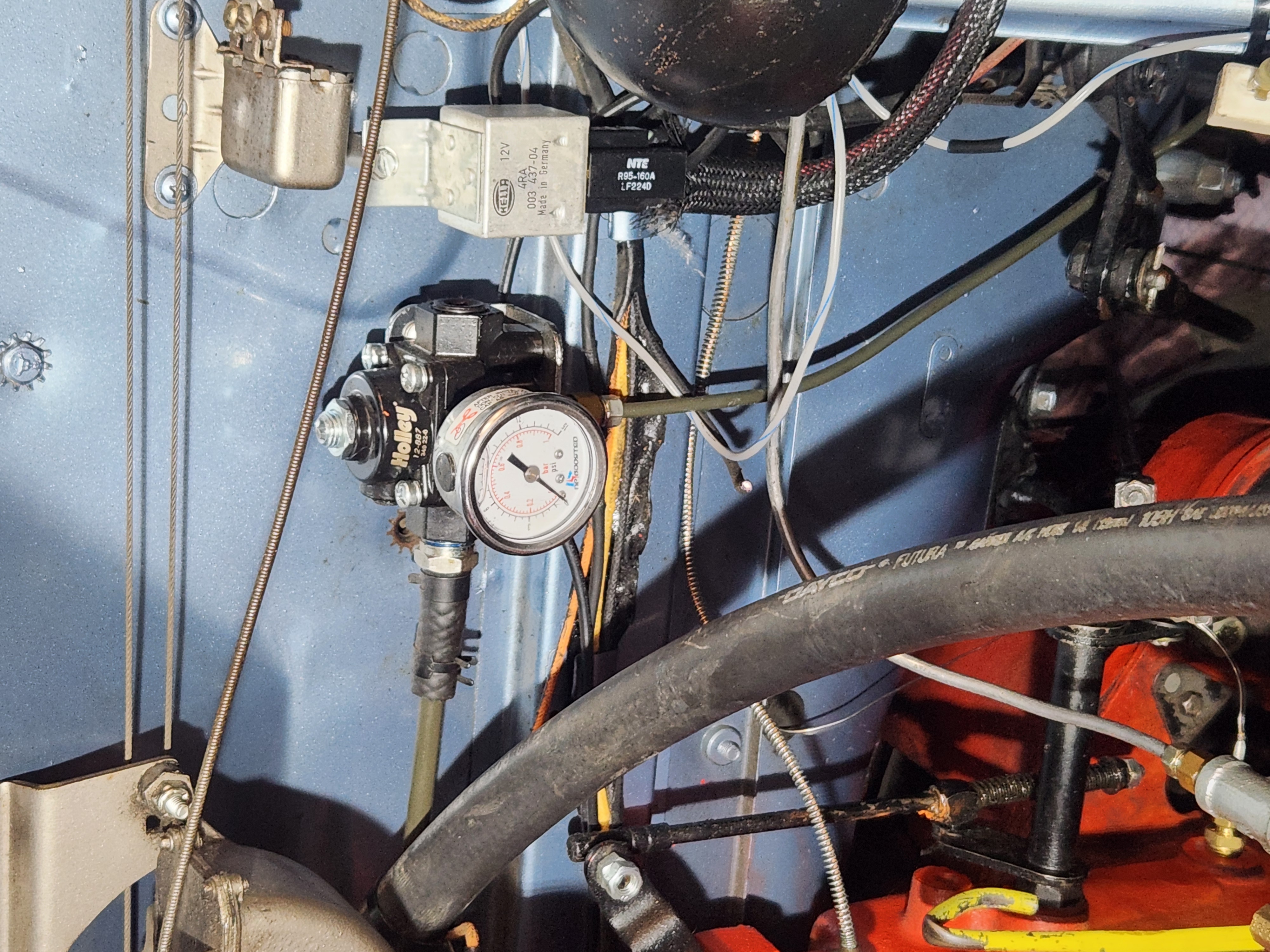

I find it interesting that you have your gas line coming in from the driver's side of the car. I never thought about that since the old gas line on both my Hudsons went up the passenger side. When I get a chance and if I can remember how to do so, I will post some pictures of my setup. I finally got it to crank and I think I have the pressure regulated to a safe number, but it's not idling properly. I am going to check the timing to see if that may be the problem.
That's the return side. The supply line is on the passenger side to the front carb like normal.
What throws most people off is the regulator being after the carb. The regulator CAN be after the carb.

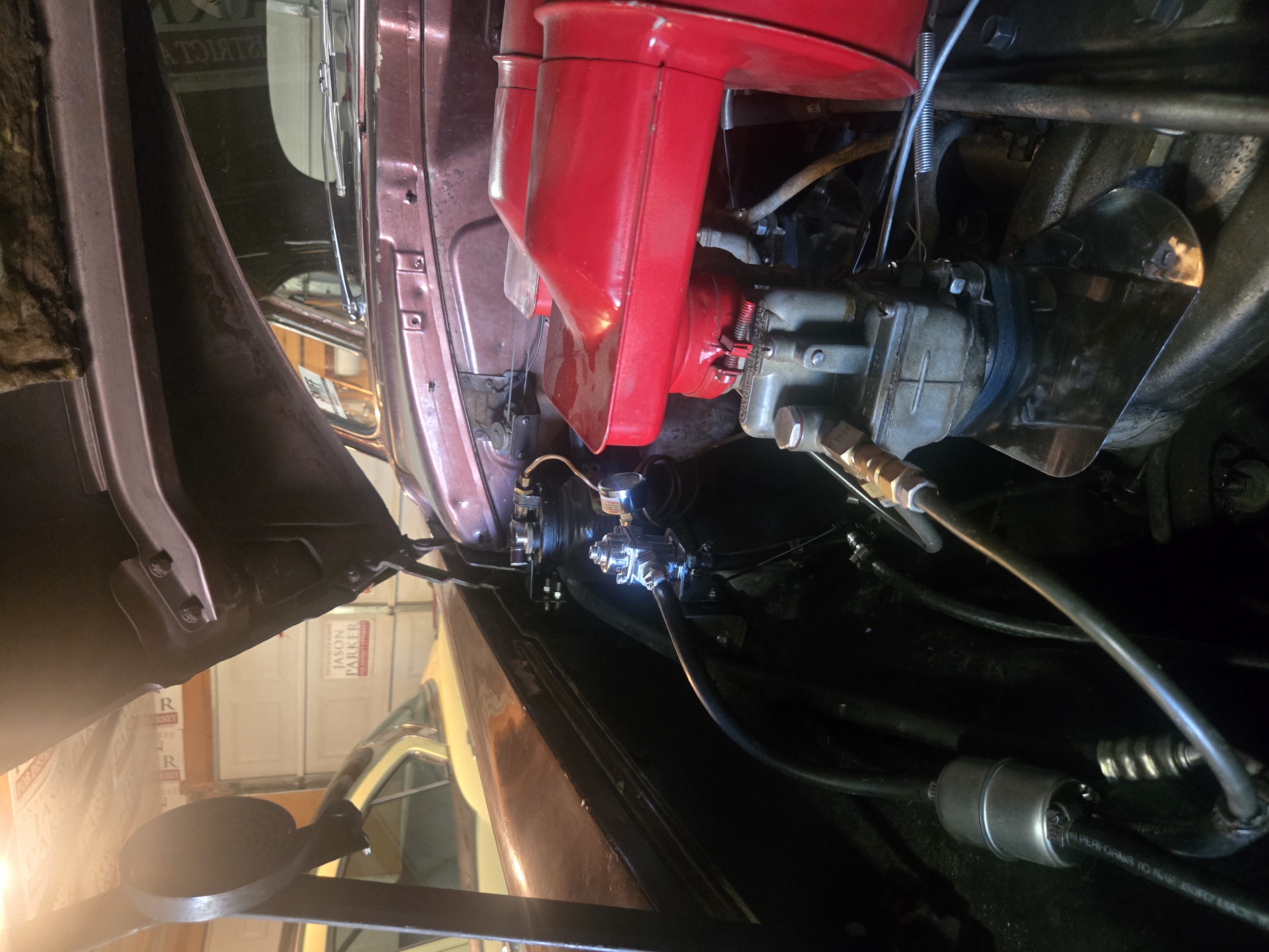

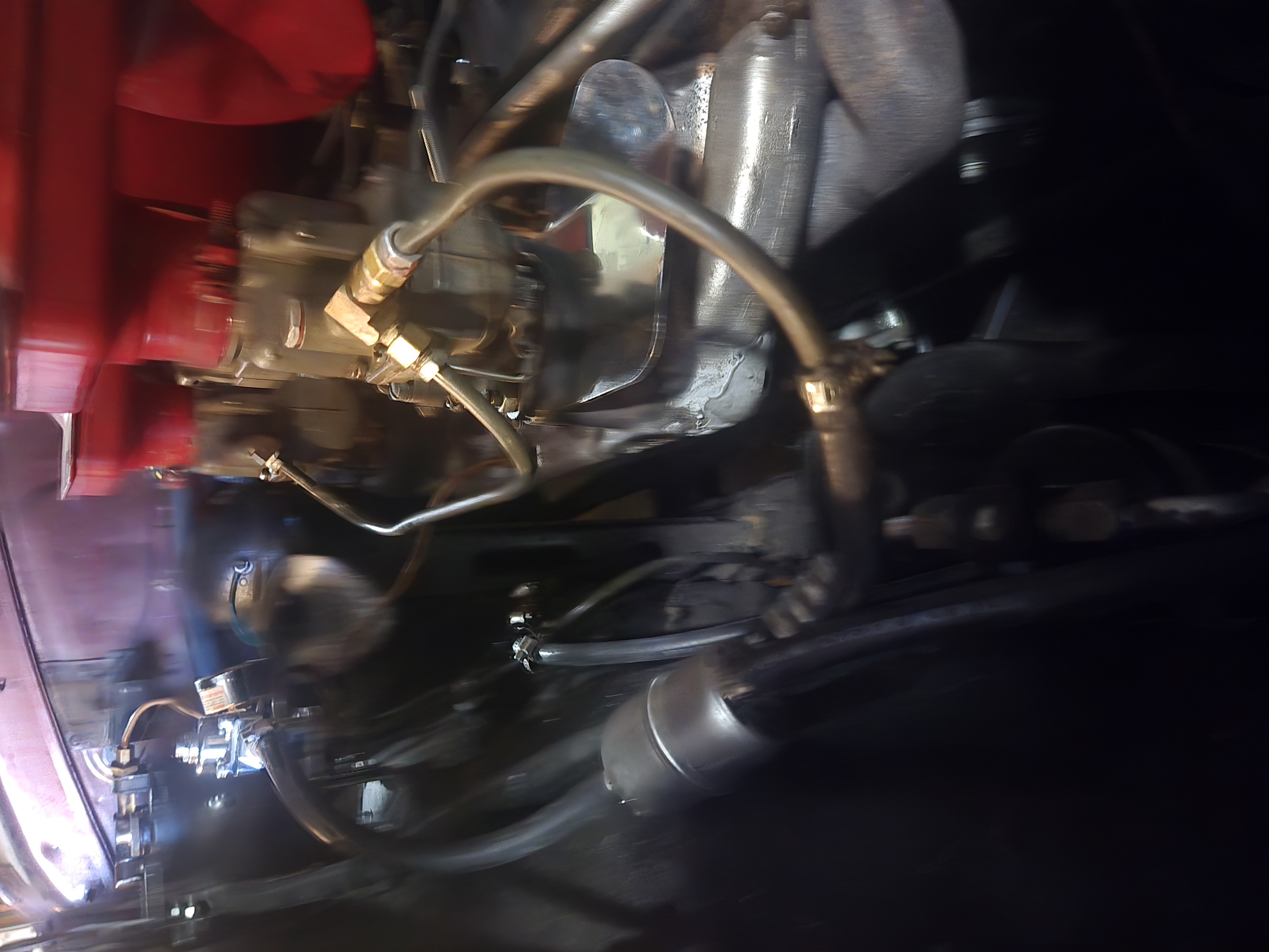

Here are pics of my fuel pressure setup.

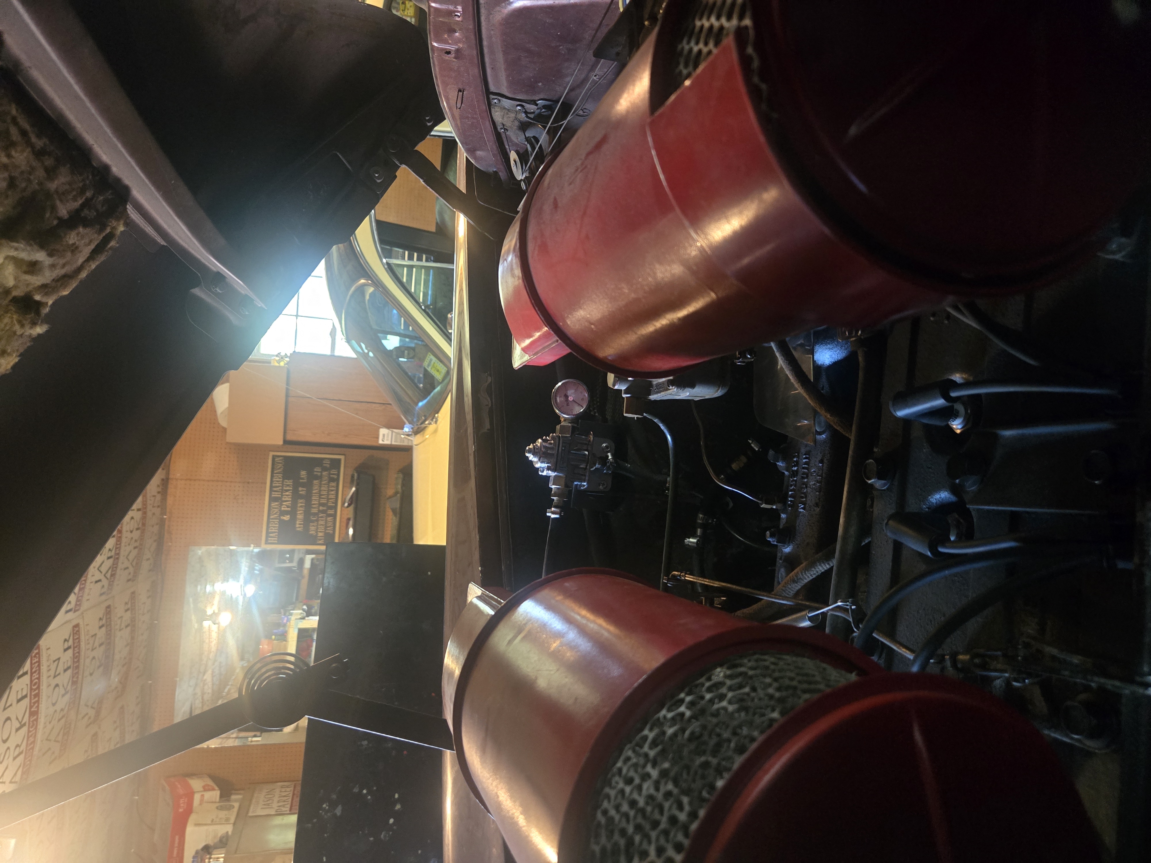

This is what I tried to do earlier.
