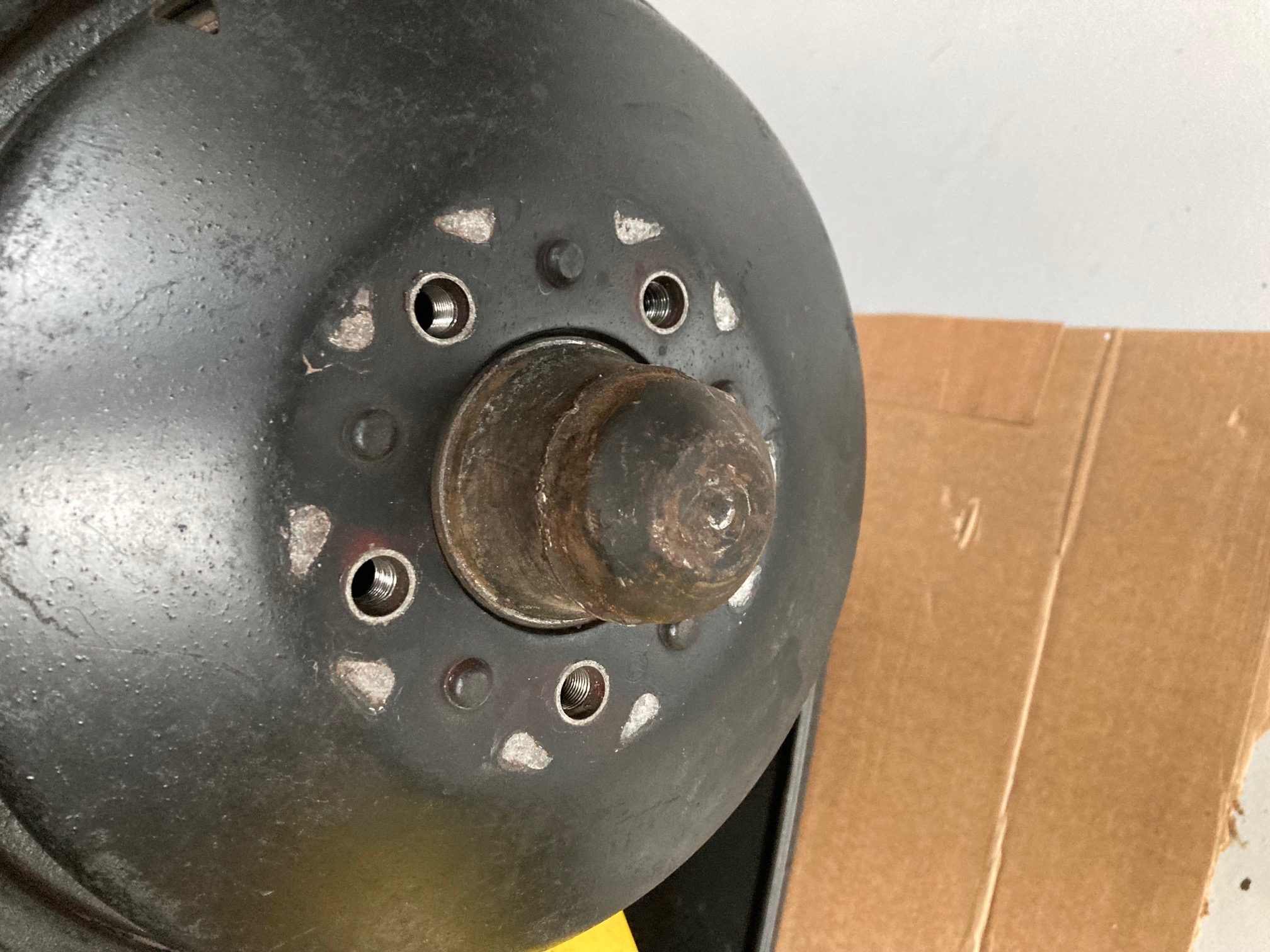

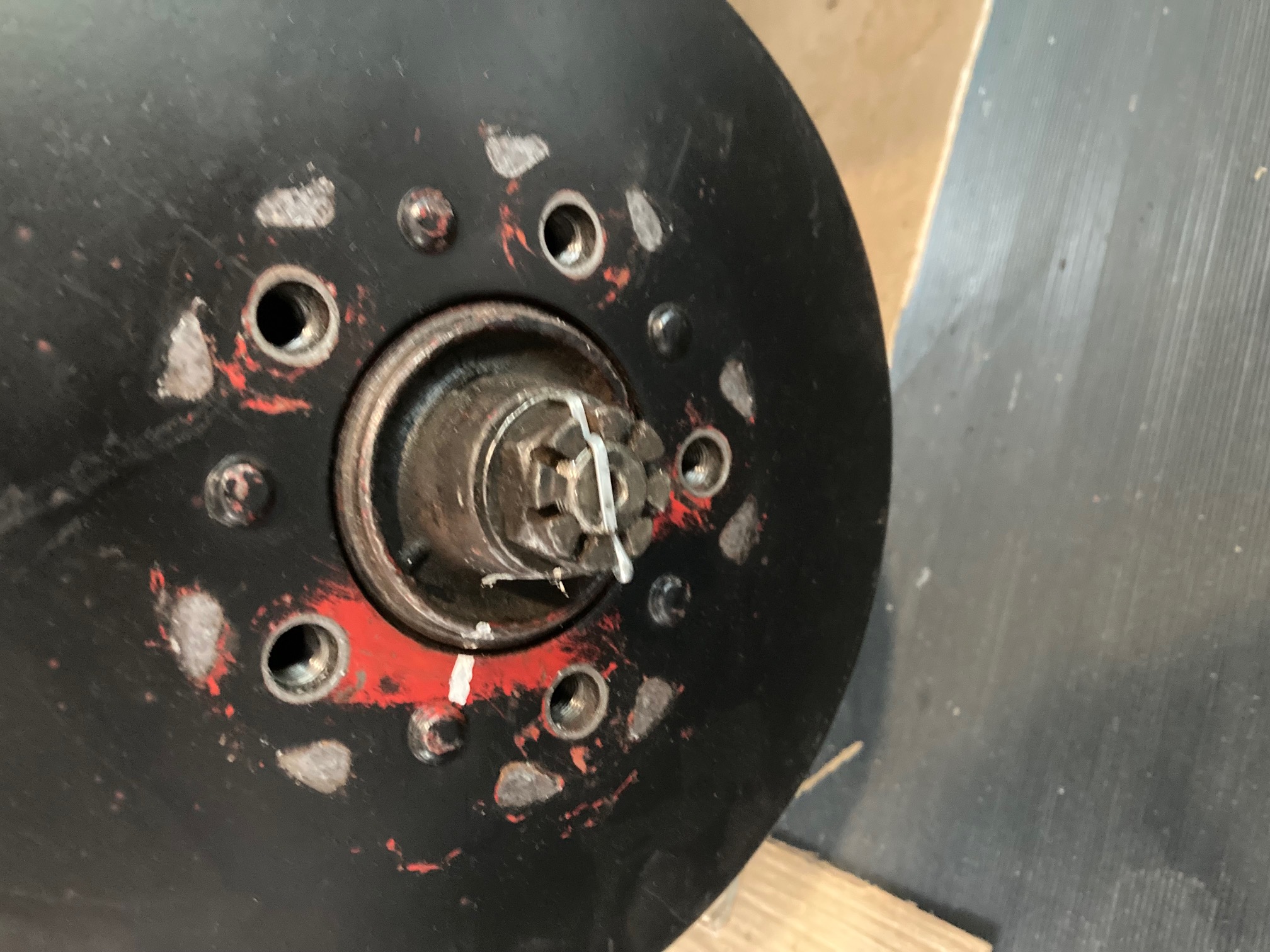

Grease cups for rear axle 1936 Hudson
Think about it - What grease are you trying to keep in?
There are no grease caps on the rear
Thanks

B1-6 is identified as rear axle housing grease hole plug and is 1/8" same thread as grease nipple. 1930 thru 1939 all cars .Common both sides.
Master Chassis Group Parts book 1930-1939
part No BM 120 (2 Reqd)
Ivan L.
It's easy to forget to grease these too.
