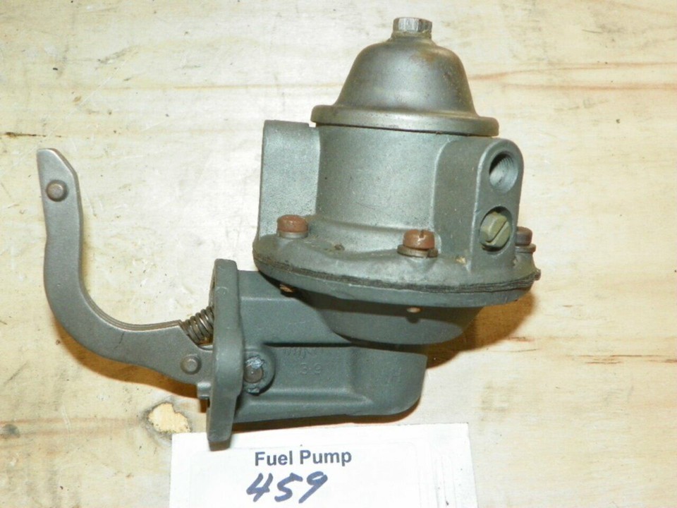

Aha , does the fuel filter look like this?
If so, the smaller 1/4" line is a fuel return line to the gas tank, to help prevent vapor lock. Are you looking to rebuild your mechanical pump? I can rebuild it with a modern ethanol resistant kit (new diaphragm and check valves). If you suspect your old mechanical pump is leaking gas, DON'T run the electric pump through it! It will leak gas into the crankcase and dilute the engine oil, not to mention a possible fire/ explosion hazard.
Is this the type of pump you currently have?
